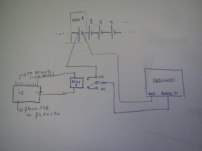

Let's see if I understand this:
Instead of reading all cells at the same time, I would connect every cell briefly to the Arduino by switching 102 relays with a separate IC?
something like this?
@ Greynomad, I don't mind buying a lot of relays (they're cheap enough), but I don't have a LOT of space in the Vectrix. Worries for later though..

If I've got this correctly you will have to switch both the analogue input and the GND. Note how your drawing has GND going to one battery, what happens for the others? So you need double-pole relays.
Also the Arduino has to be powered from a power supply that is isolated from these batteries.
Another thing to think of is when do you read these voltages. If you are going to compare readings against each other or indeed any other data you have to have a known and constant load. Meaning that I think you can't really take a reading while driving as the load will vary a lot I would think.

Post by: CrossRoads on Jul 24, 2011, 12:46 am
This is the system I was discussing.
The MAX6921 might be used, or the other demux chips discussed above.
Note how each battery is connected to nothing until a relay is closed.
A change is needed in the the Gnd for the battery WOULD NOT the GND for the Arduino, demux, & relay coils.
The two would be isolated so that the measuring electronics only connect to the battery under measurement +/- terminals.

Crossroads; I understand your scematic, and it makes sense to me.
From what I understand from the rest, I derive that the other chips wouldn't need the relays, because they switch like a transistor (or Mosfet?). correct?
The part I don't understand, is the high voltage issue; I thought, though they are in series, if every cell is connected (with both poles) separately (like measuring them one after another with a voltmeter) the maximum voltage involved should be 1,4 V -or- the voltage of one cell?
Or am I wrong when I assume that? Or missing something?

High voltage: With the relays, yes, each relay would only have its batteries voltage only, thus no high voltage. The arduino and its relay coil controls and relay select logic will have its ground at the -terminal of the battery being measured.
I am not convinced the mux will work. You will need a series of the chips. They will all need a common Ground, which will connect to the arduino ground, for the arduino to be able to control them.  Then once you get past battery 3,  you have a higher voltage on the battery (5.6 on battery 4)  than the arduino can read.
To handle the higher voltages as go you higher up in battery voltage (with respect to the mux ground), you will need higher power supply voltages (and the spec seemed to show you need both a very +supply and a very low -supply:

Post by: turok on Oct 24, 2011, 09:27 am
I've been learning/reading some more, and after rereading this, this is what I think I can make of it:
The MAX6921 could be used just to directly control up to 20 relays that each isolate 1 cell and feedback its voltage to the arduino.
both circuits are completely separated, so no common ground.
The way this circuit is drawn, it seems like there wouldn't even need to be transistors or resistances around the MAX chip to control the relays, is that right?
are the outputs of the MAX chips (I think 40ma) enough to close a relay?
grtz
T
Title: Re: my first big project - BMS - is it possible?
Post by: graynomad on Oct 24, 2011, 09:33 am
40mA is plenty for a small relay, but that circuit does not isolate the batteries from what I can see.
EDIT: I take that back, it does I think, but you have to change the GND for the relays and the MAX chip to be the same as the AVR.
ANOTHER EDIT: You have to be 110% certain you don't activate two relays at the same time. Do you plan to use software at any time in this project  :smiley-eek:

next relay and so on
compare voltages
report somehow

Post by: graynomad on Oct 24, 2011, 09:58 am
Quote
it seems pretty straightforward to me;
Yes it is, just be mindful of the consequences if for whatever reason you open one relay before closing the another.
For example how will you know that relay 1 has actually closed before you open relay 2?
What if there's a mechanical failure in relay 1 and it sticks open, if you then open relay 2 it's goodnight nurse to half your circuit and with the resultant fire maybe the vehicle as well.
Do you trust your coding ability to that extent?
If you use a 4514 decoder chip it's not possible to have > 1 output active at a time which at least takes your code out of the equation, not mechanical failure though.
______

Post by: turok on Oct 24, 2011, 10:56 am
Thanks for the advice.
I understand the concern, and it s certainly something Ill remember.
I could incorporate a check if voltage ==0 after opening the last and before closing the next relay.
For security reasons, i plan to test the system on a much smaller 20 cell nimh pack.
I have no idea what the 4514 decoder chip is/can do, but Ill look in to it.

Post by: turok on Oct 24, 2011, 12:01 pm
I looked at the datasheet of the 4514 decoder chip  http://media.digikey.com/pdf/Data%20Sheets/Fairchild%20PDFs/CD4514BC_4515BC.pdf (http://media.digikey.com/pdf/Data%20Sheets/Fairchild%20PDFs/CD4514BC_4515BC.pdf)
but it's too technical for me.
is this chip to replace the MAX chip, or what?
can you explain a little?
Post by: graynomad on Oct 24, 2011, 05:02 pm
The chip will be a lot easier to use than the MAX chip and basically fool proof WRT only having a single output active.
You tie the  latch pin to 5v and apply four signals to the A, B, C, and D inputs. The binary pattern applied to this inputs determines the active output.
Couldn't be simpler, and 0 chance of two outputs being active at the same time.

Post by: turok on Oct 24, 2011, 06:58 pm
ok, lets see if I got this right;
This chip turns 4 arduino outputs into 16 outputs on the chip, by combining different high/low inputs on the chip (4X4 combo's=16), right?
are these outputs strong enough to open/close small relays without an additional power source? I looked at the datasheet again, but there are just too many damn numbers :)
Post by: graynomad on Oct 25, 2011, 12:38 am
Quote
Unfortunately no, there may be a version that does but the best thing would be to use a driver chip like the 2803.
Quote
Correct, but the equation is 2^4 = 16 (2 to the power of 4).
