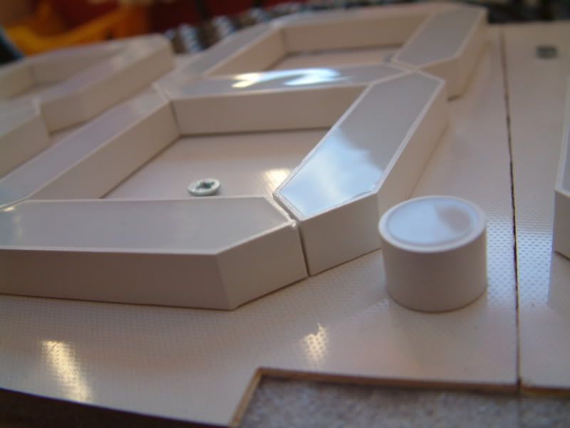

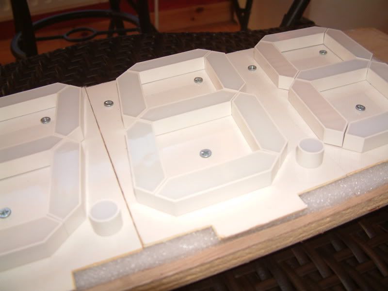

[size=16][font=Arial]Project idea is to eventually build a large 6" x 6 digit LED display for motor racing[/font][/size] controlled initially by a hand button and in the future I want it to be triggered by a remote signal as the bike/car passes.

Powering the displays:
1. I agree with the motorcycle battery idea. Those lead acid ones are cheap and narrow enough to fit in the unit although if I could get lithium batteries to do the same that would be allot better as the lead acid ones are really heavy and they are approx 2.5 inch depth which may make the whole unit 3 inches.  :-/
2. I am ordering the tpic6b595 chips in the next couple of days. Are they very similar to wire up?
3. I was wondering how to connect the 12 volts. You said about a step-down regulator for the 5V?? I thought the 12 was connected to the Arduino and then I suppose transistors or something go between the outage to the digits?? As you can see I'm not up to speed on the voltage/amp's set up. Any help in this department for connecting and regulating the power would be very much appreciated.
4. I thought about having the digits flash upon power up just to let the user know all is well and all digit's/segments are working. I repeated the shift-out quite a few times in the Void Setup to make it blink.. is this the best way?
Example below but not all;
