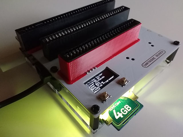

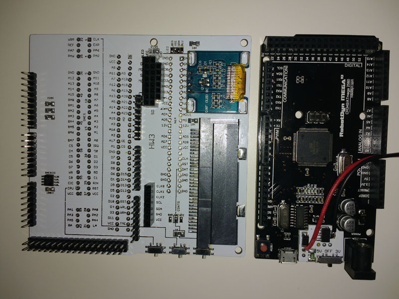

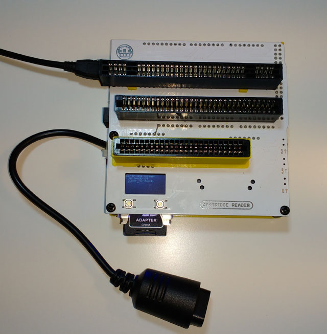

Here is my current version of MichlK's code, it's a shield for an Arduino Mega.
The rom gets saved to an SD card. You can also read/write save files to the SRAM, display information about the cartridge on the LCD or calculate the checksum of your rom dump.
You control it using the push button on the left. One click moves the selection down, a double click moves it up and a long press executes the current menu option.
I used this Prototype PCB from ebay item # 201205316404 (you need to cut a trace on the top of the pcb leading from the switch to the reset pin)
That SD module from ebay item # 290901349431
And a white 0.96" IIC I2C 128X64 OLED LCD from ebay item # 291216700457
I also incorporated the DigitalIOPerformance lib now and dumping an 1MByte (8Mbit) LoRom game takes 62 seconds while dumping a 4Mbyte (32Mbit) HiRom game takes 4 minutes and 10 seconds.

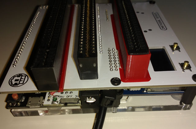

Adafruit Clock Generator added to the sanni board.

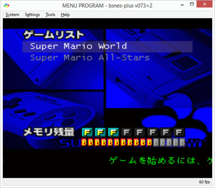

I've made progress on a different cart.  I managed to get the games off the Nintendo Power (SF Memory Cassette) cart in multi-game configuration.  It requires some fiddling with the MX15001TFC registers 0x2400 and 0x2401.
In single game configuration (with or without the Menu), the reader should be able to see the game data in banks 00-7F in LoROM (0x8000-0xFFFF).  After dumping the Menu, the game data will be at 0x80000 in the dump.  If you set the registers to switch to the game, then the data changes and the cart actually becomes the individual game and the normal cart dumping process will work.
I have a multi-game (3-in-1) cart and the games are not visible to the reader.  Only the Menu is visible and it repeats 8x (in banks 00-7F).  I searched all of the banks and there is no game data to be found.  The MX15001TFC hides the actual game data.  Accessing the game data requires setting registers 2400 and 2401, the data changes for each game so it requires multiple steps to dump all of the games.
Right now I can dump individual game data with the settings hardcoded but it will take some time to code it so that the reader can dynamically dump the games.  I have to wrap my head around coding all of this because of the number of steps involved. We need to access the Menu, read the game entries, set the correct registers, dump the individual game data, then reset the cart to repeat the process to dump the next game.
I have to experiment more with switching between games.  Registers 2400 and 2401 remain active even when acting as a single game so I'm hoping it is possible to switch between the games with a reset instead going back to the Menu.

Post by: sanni on Aug 16, 2015, 01:26 am
I've made a pcb for it, since I didn't want to rewire my old build for adding the full lenght slot. It should arrive in 2 weeks time. Well worth the saved time compared to wiring everything per hand.
If you have a closer look you will notice that I changed all the pins around. This is so that the address and data lines are grouped together on one port which will in theory give an insane speed boost since you can just do:

Hi sanni,
Nice PCB.  I might need one!  I recently pulled a cart connector from a broken Retron 3 and it has the proper pin spacing.
One thing on the clock generator location, the USB connector on the Arduino is close to the pins for the clock generator on my current adapter.  I put a layer of kapton tape over the USB connector to prevent a short (just in case).  I also have some plastic spacers sandwiched in between the adapter and Arduino but it might be really close if you fully seat the adapter onto the Arduino.
Thanks!
Title: Re: ROM-Reader for Super Nintendo / Super Famicom Game Cartridges
Post by: sanni on Aug 16, 2015, 03:08 am
I'll send you one, no problem.  :)
I tried to stay away from the USB socket but it still might conflict with the 6pin ISP header depending on the used Arduino board, but nothing a little tape or desoldering iron couldn't fix.
The manufacturer already emailed me an image of the order, I like the color.
As you can see I used the remaining board space for a little break-out board, just plug it into the cart slot and you got access to all the important pins to mess around with, e.g. when you want to use the arduino to program a 29F032 flashrom.
I just hope I didn't mess up and the board actually works  :smiley-roll-sweat:

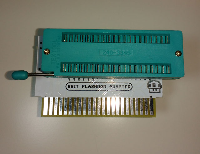

In other news, I added a MX29L3211 flashrom programmer to my previous post. Now you can program all interesting(in terms of SNES) flashroms with the Arduino. :)

Someone asked about reading and writing SRAM for the Nintendo Power carts.
As I mentioned previously, reading the savegame out of SRAM is possible once a cart is switched out of the menu into game mode.  I've dumped all of the savegames off of my NP carts.
I finally ran some tests writing savegames to SRAM.  Using an NP cart with Super Mario World, I was able to write a new 96* savegame to the SRAM.  After testing the 96* savegame, I then wrote back the original savegame.  Everything works without a problem.
Once the NP cart switches from menu to the selected game, then the cart essentially becomes that game.  The read/write code for ROM and SRAM should work.
I'm still trying to improve the reliability of the menu to game mode switching.  I'll be doing more testing until I figure it out.
Good Luck!

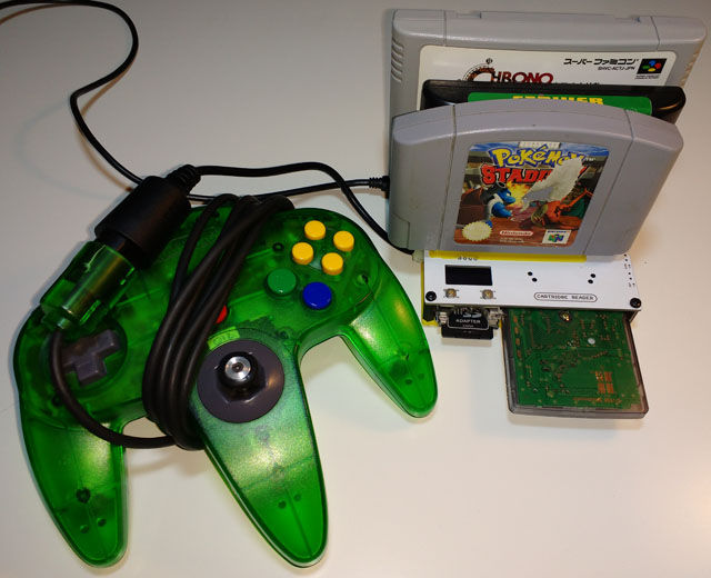

Post by: sanni on Mar 11, 2016, 07:36 pm
I ported my Nintendo Cart Reader sketch from using the standard Arduino digitalread/write functions to using direct port manipulation. Everything is now faster than before, especially writing the 29F032 flashrom did benefit since now it's twice as fast as before.
I also added a little content viewer for the N64 Controller Pak so that before you dump it you see what games are actually on it:

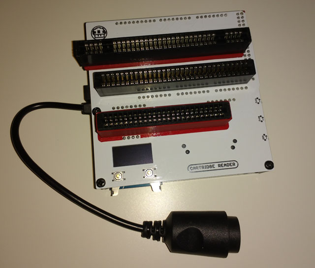

Post by: sanni on Mar 19, 2016, 06:51 pm

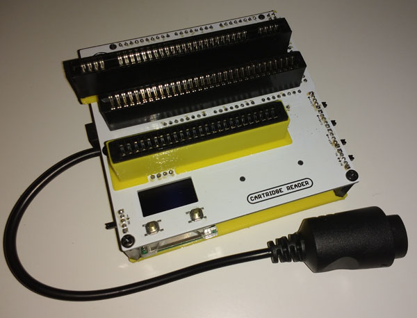

Some impressions:

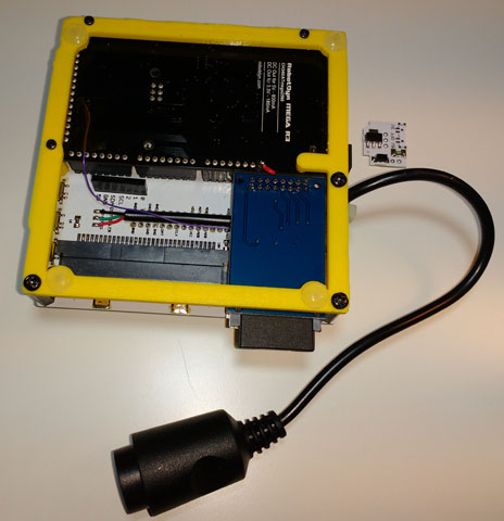

Post by: dtp35 on Mar 21, 2016, 01:54 pm
Hello All,
I'm in the process as making one for myself. I love the idea of downloading and uploading save games from SNES carts!
I found the OLED screen on ebay. But i can't find a SD card with the pins facing down. Only pins facing up. Do you have a ebay number with one? OR did you remove the pins and make them face down?
In the pictures there is a small pcb on the back. What is it? and what does it do? I presume i only need the LCD and SD card.

Post by: zzattack on Mar 21, 2016, 02:07 pm
Yep, I desoldered the SD card header and put it back on the other side. I think on the OLED two pins were also swapped. No biggie.
Post by: sanni on Mar 21, 2016, 05:08 pm
On the currenct version of the shield you can select the Oled screens polarity with two solder jumpers
Here are the parts I recommend:
Arduino Mega 2560: aliexpress.com/item/Mega-2560-CH340G-ATmega2560-16AU-Compatible-for-Arduino-Mega-2560/32517341214.html
Oled screen: ebay.com/itm/351493706885
SD module: ebay.com/itm/291551876341
You need to desolder the pins from the sd module and resolder them to the other side. Just apply so much solder that all pins are covered at the same time together in one big blob and then heat the blob until the pins fall out.
The small pcb on the back is a clock generator, you need that only for SA-1 games afaik. Personally I had no luck with the newer SA-1 pcbs anyway so I wouldn't buy it unless you want to tinker with the SA-1 games. For NP carts the Arduino can generate the clock signal by itself so the clock generator is not needed there also.

Here you can buy N64 cart slots for cheap: https://www.reichelt.de/Slotstecker-Steckkartenverbinder/STECKER-50-254/3/index.html?ACTION=3&GROUPID=5218&ARTICLE=19472&OFFSET=1000&
The don't have the Nintendo own 2.5mm spacing but instead the industry standard of 2.54mm but the two outer pins on the N64 cartridge are either additional GND or unconnected so it doesn't matter if the last pin doesn't line up and the slots still work perfectly.
Direct comparison between 2.5mm slots by SuperUfo from Aliexpress and 2.54mm slots by reichelt.de, close enough.
And as a further alternative here are the slots skaman found on ebay, they also work great: http://www.ebay.com/itm/5pc-Industrial-Card-Edge-Slot-Socket-Connector-25x2P-50P-2-54mm-0-1-3A-RoHS-/140888533934

 I'm investing my little free time in other projects, I have to make to my family a few electronic assemblies with pic microcontrollers.
 But I also had time to assemble this circuit (look at the attached pictures) surely you know it very well, it works perfectly. It is wonderful.
 By the way I would like to that with this circuit could be used an oled screen instead of using the monitor series of arduino, this is possible?

Post by: sanni on Apr 07, 2016, 01:56 pm
Not with the Arudino Uno since it has not enough space for my filebrowser code but with the Arduino Mega it works.

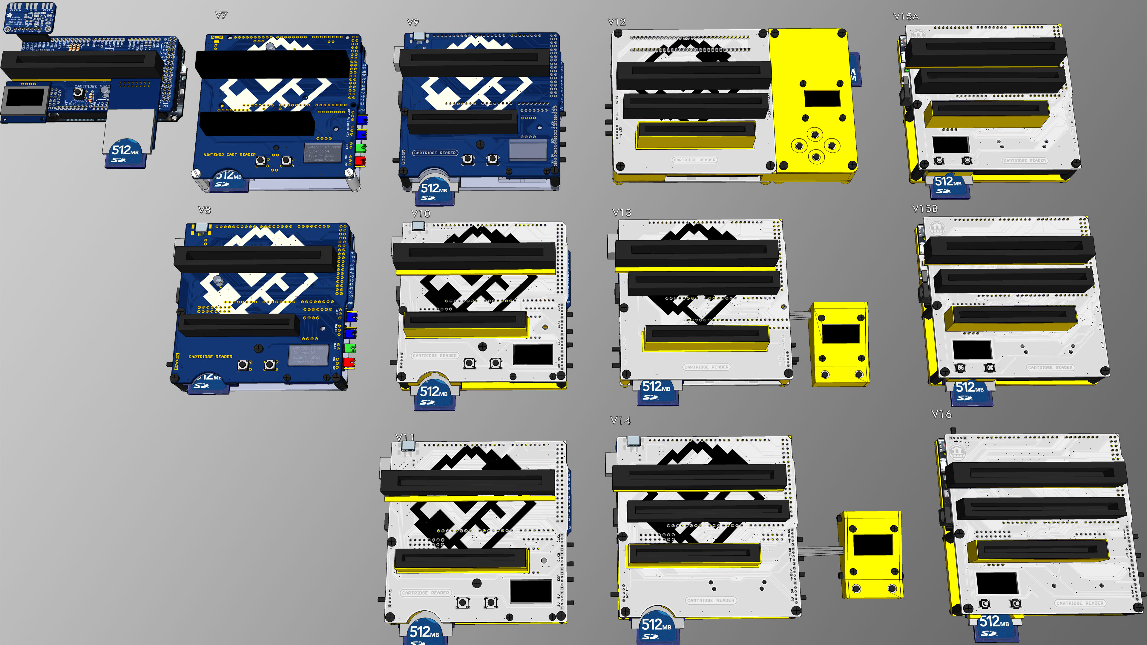

In other news:
I've been playing around with a new pcb design that integrates the N64 adapter into the main pcb.
Makes everything look a little bit nicer. Featurewise it's the same as before and also uses the same parts.
It does need a bottom plate though since the N64 part of the pcb overhangs the Arduino quite a bit.

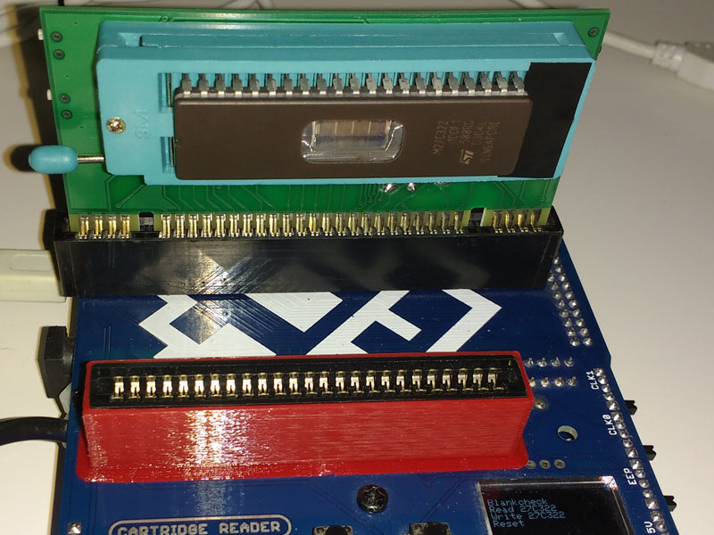

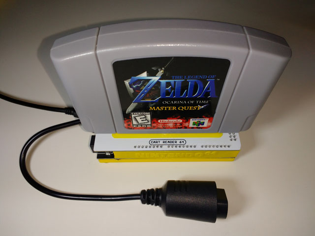

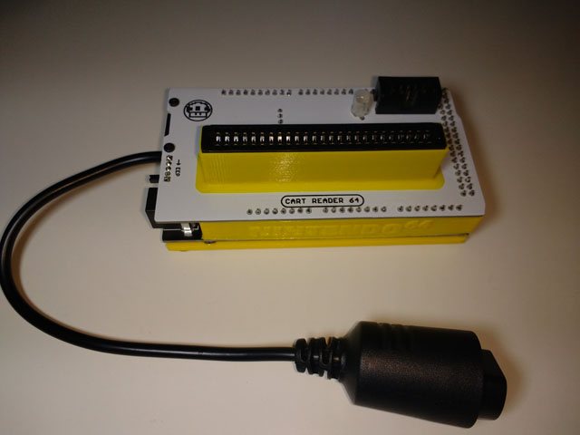

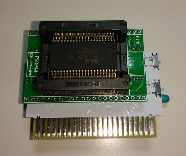

Post by: sanni on Jul 26, 2016, 09:54 am
Some more images of the current version:
N64:
SNES:
29F033:
29L3211:

Post by: erendorn on Aug 08, 2016, 08:43 pm
N64:
SNES:
29F033:
29L3211:
Wow, this looks stunning. How much work and pieces are needed to get to such a result?

1-It is possible to implement the functions "NP game menu items" original starting NP.ino for extra NP.ino module?
2-It is possible to recreate the original menu SF Cartridge?
3-How to add more than one rom using mapping or other method?
Post by: sanni on Aug 10, 2016, 05:30 pm
1. The clock generated by the Arduino is not reliable enough to successfully change the mapping multiple times in a row. You need the Adafruit Clock Generator for that or improvee my clock code.
As an alternative I have written a desktop program that splits the 4MB raw NP dump into the different games, maybe try that (https://github.com/sanni/cartreader/tree/master/extras/npsplit).
2. Yes, but it's complicated. You find all the info here (http://problemkaputt.de/fullsnes.htm#snescartnintendopowerflashcard) if you want to dive deeper. I have not done it myself yet, so I can't really help you.
3. By adding a menu, see 2.

(http://www.mediafire.com/view/z6dix3sxsti2o22/smw_smas.png)
Someone asked about the game entry text.  This is what my English SMW+SMAS Menu ROM looks like in the game selection screen.  The text is in a 192x12 Monochrome 1bpp BMP that is converted to the format that the Menu uses.  In case anyone cares, the font that I used is Lucida Console size 9.
Game entries begin at 0x62000 in the Menu ROM.  Additional game entries are at +0x2000 (0x64000, 0x66000, and so on).  Offset to the start of the BMP data is 0x3F.  So the converted BMP data for the first game begins at 0x6203F (+0x2000 for each successive game).
If anyone wants to test the English SMW+SMAS on their NP cart, then you can download it here:  http://www.mediafire.com/download/lp9mvlw7r15ypvb/smw_smas.zip
Edit:  http://www.mediafire.com/download/2222b5e4h07d4es/smw+smas-REVISED.zip (http://www.mediafire.com/download/2222b5e4h07d4es/smw+smas-REVISED.zip)

Some Sketchup render of the next version:

Just received the new revision:
- removed the ~60 protection resistors as it was just too much to solder
- replaced all jumpers with switches
- new N64 slot that has the correct spacing but is not overly tight like the other ones
- the sd spacer now is a total of 8mm thick so you can use a standard 2x8 female pinheader to mount the sd module in a removable fashion and also to press the sd module against the backplate so that it doesn't move anymore
- proper cutout in the sd spacer for the LED and solder pads located directly in front of it
Overall the needed build time was probably cut in half or something like that.
I uploaded the building instructions here. (https://github.com/sanni/cartreader/blob/master/pcb/building_instructions.pdf)
Now I just have to wait for the adapter pcbs to arrive and then I can test everything and see if it still works  ;)

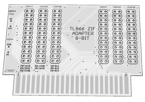

Yesterday I received the new adapter pcbs, this time I have decided to go with a white solder mask.

Tried out a 3d printed backplate:

Just received the newest version, no actual hardware changes just some different design choices to bring it into the year 2017  8)
Post by: skaman on Mar 05, 2017, 06:13 am
Those are beautiful!

Post by: sanni on Mar 29, 2017, 04:50 pm
Over the past few days I've updated the github repo (https://github.com/sanni/cartreader) and the wiki guides (https://github.com/sanni/cartreader/wiki) to represent the latest version.

The Retrode is 16x8x4cm=512cm³ and my current cart reader design is 10x10x4cm=400cm³.
Therefore I'd argue it already is smaller by volume. :smiley-small:  :D
Ofc the Retrode can do a lot more things like you can plug SNES controllers in it, so it needs to be bigger :smiley-cool:
Now if the question is "What is the cheapest way possible to build this Cart Reader?", then the answer to that would be the following item list:

By the way, I just ordered Nintendo dumper PCB and Adapter board to Elecrow.
I ordered adapter using old adapter.zip file instead of latest small GB adapter only version.
Is it better if I order another one using latest Gerber file?
Post by: sanni on May 23, 2017, 05:31 pm
The only difference between the two GBA adapter versions is that the new version has holes for mounting the 3d printed case with screws and it also has a longer cart edge connector. Electronically they are the same and both versions work fine. So no need to order the new version.
Post by: tamanegi_taro on May 23, 2017, 05:52 pm
OK! I don't have 3D printer so it doesn't mind then.

Post by: sanni on May 28, 2017, 04:27 pm
Here are some updated pictures of everything the cart reader can right now:
Read N64 roms out of their cartridge. Read and write save games from and to the cartridge.
Test the buttons and give the exact values of the thumbstick of a N64 controller.
Read and write Controller Paks.
Re-write those $22 chinese N64 reproduction cartridges.
Read SNES roms out of their cartridge. Read and write save games from and to the cartridge.
Write flashroms for making custom SNES reproduction carts.
Read and write Nintendo Power SF Memory cartridges.
Read Game Boy (Color) roms out of their cartridge. Read and write save games from and to the cartridge.
Write custom made Game Boy flashcartridges.
Read Game Boy Advance roms out of their cartridge. Read and write save games from and to the cartridge.
Post by: sanni on Jul 08, 2017, 02:53 pm
Trying out some new color combination :D
I like it!!!
Post by: tamanegi_taro on Jul 13, 2017, 05:23 pm
I like it too.
Mine is black PCB too.
Post by: sanni on Jul 24, 2017, 05:23 pm
White and yellow :D

Could you post some high res pics of your assembled board? Specifically, I'm wondering how you mounted the 22uF cap.
I've soldered mine with the positive going to +5v, however when I plug the board in, the cap overheats and makes smoke.
edit: good catch! I confused the pinout of the regulator.

I'm studying about eprom and eeprom. I saw your project and wanted to know if it's possible to write in eeprom using arduino mega. I saw your project how you can write how to read. As I'm starting in the programming part, I wanted something that related only to writing in eeprom (29L3211).
Post by: sanni on Oct 06, 2017, 09:40 am
Yes that will work. Just wire up a PSOP44 socket like this (https://www.aliexpress.com/item/Free-Shipping-SOP44-to-DIP44-PSOP44-DIP44-SOP44-SOIC44-SA638-B006-IC-IC-socket-Programmer-adapter/32536088590.html?) to an Arduino Mega according to the pinout.xls found on my github (https://github.com/sanni/cartreader/blob/master/pinout.xls). Connect the pins from the Arduino column to the 16bit flash column.
You'll also need an SD module to provide the file you want to flash.
Since the 29L3211 is a 3.3V part you need to convert your Arduino to 3.3V either by following one of the tutorials for converting the serial port to 3.3V found online (https://learn.adafruit.com/arduino-tips-tricks-and-techniques/3-3v-conversion) or by using a 3.3V voltage regulator like an AMS1117 and connecting its output to the 5V line of the Arduino Mega. In the latter case you can't connect the USB cable anymore or you'll short the Arduino out and therefore you also need to install the OLED display and the buttons to control the program independent from a PC.

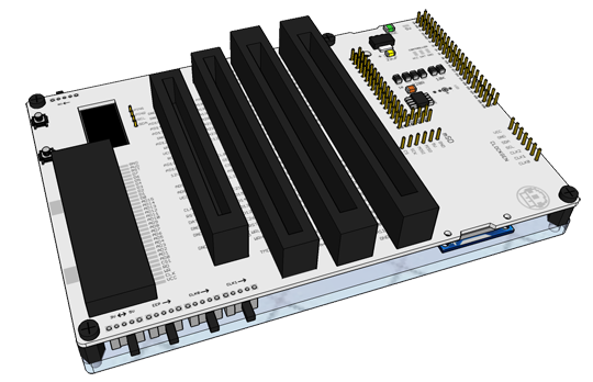

New design prototype: [see post #356]

Here are my current design protoypes.
Low-cost single system versions of the cart reader
They share an optional external control unit with oled/buttons but also can be controller via the Serial Monitor from your PC or mobile phone.
N64:
Mega Drive/Genesis:
GB/A:
SNES:

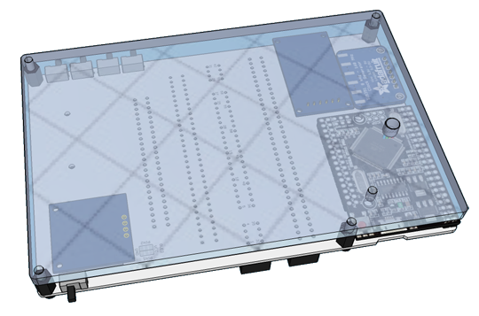

In other news, I have done some further work on the new All-in-one board:
In this version the USB port at the back will also vanish and instead a little pcb will be used to convert the Arduino to 3.3V if needed following the tutorial by Adafruit (https://learn.adafruit.com/arduino-tips-tricks-and-techniques/3-3v-conversion​).
Post by: theodor613 on Oct 25, 2017, 02:21 pm
Looks like you raised the mega by adding some support legs. Wouldn't this put the SNES/Nintendo pin legs closer to the Arduino possibly making a short?

Hi everyone!
I got a mega, and soldered together a shield with a zif socket, and a diy sd adapter. So far so good.
However, I am unable to flash my 29F033.
"Flash ID: 4078
Flashrom Writer 8bit
Flash ID: 408B
Unknown flashrom"
This is what the serial monitor shows.
Also, is there any way to dump the contents of a flash rom?
Thanks in advance!
Post by: sanni on Oct 27, 2017, 06:40 pm
Either it's a wiring error or there are 29F033 with an ID of 0x4078, but since google did not show any results for 0x4078 I guess it's the first possibility.
Post by: star1 on Oct 27, 2017, 07:00 pm
I suppose that is a possibility... I followed the pin out of the excel sheet, but let us go over it, and I can narrow it down from there.
A0-15 are easy enough
A16-A21 is pin 35-40
D0-D7 is pin 53-60
OE is connected to TX216
CE goes to PWM 9
WE foes to PWM 7
Pin 34 of the socket goes to 5v
Does this seem correct?
Edit: it IS correct, but I had managed to goof up the very last solder operation. WE was connected to pin 35 instead of 36.
