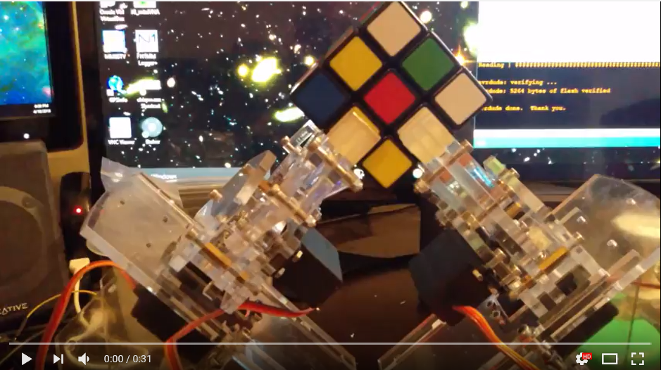

I plan to build something like this:
  >> Video << (http://www.youtube.com/watch?v=S0dl4_A_0YY)
but... cheaper  :)
or more likely
  >> Video << (http://www.youtube.com/watch?v=VqDjESQaHvQ)
but with better gripping
The robot will be semi-autonomous
Color recognition and solving to be made at PC level
Cube movements performed under Arduino control, at robot level
(USB cable could be disconnected at this stage)

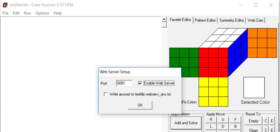

Solving will be done through already existing software, Cube Explorer (http://kociemba.org/cube.htm) appears to be a good candidate
A middleware will be developped  (using Processing or Python) to convey information back and forth
between Arduino and cube solver software
Road map:
- design a suitable gripper
- robot construction (2 grippers + frame), test and tuning
- develop Arduino code for moving the Cube
- develop the software link between solving and moving
- final integration
I will use this thread as a blog, to share success and failure
and possibly obtain ideas an advices from our community
Not sure to reach destination but the route itself is promising and definitely exciting
Stay tuned  ;)

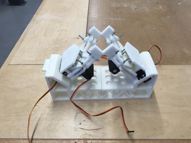

Frame:
- Plywood 10mm

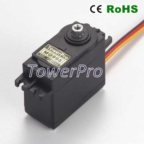

Grippers:
- Plywood 5mm (plexiglass, or PVC)
- 4 standard servo's
- M3 screws 10, 16, 20 and 24mm
- 3mm washers
- M3 nuts

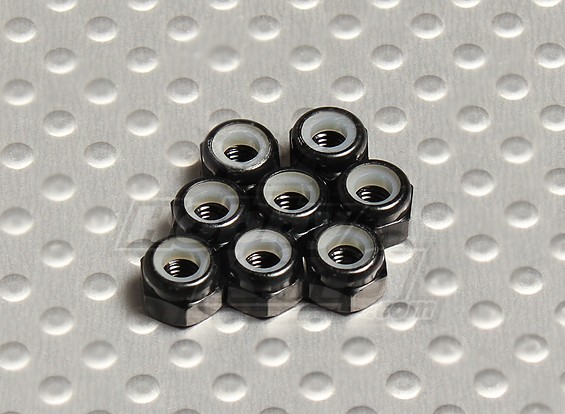

- M3 Nylock nuts (http://hobbyking.com/hobbyking/store/__23717__Black_Anodised_Aluminum_M3_Nylock_Nuts_8pcs_.html)
- 14mm brass standoff spacers (http://www.ebay.com/itm/10x-Brass-Standoff-Spacer-M3-Female-x-M3-Female-14mm-/250955120249?hash=item3a6e173e79)
For Imperial people, use 1/8" hardware

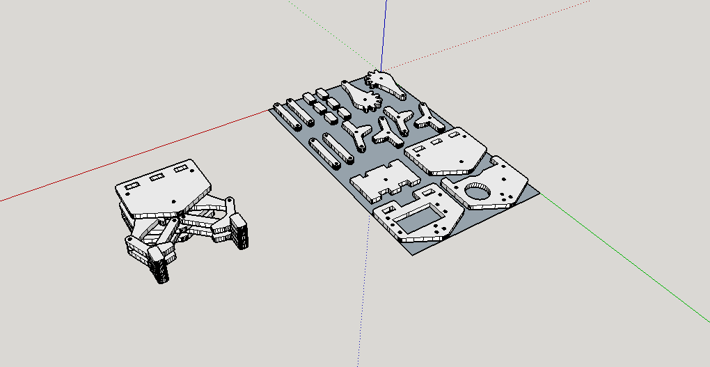

Drawing (http://forum.arduino.cc/index.php?topic=271827.msg2397325#msg2397325)
Assembly video (https://www.youtube.com/watch?v=TduyjdRO1Dw&feature=youtu.be)

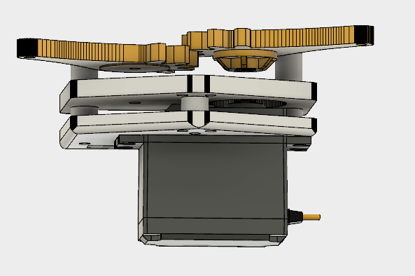

EDIT (feb 2018)

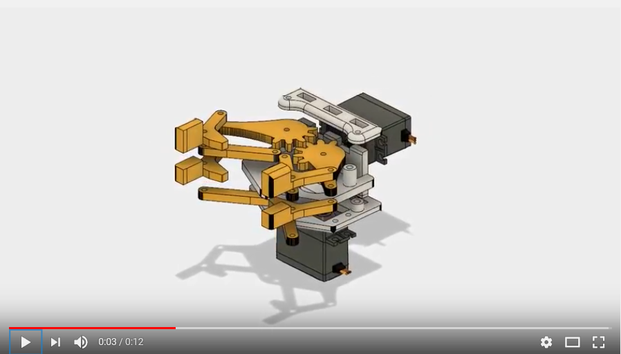

The grippers 3D printed version has been released on Thingiverse
 (https://www.thingiverse.com/thing:2800244)

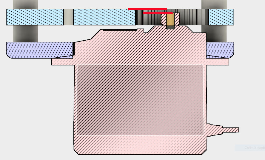

This is the Fusion 360 final assembly, including the wrist servo:
the embedded horns are designed for Futaba 25 teeth spline geometry (Futaba/TowerPro/Orion/Savox/ProTekAce/Bluebird...)
I will release the two specific parts for Hitech servo's family (24T) if required
Discussion starts at post #428

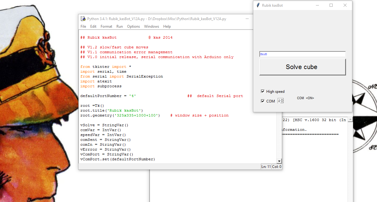

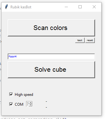

Software:
Arduino:    CubeMover V1.3 (http://forum.arduino.cc/index.php?topic=271827.msg3283775#msg3283775)  NEW          VarSpeedServo Library  (https://github.com/netlabtoolkit/VarSpeedServo)
Python (PC):   RubikKasBot V1.3 (http://forum.arduino.cc/index.php?topic=271827.msg2094567#msg2094567)
Solving (PC):   Cube Explorer (http://kociemba.org/cube.htm)

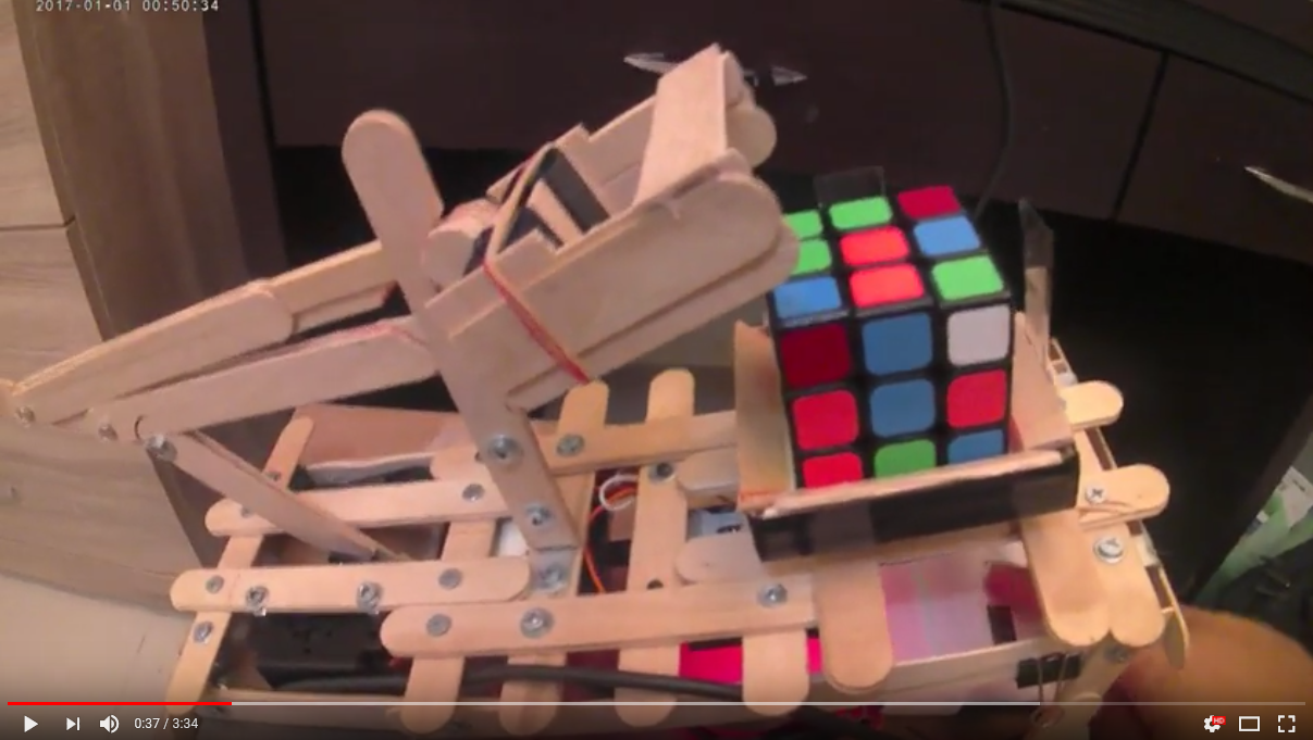

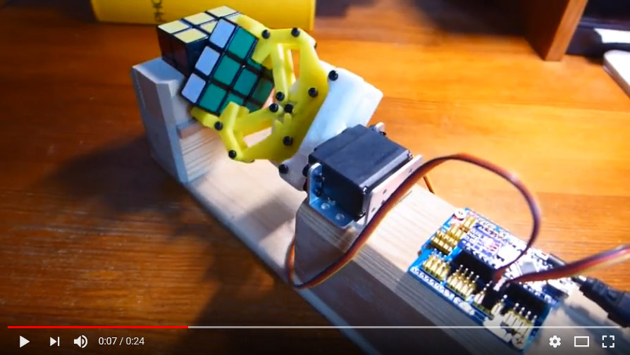

Week one progress & report  ;)
I choosed the Dagu claw MK1 (http://www.communica.co.za/Catalog/Details/P1139999143) design as a starting point
The final claw should grip the cube (55mm) and open sufficiently (55 X 1.414, thanks pythagoras  ;)  ) to allow cube rotation
Here is a first working prototype made with plywood
  >> Video << (http://www.youtube.com/watch?v=k0ZR_jjt5S0)
During testing, the gripper is controlled with an Android smartphone, using   Joystick BT Commander (http://forum.arduino.cc/index.php?topic=173246.0?)
Title: Re: Rubik's cube Robot solver
Post by: zoomkat on Oct 19, 2014, 06:01 pm
That gripper may not have the strength and rigidly to grip and twist a Rubik's cube.
Post by: kas on Oct 19, 2014, 11:13 pm
Hi zoomkat, happy to see you here  ;)
This gripper is definitely not rigid enough
I just built three new prototypes with 5mm plywood (was 3mm)
the last one has four rods (versus two) and is now strong enough to twist the cube

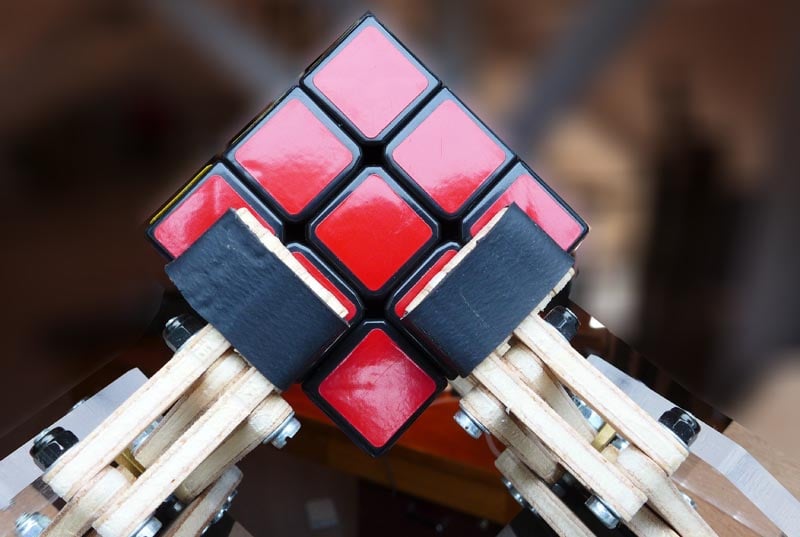

Post by: kas on Oct 28, 2014, 10:12 am
OK, new Forum bugs are slowly desappearing, time to post again   :)
This is the (probably) final design
  >> Video << (http://www.youtube.com/watch?v=TJ_wd-ewadU&feature=youtu.be)
Time to start testing with a Rubik's cube

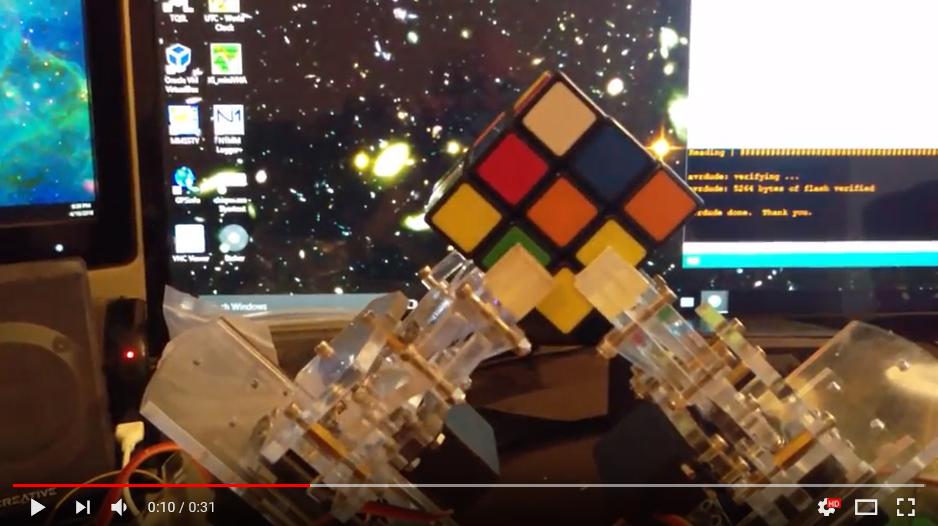

Post by: kas on Nov 01, 2014, 12:28 pm
First test with a real Rubik's cube
>> Video << (http://youtu.be/pPuBbTL4boQ)

For this project I chose the "VarSpeedServo" library which has some definite advantages
compared to the standard Servo library:
- adjustable servo's speed (see video)
- optional code pause until move is complete
Next stop: build a second gripper and assemble the final robot
** EDIT: see post #111 **

Post by: kas on Nov 07, 2014, 06:15 pm
The Rubik's cube Robot solver, together with my assistant   ;)
The hardware side is finished, let's produce some code to make it alive

 >> Video << (http://youtu.be/1QmT9pcLVms)
Those 4 moves are hard coded in the Arduino sketch
I will now prepare a sketch with all possible moves:
F (Front),  B (Back),  U (Up),  D (Down),  L (Left),  R (Right),  plus the  " ' "  and  " 2 "  variants
For debugging purpose, moves will be entered through Arduino's serial monitor
EDIT: see post #242 (code)

I also created a library to separate the "logic" of the program  from the low-level details
EDIT: see post #43 for complete code including cube.h
According to Singmaster notation,
myCube.L  generates a  <L>  move
myCube.L2  for  <L2> move
myCube.Lp  (L prime) for a  <L'> move
For demonstration purpose, the cube was first mixed according to < D B2 R2 U' F' L F2 R D2 R B2 R' >
In this video, I entered < R B2 R' D2 R' F2 L' F U R2 B2 D' > (inverse moves)  in the IDE Serial Monitor.
>> Video << (https://www.youtube.com/watch?v=BlaSLV9qSCo&feature=youtu.be)
The cube is restored, as expected  ;)

It's python's time folks     :)
Python is a nice language when it's comes to produce small utilities and middlewares
For the moment, I just implemented the "Arduino side"
this program accepts a string and transmit it to Arduino, through the serial port
in same way as Arduino Serial Monitor in Post #18
This is Rubik kasBot V1.13 (May 2017: change software versioning )

To run or modify this code, please download Python 3.4.2 (https://www.python.org/downloads/)
(available for Windows, Mac OS, Linux and others)
As for previous test, I shuffled the cube using < D B2 R2 U' F' L F2 R D2 R B2 R' > moves
and entered < R B2 R' D2 R' F2 L' F U R2 B2 D'> to solve it
Same result as above video, trust me on this one   ;)
Next steps:
- install a Webcam on the robot, to allow color recognition by Cube Explorer
- probably also install a LED lighting to overcome possible white balance variations

The final bot, with led's and webcam:
Now let's do the final Python coding to transmit color information to Cube Explorer, and obtain the magic formula to solve the cube  ;)

As mentioned, I use Cube Explorer (http://kociemba.org/cube.htm) (CE)
Cube explorer has a built in webserver
The robot has to move the cube and expose each face to the webcam, while sending IP queries to CE
Cube Explorer will insure facelets color recognition and will finally compute the solution
This is an excerpt from CE manual:
Quote
You can control the process of scanning the cube with the webcam interface by sending some
strings to the webserver.
Position the Back face of the cube in front of the webcam with your robot (as you would do it manually)
and send the string " http://127.0.0.1:8081/?scanB" to the webserver to scan the back face of the cube.
Then you position the Left face and send the string "http://127.0.0.1:8081/?scanL".
Proceed in this way, using the strings "?scanF", "?scanR", "?scanU" and "?scanD".
The webserver will respond with a "Done!" in all cases.
When the 6 faces have been scanned, you send the string "http://127.0.0.1:8081/?transfer".
If all facelets are ok, the scanned cube is transferred to the Main Window and the solving maneuver is computed.
The webserver will respond with a "Done!".
Finally, with the string " http://127.0.0.1:8081/?getLast" the webserver will respond with the last
computed solving maneuver in the Main Window of Cube Explorer.
Process this string with your robot to solve the cube.

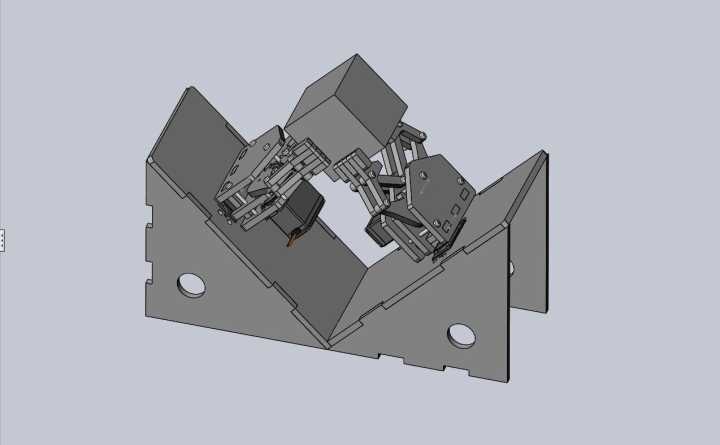

Vectric Vcarve Pro (http://www.vectric.com/products/vcarve-pro.htm) cutting simulation:
The assembly Video (https://www.youtube.com/watch?v=TduyjdRO1Dw&feature=youtu.be) (reply #15) has been created using Autodesk Inventor (http://www.autodesk.com/products/inventor/overview)
For dd5665, arduino5 and others, I attach to this post the gripper parts in pdf format
Not sure, you may have to login/register to see the file
Let me know if you need more info

For this project I used 5mm (.2") plywood and 3mm (1/8") screws
How will you cut the parts ??

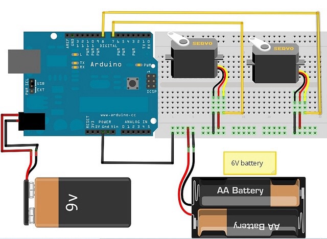

dd5665, I suggest you get really familiar with servo motors before tackling this project
No need for motor drivers, just one digital output (PWM) per Servo
Look for the sweep.ino sketch in the Aduino IDE Example (http://arduino.cc/en/Tutorial/sweep)
You may also look here (http://www.robotshop.com/blog/en/arduino-5-minute-tutorials-lesson-5-servo-motors-3636) and here (https://learn.adafruit.com/adafruit-arduino-lesson-14-servo-motors/overview)
Happy New Year to you and all the Community

Post by: arduino5 on Jan 05, 2015, 06:20 pm
Just sandwiched the layers without servo. (Its fully working, except it cannot grip anything ofcourse. Just testing the mechanics. Its very well build i must mention (your design!))
I guess if you had this cut from Acrylic or maybe wood even, you could sell it as a low-budget kit.
Like, most grippers are way overpriced. This is a very good solution. Now i just need to find a good sheet. But i may make the wood version instead. Acrylic tends to be more expensive.

As mentioned I use a middleware to connect Arduino to Cube Explorer
This Python script does the following tasks:
  1) Launch Cube Explorer
  2) ask Arduino to move the cube, face by face, for color recognition by Cube Explorer
  3) request and obtain the solution from Cube Explorer
  4) transfer this solution to Arduino
Points 2) and 3), please refer to response #24 for technical details
The code is still in the debugging stage
For point 4) see response #21
This code is 100% working
tml)
For Imperial people, just use 1/8" hardware

Before building the robot solver, make sure you use the test bench as described in reply #6, together with the test code
Code: [Select]
#define    CLOSE                85                  // servo's limits
#define    OPEN                132
#define    CW                    0
#define    MID                  87
#define    CCW                 171
You need to carefully adjust those servo's limits to obtain clean moves as per attached video
Gripper should close tight enough to turn the cube and open enough not to touch the cube edges when rotating
Also grippers rotation should be adjusted to obtain exact O°, 90° and 180° moves
Nylock nuts should be very slightly tightened, to avoid any friction
Directly building the bot is the best recipe for preparing scrambled eggs  ;)
Please show us your work in progress
Photos/videos are welcome
The complete sketch, including cube.cpp and cube.h is attached to this message
Make sure to also download the VarSpeedServo library
I will post the final python code within a few days

This is RubikKasBot.py V1.3
Code: [Select]
## Rubik kasBot             @ kas 2014/2017
## This script will:
##  launch Cube Explorer
##  move the cube, face by face, for color recognition by Cube Explorer ([Scan colors] button)
##  request and obtain the solution from Cube Explorer
##  transfer this solution to Arduino ([Solve cube] button)
## V1.3    communication with Cube Explorer (Web server)
## V1.13  changed windows position
## V1.11  slow/fast cube moves
## V1.1    communication error management
## V1.0    initial release, serial communication with Arduino only
from tkinter import *
import urllib.request
import serial, time
from serial import SerialException
import atexit
import subprocess
##  Settings
## webcam setUp: white balance 6253°K (manual), Exposition: -6 (manual) >> -9
defaultPortNumber = '3'                     ##  default Serial port
cubeExplorerPath = 'C:\\Program Files\\Cube Explorer\\cube512htm.exe' ## Cube Explorer program path
cubeExplorer = 'http://127.0.0.1:8081/'     ## Cube Explorer web server address
webCamConnect = '?connect1'                 ##  connects to 2nd device in Cube Explorer device drop down
delayB4scan = 1                             ##  delay before scanning
** Please download attached file to get full code **
** Rename RubikKasBot_13posted.txt  >>  RubikKasBot_13posted.py **
Before running this code, please make sure that you can establish communication and drive your bot using V1.2 V1.13 code (see response #21)
Enjoy  ;)

For the Video, I've been playing with the OV7670+Fifo, it is quite easy to interface with a Due.
You can check my video at https://www.youtube.com/watch?v=zgiL_f0HxRc.
For the servo control, I got a servo board for 6 DOF robot arm, both off the shelf, it is controlled through UART.
I try to use a the robot arm to move the cube from 2 cube clamp that are at a 90 degree angle.
Each clamp can be rotated with a stepper motor, the DOF clamp holding the top layer at fixed position while the 2 bottom layers are rotating.
It turns out the DOF arm I had is not accurate enough, especially when moving the cube from 1 clamp to the other 1.
I think your method is simpler, I think I could reuse my servo board, but I will have to build your robot myself (which I'm not very good at. For me programming is easier).
I'm not too familiar with Rasberry Pi neither with interfacing with an Android phone.
I'm more an Arduino purist (everything Arduino). If Arduiino DUE is not sufficient, we can always go to Gallileo... ;)
I will look into building your robot controlled by Arduino, with video capture from Arduino and Arduino computing the (non-optimum) solution, probably using the Fridrich method (average 60 moves).
BTW which cube did you use ?
I think the standard size is 54mm.
But there are smaller ones.
Also Speed Cuber are using special cube that are more forgiving for face misalignment, meaning that if a face is not totally aligned, you can still rotate a perpendicular face without 'LOckiNG' the cube, and the cube realign itself.
For such cubes I would look into the 'DALIANG ZANCHI' or mini-ZANCHI (for smaller cube), you can get it on ebay, but also there is a good vendor in the US (www.lubix.com).

i am trying to build a robotic arm using 5 servos. i am an amatuer at this stuff and trying to make it a hobby.I am trying to figure out how to make the connections...i have seen the previous posts in this thread and thought i should use a power supply to power the circuit, as i have one lying around. from what i know and the information i gathered from internet i have made the following connections
is this the correct way of connecting the circuit. do i have to use any other components on the circuit?

Your schematic is Modern Art, nice but a bit messy  ;)
for more realistic result, you may try Fritzing (http://fritzing.org)
I suspect Servo 2, 3 and 4 supplies should be reversed
Also 4 X 1.5V is a bit low for the Arduino (4 NiMH's won't work), try using a 9V battery
Make sure you connected servo's and Arduino grounds, as per your drawing
You may also use the Arduino shield described in reply #63

i have attached a new drawing i made using fritzing ..please take a look at it
do u recommend adding any voltage regulators to the servos ?

Quote
Nice and OK
Quote
No, would't work
Most linear regulators request 6.5V input to produce 5V
Your (PC ??) power supply is probably regulated

I was so excited to start my Rubik's scrambler project but am instantly discouraged. Most of my projects fail as a result of me attempting to craft, from scratch, each component needed. This time around, I was immediately excited as I am willing to purchase x2 grippers that are strong enough to support/rotate a standard 3x3x3 cube. I've been unable to find any suitable options for sale, each gripper looks like the last and they all support (on average) 70mm or less (I figure the distance from any two corners on one face of my cube is roughly 88.9mm)
Have you come across any quality grippers for sale that may work? It's discouraging to be stuck at such an early stage of this simple project, but I cannot find suitable hardware.
The only gripper remotely close to adequate is: https://www.sparkfun.com/products/13174 - although it doesn't feel like the right fit.
Post by: kas on Mar 17, 2015, 08:03 am
Quote
Excellent setup, kas
Thanks  8)
Quote
No, but it was fun to build my own
Do you have access to a CNC or a laser cutter ??   you can use the attached drawing at Post #28
If there is sufficient interest, I may consider to cut a batch of grippers and sell them for a minimal fee  ::)

Here is the picture of my gripper.

Please share your design when available. The critical point is definitely rigidity during rotation
@dd5665
Manual CNC!!   impressive  :o

Post by: rjplant on Mar 22, 2015, 08:16 pm
hey Tom,
something like this?
Post by: rjplant on Mar 22, 2015, 08:18 pm
Further to Tom's advices, try thicker gauge for the "general" supply area (more than one servo).
You may also add a 1000uF (1mF) capacitor to provide larger amounts of current during motor start
Please confirm your power supply specs (Volts, Amps)
 :o  No, no chance, refer to Ohm law
There is something wrong in your setup, please give more info and photos
hey kas
i am using a computer power supply.
am using 5v supply. its rated 5v~30A
Post by: TomGeorge on Mar 22, 2015, 09:20 pm
I would call that daisy chain, are you using protoboard as in that fritzy diagram?
Can you post a picture of  your project please.
Protoboard is not designed for the amount of current that 4 servos would need.
Tom..... :)

Hey kas! Thank you so much! I received the gripper today! It was in perfect condition. I am really thankful to you for sending me that!
I'll assemble the parts in the coming days and test the code u have given on post #6. Can you send the other gripper soon? My project deadlines are coming this April end and since it took almost 20 days to reach here.  :smiley-confuse:

Post by: kas on Apr 11, 2015, 07:47 am
Quote
Halo kas!
You done an amazing job.I just got the parts for the robot and built a claw below first claw on a cub...
:smiley-eek:  :smiley-eek:  :smiley-eek:  :smiley-eek:
Superb implementation, thanks for sharing  :smiley-cool:
How did you cut the parts??
please elaborate
Post by: kas on Apr 14, 2015, 10:00 pm
Quote
Halo Kas1
i cut the parts with a laser cutting machine,i used plexiglass of 5mm,and for the base (some pictures below) i used 1,6 cm (width) steel pipe with quadratic profile from an old troler
Very smart setup   8)    Thanks for posting
Feel free to post a moving cube video
Post by: garfield38 on Apr 20, 2015, 08:38 am
Hi
I have seen your rubiks solver at the casemate. Could someone print me the parts ?
Let me a message about the date and price.
Is there any wiki page for the part list ?
Thanks
Post by: kas on Apr 20, 2015, 10:46 pm
@garfield38
Quote
I have contacted the Casemate FabLab, and requested they cut the parts for you
I will send you a PM as soon as I get a confirmation
Quote
Will be added to Reply #1 (http://forum.arduino.cc/index.php?topic=271827.msg1915869#msg1915869) within a few days
Post by: kas on Apr 22, 2015, 07:59 am
Quote
Quote
Done  ;)

looking at picture shown at post #98
 - "DOWN" gripper (D move) is near the camera
 - "BACK" gripper (B move) is opposite to the camera
Each gripper has a Pinch (seizing servo) and a Wrist (rotation servo)
Pinch:
 - CLOSE defines minimum opening (57mm - 8mm),  should allow a firm cube grip during moves
 - OPEN defines maximum opening (57mm X 1.414 + 2mm),   should allow gripper rotation without touching the cube
Wrist:
 - CW defines max clockwise rotation (+90°)
 - MID defines zero position (0°)
 - CCW defines max counterclockwise rotation (-90°)
CW, MID and CCW should be fine tuned to obtain nice 90° moves, to avoid jamming

Hello, Kas!
I've been following this thread for a couple of weeks and just now I could finish to assemble my grippers and my base!
Really liked your design and just made a few adaptions, as you can see in the attached pictures! Hope you don't mind!
The problem is that I am not very familiar to Arduino, neither to Python! This is my first big project using Arduino, btw... So I was hoping you could help me work it out!

Post by: kas on Jun 14, 2015, 09:42 pm
Hi dd5665
Your wrist servo's are not mounted symetric, this may have an impact on alignment
Also make sure that boards are perpendicular
I enclose a pdf for the two boards (also available in eps, dxf, ai)
Important: dimensions are OK for a 57mm Rubik's cube
Let me know if it helps

Post by: kas on Jun 19, 2015, 11:48 am
Quote
I have around a month's time to fix the robot completely to solve it. I will be leaving my college after a month
That plenty of time  ;)
Please answer ALL questions
Quote
I tried the test button. this time the grippers move perfectly for all moves
1) Please test again and confirm it actually works
Uninstall the cube
run "Scan colors"
2) Do you still have communication problems when the cube is removed (reduced servo's load)
If you still get the error message:
Disconnect all four servo's (remove plugs from shield) and run "Scan colors"
You should see debugging info in your Python shell
Code: [Select]
http://127.0.0.1:8081/?connect1
b'<HTML><BODY>\r\nDone!\r\n</BODY></HTML>\r\n'
b'OKb\r\n'
b'OKl\r\n'
b'OKf\r\n'
http://127.0.0.1:8081/?scanF
b'OKr\r\n'
http://127.0.0.1:8081/?scanR
b'OKu\r\n'
http://127.0.0.1:8081/?scanU
b'OKd\r\n'
http://127.0.0.1:8081/?scanD
b'OKg\r\n'
3) Do you ??
Re-connect the two FRONT servo's only (camera side)
Run "Scan colors" again
4) Are the two servo's running OK ??
5) Do you see debug info as per above ??
Re-connect the BACK pinch servo (only BACK wrist servo is left disconnected)
6) Are the three servo's running OK ??
7) Do you see debug info as per above ??
Let me have your answers
To be continued ...

You may damage the parts if you just tear them out of the board, carefully cut the tabs with a utility knife
(http://imgur.com/Si1wE4l)
Parts also request some sanding to get them smooth
You need screws and hardware as described in post #42 (http://forum.arduino.cc/index.php?topic=271827.msg2032711#msg2032711)

Post by: bacsi1993 on Aug 23, 2015, 04:53 pm
Hey Kas!
The gripper works perfectly! :) I also tried your demo code.
Can you send me the second gripper? I really want to assemble the whole robot. :)
Thank you very much.

Post by: bacsi1993 on Sep 21, 2015, 10:13 am
Hey Kas!
Finally, I assembled the robot. It is very impressive. I have some questions related to the power supply. I'm not an expert in batteries. Could you help me?
There is an online shop in Hungary, where I have found two batteries, but I'm very confused.
Google is your best friend   ;)
http://www.robotshop.com/blog/en/how-do-i-choose-a-battery-8-3585 (http://www.robotshop.com/blog/en/how-do-i-choose-a-battery-8-3585)
http://www.instructables.com/answers/Using-Arduino-and-8-servos-What-type-of-power-so/ (http://www.instructables.com/answers/Using-Arduino-and-8-servos-What-type-of-power-so/)
Servo's operate between 5 and 6 Volts
Arduino needs 7/12 Volts
Your possible choices:
Use two different supply sources (connect the grounds)
Use a 6 volt battery (2000 mAh min) and a DC/DC booster for the Arduino
Use two Li-Po battery (7.4V) and a DC/DC step down for the servo's
For my setup, I use two LiFePo4 and get a stable 6.6 volts
This is slightly out of spec for both servo's and Arduino
but it works flawlessly
I have an old Arduino diecemila and it may not work for other models

Post by: benbowman on Feb 16, 2017, 11:55 am
hey kas, I've converted the PDF file to CAD so anyone else wanting to print the claw like me,
I've uploaded the file to google sketchup's 3D workshop as "Rubik's cube claw".
I'll be uploading another CAD file soon that doesn't require glue to piece together some of the claw,
and hopefully will save some time.
thanks kas for the awesome ideas I'm exited to get mine working.
and here is just a preview of it, I pieced one together, and have the parts separate

Post by: kas on Feb 17, 2017, 09:28 am
Nice job  8)  8)  8)
Quote
Care to post a direct link to the claw ??
Thanks for your excellent feedback

Post by: benbowman on Feb 17, 2017, 12:17 pm
here is the link to the original  (https://3dwarehouse.sketchup.com/model.html?id=c062dc9e-6c79-480b-ac92-535ff42be7bb)
and to the one that i had compacted  compacted  (https://3dwarehouse.sketchup.com/model.html?id=149cf021-ec68-486c-8035-e9aa8769095a)a little for 3D printing
i hope this helps  :)

Looks promising   :)
Nuts should be very sightly tied, to avoid too much friction (untied 1/2 turn)
I suggest you use Nylock nuts and washers
Next important step is described in post #6
Make sure to use a smooth rotating cube (Dayan or equivalent)
Please post a video for this step

Post by: benbowman on Mar 28, 2017, 12:54 pm
Hey Kas!
I've almost finished my hardware, just need a camera holster and i can get the program running.
here is what my design looks like (all 3D printed),
I'm getting exited and may have some questions about your code to come :)
I'll share again ones I've fixed the errors in my prints and have the cam holder working.

Post by: kas on Mar 29, 2017, 08:12 am
Hi benbowman
Superb implementation  :smiley-eek-blue:  :smiley-eek-blue:  :smiley-eek-blue:
See my comments (post #216) for nuts

Post by: benbowman on Mar 31, 2017, 10:45 am
Which road are you taking, Python or Android ??
thanks Kas    :smiley-sweat:
ill be taking the python path with my raspberry pie and arduino.
hey demirell95, yes the claws are too close together, I didn't take in to consideration the droop the servo shaft is having under the weight of the claw so ill be fixing the print by putting a chip at the base of the servo holding the claw.
and as for the CAD files i will upload that when i am sure that it works :) as last time i rushed a little.

Post by: kas on Mar 31, 2017, 02:50 pm
Quote
To help rigidity, you may use servo's with dual ball bearings and metal gears
I like this one
FWIW, this is a close up showing the relative position of the claws
Also keep in mind that, depending on construction material, you may add a bike rubber tyre ring around the claw to increase friction. This will add an extra millimeter at the lower part of the claw

@demirell95
I can supply frame drawing with .eps, .dxf, .ai .pdf or .crv format
Let me know
This drawing allows precise grippers relative positioning

Post by: kas on Apr 03, 2017, 11:55 am
Drawing for the wrist servo's backplanes, dxf and pdf format
Please drop the .txt extension

I made my robot :)
I applied #post6 and worked correctly.
In the current stage I'm going to apply Post 13. But I don't know how to do this.
Do you have a code? (Code in the video: Video (https://www.youtube.com/watch?v=1QmT9pcLVms&feature=youtu.be)
Post by: kas on Apr 15, 2017, 12:13 pm
Congrat, the hardware part of your project is nearly completed   8)
Quote
Do you have a code?
Please extract the CubeMover_hard_coded_demo folder to your Arduino sketch folder
Do not forget to enter your own values in the 'user servo's adjustments' aera
You may also have to tune '#define SEIZE 8" in cube.cpp
Let us have a video

Post by: demirell95 on Apr 23, 2017, 12:53 am
I finished the design and code.
" < R B2 R' D2 R' F2 L' F U R2 B2 D'> " <= I am writing this code. He's doing exactly the opposite of the video moves.For example, the video is doing the exact opposite motion(video D move on my machine D')
He works without a cube.
Video: https://streamable.com/5fswc
Post by: kas on Apr 23, 2017, 04:59 pm
Quote
Something is inverted, not important for the moment
Please, clear mark and identify servo's (Down and Back)
The "Down" servo performs the native  Singmaster "D"
The "Back" servo performs the native  Singmaster "B"
Can you make a new video with only < D B > commands
The most important is to have it move the cube without jamming
On the video, you should tighten left servo's grip by adjusting DOWN_CLOSE (or BACK_CLOSE ??) value
and/or select another no grip material
The "close" position of the pinch should be about 'cube size' minus 5 mm, for a good grip
Again, take time to adjust parameters before going any further ;)

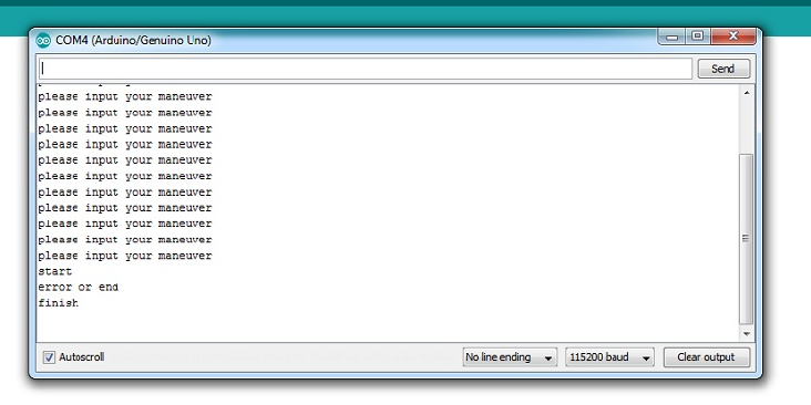

Post by: demirell95 on Apr 23, 2017, 05:54 pm
video: https://streamable.com/w5hw4
There is no problem when I test the grippers one by one. But they both have problems when they work at the same time
Send the last state of the code and the last state of the python code.
Post by: kas on Apr 23, 2017, 06:14 pm
Servo's should NEVER move at the same time, please post your actual Arduino sketch
Suspect this is a library issue
In the serial monitor, just enter DB, no need for <DB> but both will work

I used the codes in post 242. But nothing changed.
I did everything right. But why the moves are exactly the opposite.
Video: https://streamable.com/mudxs

Post by: kas on Apr 24, 2017, 07:45 am
Invert DOWN_CW / DOWN_CCW and BACK_CW / BACK_CCW
From:
Code: [Select]
// ---------- user servo's adjustments -----------
#define    DOWN_CLOSE         107
#define    DOWN_OPEN          159
#define    DOWN_CW              9
#define    DOWN_MID            89
#define    DOWN_CCW           172
#define    BACK_CLOSE         111
#define    BACK_OPEN          163
#define    BACK_CW              2
#define    BACK_MID            87
#define    BACK_CCW           171
To:
Code: [Select]
#define    DOWN_CCW             9  <<
#define    DOWN_MID            89
#define    DOWN_CW            172  <<
#define    BACK_CCW             2  <<
#define    BACK_MID            87
#define    BACK_CW            171  <<
Use your own settings and tune them to get perfect  grip  and  rotation

Without the cube, it does all the moves correctly. But when you put a cube, the servors are broken. (I'm powering just from USB. I did not plug in extra batteries. I didn't tie off the extra battery.)
Power supply should be separated, never power a servo from USB
This a wiring example:
Don't forget to connect grounds

Quote
EDIT:     getting started (April 2017)   ---------------------------------------------------
install Python 3.xx
install tkinter (graphical UI)
install pyserial (Serial comm)
now... do your home work  ;)      (this thread is not a Python tutorial)
        ... and run this basic "hello World" test program:
Code: [Select]
## Rubik (Hello, World)             @ kas 2017
import serial, time
import atexit
import subprocess
root =Tk()
root.title('Hello, World')
root.geometry('300x300+200+200')          ## window size + position
root.mainloop()
See the window ??  you are all set

You should work with the Python graphic ide (IDLE ), not with the command line tool
Please reload Rubik kasBot V1.2A   V1.13 (post #21)
Save the file as Rubik_kasBot_V12A.pyw  Rubik_kasBot_V13.pyw
Right click on the file and choose "Edit with Idle"
FWIW idle is located at \Python34\Lib\idlelib
Please, get familiar with Python through additional readings
Post by: demirell95 on May 07, 2017, 12:06 pm
[/quote]
I did it like you said.But he gave me this error again. I think I'm uploading incorrectly (pyserial)
I followed the steps in the video: https://www.youtube.com/watch?v=zedZmYIpGKM
Would you describe it with video :(

Let's check communication
connect Arduino to PC
load Rubik_kasBot_V1.13
select COM port
enter D B R U U' R' B' D'
Cube should move (D B R U) and go back to initial colors position (U' R' B' D')
Please post a video (put Front & Back labels on grippers)

Quote
Do you take a video using Python code and camera
Sorry, I moved to the Android version a long time ago
I even don't own a webcam anymore
Please respond to my post #267 for checking both Serial communication and Cube moves

hey kass,
sorry its late, i'm not sure that video would be helpful, but i thing my pythons fixed but i incly=uded an image of the arduino error message, if you could help
thanks

::)  ::)  you are missing the bip() function
This convenient utility function drives an active buzzer, as shown below
which code version are you using ??
Post by: demirell95 on May 16, 2017, 07:38 pm
Everything is right
But it gives such an error
I dont understand ?
Post by: kas on May 16, 2017, 10:40 pm
Quote
Everything is right
I dont understand ?
Communication with Arduino is not established
We need to validate both serial communication and cube moves

Hi kas,
I can't use a 3D printer or a laser cut machine to create grippers... Is it possible to make them handmade? Or is there another solution?
And what does it mean that the robot is semi autonomous?
Thank you
Post by: kas on May 17, 2017, 10:26 pm
Hi kas,
Hi sirnikop
You can't have them handmade, you will spend a lot of time and, at the end, it won't work
Why don't you find a Fab Lab near you, and have them CNC'ed, printed or laser cut ??
Otherwise come back to me, we will find a solution   ;)
Quote
The webcam version is 'semi autonomous' and need to be connected to a PC
The Android version is 'self contained', very convenient for exhibiting at Maker Faire

"Test" button does scan one face only per press
first press = face #1 (no move)
second press = face #2
Let me know how it works
Post by: lampel on Jun 23, 2017, 09:52 pm
Hello all ,
does anyone has the frame (stand) stl files for 3d printing ??
i 3d printed the claws from the previous posts and it works good ,
i saw kas support v2 dxf file but it seems not suitable for 3d printing ,
thanks

Post by: benbowman on Jul 28, 2017, 11:07 am
hey kas!!
long time no contact, i gave up on my project for a little bit there but decided my school might disapprove. might have some simple coding questions to come like if i could get away with completing the project with out a buzzer.
as for you lampel, I did just upload my base for my cube solver, however the camera holder thing i made was a rushed job so might need to glue, drill or someting to make it work. here's the link to my base https://3dwarehouse.sketchup.com/model/cf7d9f09-c40f-469f-a40b-c59e31414775/Rubiks-cube-solver-base (https://3dwarehouse.sketchup.com/model/cf7d9f09-c40f-469f-a40b-c59e31414775/Rubiks-cube-solver-base)

here's a video of the cube, as you can see the gripper on the left is lose and the one on the right seems fine, these are what my limits are set to, i thought it might be because of the my limits being the oposite to yours (close is higher than open, yours is the opposite)
   DOWN_CLOSE          76

First make sure that your can manually increase claw closure
You may have reached the mechanical end stop of your left servo
Just unscrew, lift the driving arm and rotate it
Quote
That's a possibility
Remove cube,
adjust DOWN/BACK_CLOSE/OPEN parameters one at a time and see the effect for yourself
For a good grip, without cube inserted, claw should close about 2mm more than the actual cube edge size and open 1 to 2mm more than cube diagonal

Offending code:
try:
  p=subprocess.Popen([cubeExplorerPath])        ## Cube Explorer launching
except:
  vSolve.set("** Cube Explorer not found **")
The most probable reason for the raised exception is a wrong/malformed path to cube512htm.exe
 - can you launch cube512htm.exe manually ??
 - what is your absolute path to cube512htm.exe on your computer ??
 - are you Windows or Mac ??
 - please copy paste the "cubeExplorerPath = ...." line from your actual python code

This is not the right code snippet, I am refering to line #354
Quote
           "C:\Users\ben\Documents\school\systems\cube exporer\cube512htm.exe" is this what you need?
          "cubeExplorerPath = 'C:\\Program Files\\Cube Explorer\\cube512htm.exe' ## Cube Explorer program path"
Based on your information, your actual python code should read (line #26):
 cubeExplorerPath = C:\\Users\\ben\\Documents\\school\\systems\\cube exporer\\cube512htm.exe
Post by: benbowman on Aug 15, 2017, 01:36 pm
thanks heeps kas!!
that fixed it, i thought tried that but i thought it might be a local path or something.

now that ive tested the code with the hardware but when i try to "scan colors" the text says " no response from cube explorer" and same when i try reset but not test. but the program opens cube explorer, any ideas
Post by: kas on Aug 17, 2017, 08:06 am
Quote
Yes   ;)
Please enable WebServer in Cube Explorer
FWIW, I enclose the relevant documentation, please read
Post by: benbowman on Aug 31, 2017, 06:42 am
hey kas, that fixed the error.

here's a video kas
https://www.youtube.com/watch?v=7RkVfVERU-o&feature=youtu.be (https://www.youtube.com/watch?v=7RkVfVERU-o&feature=youtu.be)

benbowman,
Make sure your hardware is 100% tuned before fiddling with color recognition
You will save a lot of frustration  ;)
Your grippers are possibly too far apart
Cube should really sit on the base of the claw
Try inserting four washers between each servo and frame and see for yourself
You may also increase gripper closing by 1mm, by adjusting
  #define  BACK_CLOSE     and  #define  DOWN_CLOSE
What Arduino sketch version are you using ??
Quote
i think this is because the claw scans in the wrong direction?
To change rotation direction, invert values for both servo's
  #define    DOWN_CW                 9   --->  172
  #define    DOWN_CCW           172   --->      9
  #define    BACK_CW                  2    --->  171
  #define    BACK_CCW             171    --->     2
(use your own parameters)

From the video, seems you are missing the reseat() function
Please confirm your  CubeMover  sketch version
Post by: benbowman on Sep 04, 2017, 06:05 am
hey kas,
im using cube mover 1.2 is that too early?
and i'm based in Melbourne Australia.
Post by: kas on Sep 04, 2017, 09:50 pm
Please use the most recent release
V1.3 introduced the reseat() function that briefly opens/closes grippers between two moves
and helps reseating the cube on the base of the claw (post #359)
Also look at Cube::downArmCW() & Cube::backArmCW()
I added a small rotation overshoot to ensure that moves are really square
Please adjust to taste
How do you power servo's & microcontroller ??
When ready, please post a new video
 - robot only
 - from one side
 - with faster moves

Can u plz give the wiring of servos and arduino
- back pinch servo to pin 5
 - back wrist servo to pin  6
 - down pinch servo to pin 9
 - down wrist servo to pin 10
for additional inspiration, look here  (http://forum.arduino.cc/index.php?topic=271827.msg2154535#msg2154535), here (http://forum.arduino.cc/index.php?topic=271827.msg2137172#msg2137172), here (http://forum.arduino.cc/index.php?topic=271827.msg2248638#msg2248638) and here (http://forum.arduino.cc/index.php?topic=271827.msg2256555#msg2256555)

can u plz try to send me the grippers
Sorry, no more grippers available
Where are you based ??   I am confident you will find many CNC's, 3D printers or laser cutters around
Ask your friends and/or look for FabLabs

Nice  :)
Enter "rubik robot" on YouTube and you will see a lot of interesting projects
I personally like this one (http://jacoburge.co.uk/rubix-cube-solving-robot) for the very original color recognition method

will i need to change the code or can i just copy paste it
You just have to adjust servo's limit values
Code: [Select]
// ---------- user adjustments -------------------
#define    DOWN_CW              9
#define    DOWN_MID            89
#define    BACK_CW              2
#define    BACK_MID            87

Post by: ParaPedro on Nov 25, 2017, 06:02 pm
Hi Kas
Here's my interpretation of your design.
One thing I've discovered while testing and tuning with CubeMoverHardCoded is when I made my grippers, I made a left (Back) and right (Down) version of them. I orientated the servo's so all the wiring from the pinch servo's would lead out the back of the frame.
The problem I found when testing is that the SEIZE command would make one gripper grab the cube tight, while the other would release and drop the cube.
I found that by editing the cube.cpp file and changed the (_downClose + SEIZE......)  command to be (_downClose - SEIZE... ) it appears to have fixed it.
Will this cause problems further down the track as I progress.
Maybe a trick for other beginners to be aware of.
So far, so good.
Post by: kas on Nov 25, 2017, 08:07 pm
Nice setup, classic style   :)
 - On the picture, the left gripper seems a bit high compared to the right one
 - You placed the "wrist" servo's vertically, please make sure that grippers can still rotate as expected
It is good practice to have the BT card antenna slightly outside the mother PC board
for this project with short distance broadcast, it won't matter
My grippers are ambidextrous with wirings on both side of the frame
You will encounter additional problems that will be easily fixed in the code
Post a video when ready

Title: 3D printed gripper
Post by: kas on Feb 13, 2018, 03:00 pm
@ matelot,
Check your mail   ;)
This is the new 3D printed gripper V2
simpler to build, only M3 screws and some filament
no more washers, servo's horns and standoffs are now embedded in the relevant PLA parts
This instance is fitted with a mini top plate, to expose the internal mecanism
This gripper was printed @40mm/s with 30% infill, no support needed
Let me have your comments

I have had right fun with the python. I have never used python before so a learning curve is so steep it is blocking out the light.
I have managed, after two days to get the hello world box but I had to do it without the lines
import serial, time
import atexit
import subprocess
the cmd says no module named 'serial'   ?
I have been trying to find out why on various forums but without much help. can you understand why?

Did you download and install the pySerial (https://pythonhosted.org/pyserial/) package ??   ::)
Post by: matelot on Feb 13, 2018, 05:40 pm
I have downloaded the package but I have a feeling it is not in the right directory.
I have the python in
c:\.....python\python36-32
and the pyserial in
c:\.....python\python36-32\pyserial-master\pyserial-master
Can I just move some files to get it right and if so which ones?
Post by: matelot on Feb 13, 2018, 05:47 pm
I am trying all sorts of things to get it to work.
I am changing directories in the command prompt and moving various files around but just keep getting nowhere.
I am now at the point with setup.py in the python directory and failing to load cos it can't find _init_py.  _init_py is in the seriel directory back in pyserial_master. I don't want to keep moving files around like this, there has to be a way round this I can't see everone having to do what I am doing?
The cog printed and looks quite good.
Post by: kas on Feb 13, 2018, 06:56 pm
Quote
Matelot, we are on the same boat   ;)
I first fiddled with Python, 3 year ago for this specific project and have not used it later on  ::)
I tend to remember that pySerial had a built in installer
Also make sure not to mix 16/32 bit versions for Python/pySerial
My "serial" files are here: C:\Python36\Lib\site-packages\serial
