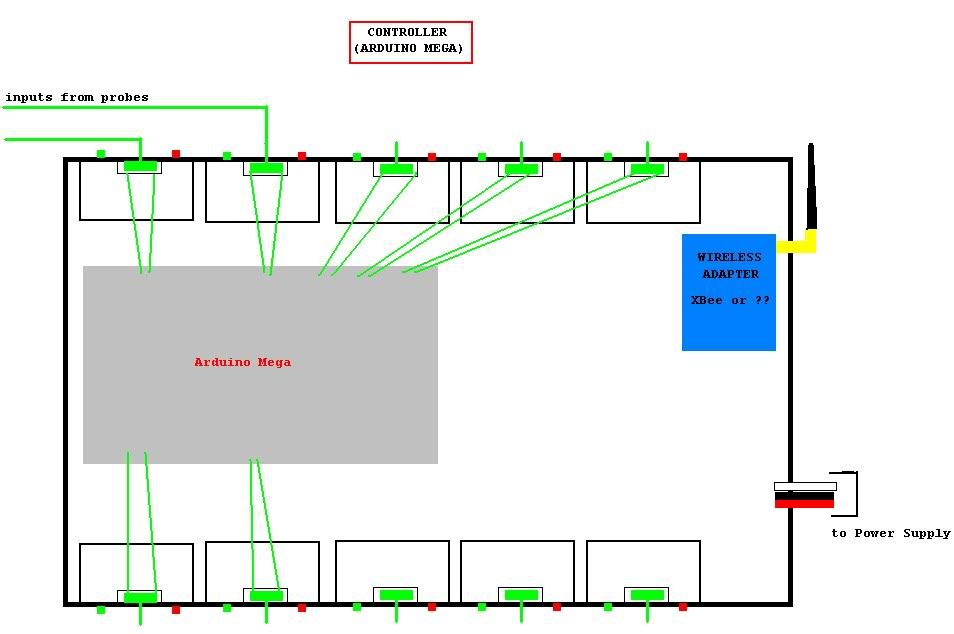

A combined temperature and humidity probe that has a very small footprint, is protected from excess moisture, and has a long (10ft+) cable from the probe itself to the controller
Why not put the controller nearer to the probe? Long cables require additional processing/hardware.
It was my thinking that one controller would service multiple probes. Usually the tanks to be probed are set up on bakers racks (like metal bookshelves). This way one controller could service either one shelf of multiple tanks, or the entire rack. Often times there may be as many as 6 smaller tanks on one shelf, having longer probes would be useful for reaching from the top of the rack to the bottom to create a sampling of temperatures for that one rack/shelf.
Quote:
- Controller displayed readings of temperature and humidity based on probe number
How many probes do you figure?
At least 4

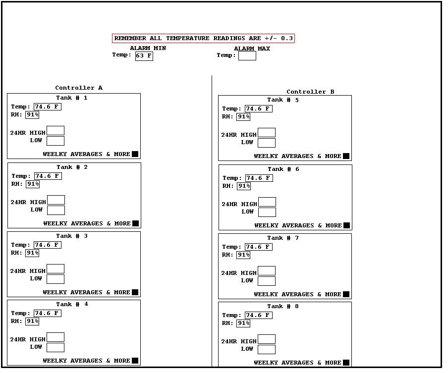

- Computer displayed readings of temperature and humidity based on probe number as well as the ability to log the data and make calculations from it (e.x. 24 hour high and low temp/RH, daily averages, weekly averages, etc)
Using the logged data is something that a spreadsheet on a PC is better suited for.
I wanted a PC to be a major component of this project.

Sounds like a job for a SHT15 - http://www.sparkfun.com/datasheets/Sensors/SHT1x_datasheet.pdf - in combination with a softserial library .
One Arduino can sample 4 sensors - once per 10 seconds or so - ; add an ethernet to post all the sensor data to a PHP page on a PC which stores it in a MySQL database or a logfile per sensor per day or so.. You can use this data to make nice graphs
Furthermore add 4 outputlines for solid state relays to switch PC-fan's  for fresh air - they need a separate 12 Volt. (the automatic cooling is kept locally this way, independant of the logging PC..
A warning system can be built in the PC if the sensors are not logged, if temp or humid is too high or too low.
Please consider at least a master temp sensor that monitors the room temperature too.

My questions were more for getting you to think about the requirements, than to criticize anything. Writing a good requirements document is critical to successfully developing a project.
As Rob's price list and wiring comments shows, ethernet is not really going to be practical for a room full of tanks. A XBee shield and XBee at each tank may be all that is required. Each XBee can read sensor data (temp/humidity) and send that data wirelessly. The PC could be running a program that gets data periodically from each XBee, and tells the XBee to turn on or off a fan. There really doesn't need to be an Arduino at each tank.
Putting a XBee at each tank means that the temp/humidity sensor lines can be kept short, eliminating the need to deal with long lines.
Of course, as a project for you, there is one set of requirements. If you want to make and sell monitoring equipment/software, you may have different requirements.
Just some things to think about. Good luck.

So... one Arduino UNO can monitor 4 of the SHT15's and transmit the data wirelessly (thanks PaulS) via an XBee (of some sort) to a computer? Will the computer end of the transmission require another Arduino UNO, power supply (not through USB?), and XBee device(s)?
Is there a way for a solid state relay to operate something with higher voltage (regular household current) such as a: http://www.amazon.com/gp/product/B000WEIJ7K/ref=pd_lpo_k2_dp_sr_1?pf_rd_p=486539851&pf_rd_s=lpo-top-stripe-1&pf_rd_t=201&pf_rd_i=B000BKGOM2&pf_rd_m=ATVPDKIKX0DER&pf_rd_r=0C34ZQGDHZT2991M5TTC
Yes.
Quote
The PC end could consist of an XBee and a USB explorer (or there is a dongle version).
Quote
That is the function of a relay, solid state or conventional.
Quote
All I need are an SHT15, XBee, power supply, and sensor wiring/casing at the tank, and with appropriate receiving equiptment (?? another XBee?) at the computer?
That is one way of doing it. It has advantages in that the sensor is close to the sender.
It has disadvantages in that the XBee has a smaller number of digital and analog pins, compared to an Arduino with XBee, and the XBee can't make decisions. The Arduino would be able to handle more inputs and make decisions, rather than the computer.

rocketgeek
I like the idea of a probe to wireless central base.
Main Requirements:
- the system must monitor temperature per tank
- the system must monitor humidity per tank
- the system must have settings per tank
- the system must sample temperature every 10 seconds
- the system must sample humidity every 60 seconds
- the system must apply a warning when temperature is outside the range [XX..YY]
- the system must apply a warning when humidity is outside the range [XX..YY]
- the system must have a local feedback about its working condition (local feedback on control side, much like indication lights on an ethernet connection)
- the probe must be able to sample data accurately while its electrical components are protected from a high humidity environment (80% RH+)
- the system (minus PC & any future fan expansion) must be less than 30db loud
- the system must be easily expandable
==> - little difficulty when adding addt'l probes and controllers
- the system must have a graphical PC interface for customization of data representation and overview of output data
- the system's data must be easily accessible remotely by persons of little to no computer savvy
==> - i.e. hourly tweets or e-mails when function is activated
- probe and probe connection to controller must be easily installed into tanks that are already inhabited
==> - i.e. small probe and probe connector/wire
Since I am a very visual person, here are some more visual aides to go along with requirements and further explanation.
Probe
- the sensor must be able to take readings and be protected from excess moisture while being in a housing with the smallest footprint feasible.
- the probe's wire connection to the controller must be as thin as possible
==> the midway connector is only needed if the controller's input socket (from probe) is of an unacceptable size
- it is not necessary for the probe to be wireless
===( Any ideas of max probe wire length? )
Controller
- the input socket from probe to controller must be uniform
==> - this way addt'l probes can be added/removed easily and without any tools
==> - status indication lights (red/green) for a go/no go on sensor
--Things that would be nice--
- wireless communication between controller and PC
- controller mounted small LCD display with 2 button scroll through sensor information
PC Interface
- wireless/hardline connection from controller
- remote accessibility of data
==> - tweet/sms/email
- remote repetition of alarm signal
==> - audible/tweet/sms/email
- ability to customize output display
==> - custom tank display names, choose which information to display, C or F (maybe K for s&g's)
- the ability to save a log of sensor readings
- must be easy to operate for people without extensive computer skills
==> - maybe a basic and advanced mode?
It could be a lot fancier than this, but sometimes simple is better.
