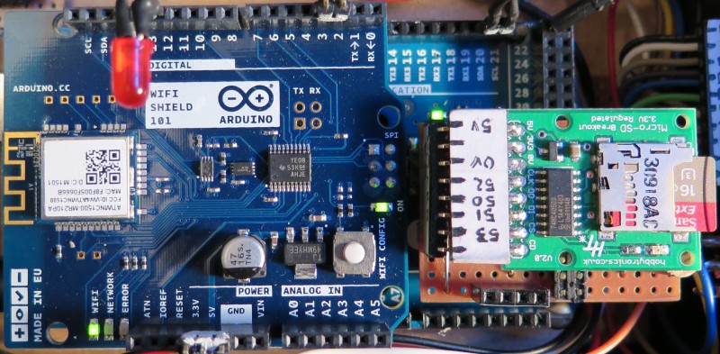

I got the new WiFi101 board a week ago.
It worked straight out of the box, plugged into a Mega 2560.
So far I have written a web server and a SMTP e- mail sender.
For e-mail, I started with the code written by Razorblade
http://forum.arduino.cc/index.php?topic=67701.15
It worked but was very slow because of the utilisation of a single byte read , single byte write method.
No doubt this allows a Uno, with limited memory, to complete the task.
The mega has enough memory to create a read and write buffer.
I was able to use Razorblade's encodeblock to convert each group of 3 bytes to 4 base 64 bytes.
The buffering decreases the encode time from 43 seconds to 0.5 seconds on a small jpeg.
Time and date was obtained by adapting the example code in  WiFiUdpNtpClient.ino
I have included Base 64 encoding for the login to Plain authorised ESMTP servers.
The code is too big to post, but I have attached it.
Full details are shown in the comments:

Getting started:
  Alter useserial as required.
  Some filing, mailing and Wifi parameters require editing.
  Fill in the e-mail details in void sendit:
    Sender, recipient, attachment, subject, body message, priority and read request.
  (Copy the required attachment files to the Arduino sdcard.)
  Attach led with 1K series resitor- anode to pin 12, Cathode to 0V.
