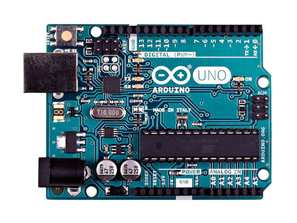

Hello I am trying to control two DC motors using the HC-SR04 ultrasonic sensor. I am using Arduino uno and the Motor control shield. Bellow is my code. The motor only go forward. What am I doing wrong?

cm = microsecondsToCentimeters(duration);
So you have now converted the sensor reading to centimeters, so far so good.
Code: [Select]
for (cm=0; cm<=100; cm++)
 //if (cm<=100)
motor1.run(FORWARD); //go forward for cm between 0 and 100
motor2.run(FORWARD);
  //println(cm);
  delay(100);
For no apparent reason you decide to blow away that nice sensor reading and instead count from 0 to 100, during which time you set the motors going forward every tenth of a second.
Code: [Select]
if (cm<=10){
motor1.run(RELEASE); //Stop
motor2.run(RELEASE);
delay(100);          //delay
motor1.run(BACKWARD); //go backward
motor2.run(BACKWARD);
delay(100);
else if (cm>10&&cm<12)
  motor1.run(BACKWARD);// from backward 2cm then turn right
  delay(100);
//delay(500);
else if (cm>12&& cm<14)
  motor1.run(FORWARD); //Left turn
delay(100);
//motor1.run(FORWARD); // Left Turn
//motor2.run(BACKWARD);
//delay(500);
Now you have some if statements, none of which will ever be true because your for loop set cm to 100.
Code: [Select]
  Serial.print(cm);
  Serial.print("cm");
Then you print the value of cm but apparently you didn't bother to look at it, otherwise you would have noticed it's always 100.
Code: [Select]
Just for kicks, calculate cm again, right before it goes out of scope.
