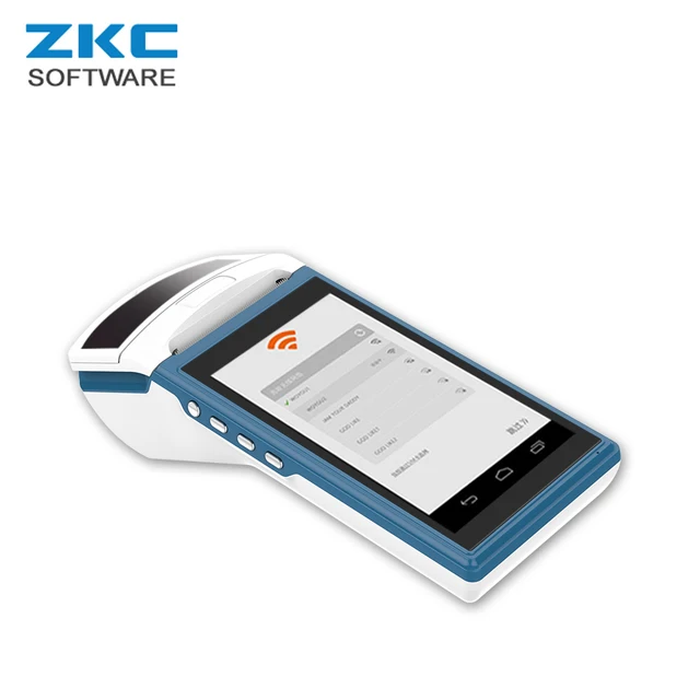

With the help of one of this forum this morning I am finalizing my project! And now I have some concern.
I want to start designing my own PCB (the shema).
On my arduino project, I use:
* An RFID module
* A Wi-Fi module
* A fingerprint reader
* Touch TFT LCD Screen
to name just that.
Now I would like to know how to get all the functionality of the RFID module, the Wi-Fi card on my PCB without soldering the Wi-Fi card or the RFID module on my PCB?
I do not want to put an Arduino, with all these modules and cables in a box. I want something compact with the functionality of the components I just mentioned!
Here is about what I want to get in the end.
I want a PCB like this but with the functionality of the RFID and WiFi module without their motherboard. I do not know if removing the components of my RFID and WiFi module and soldering them on my PCB will work and in addition the risk of damage or that they do not work properly is great.
So what do you propose to me?
cordially!

Instead of hte ESP-01 of course you use the ESP-12 module, that gets you to ditch the Arduino in the process (the ESP-12 can handle everything your Arduino is doing just fine, you probably will have to add a port extender). That's a big space saver already. Or get an ESP32 and you can drop your Bluetooth adapter and have plenty of pins available. The processing power of the ESP32 will also allow you to do lots more fancy things with your display.
The RFID module: unless you have had a serious education in RF board design, and years of experience (you obviously don't or you wouldn't be here) don't even think of trying to replicate that. Use it as is. Soldered as module onto the PCB (use headers as connectors), or wired to the PCB.
Everything else: solder or crimp connectors on their wires, and connect it to your custom designed PCB.
the PCBs of our phones that have bluetooth, wifi, NFC and other comm modules are very compact
True. And I don't think you have the skills to even understand the design considerations that go in a design like that. I know it's way over MY head at least.
One phone design takes a team of hundreds of highly educated specialists months if not years to develop, depending on to what extent they can build onto a previous design.
That actually looks very much like an Android based tablet in its core.
