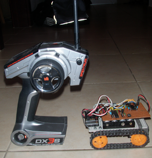

   I have just posted a new topic to the RC Arduino blog, this one deals with something rarely covered - calibrating your Arduino project to your transmitters RC Signals. Its also finishes with the full code used in a simple RC Robot previously posted on the blog.
In addition to reading the RC Channels and providing a 'one touch' calibration the code allows a two channel RC Transmitter with throttle and steering channels to control a tracked robot with only two motors and no steering channel.
Original post with short demonstration video -
http://rcarduino.blogspot.com/2012/05/rc-arduino-robot.html
Latest post with explanation of calibration and control code, plus the fully commented code !
http://rcarduino.blogspot.com/2012/05/interfacing-rc-channels-to-l293d-motor.html
The control is very intuitive - full forwards and reverse proportional control, proportional steering in both forwards and reverse and rotation on the spot at idle.
