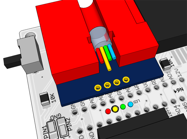

I found two "issues" with the enclosure. The one stand off that allows the arduino to set is a little too big to fit through the hole. As usual with most 3d prints, this was filed down but took a little effort being circular without a lot of space to work with. More importantly, there are screws going to nowhere from both sides of the case. A spacer would be great for some of these but the guide stated 2*8 screws for this build and the spacers I bought are for the revision. The buttons, I tried to push through where the button sits but it's a little too tough so I tried self tapping screws but applied too much pressure and slipped, poked a hole in my fold away desk.
While installing the RGB LED I didn't quite understand the way the legs went by the diagram so I used a multimeter to figure it out. I felt putting positive and negative would be helpful here. I've also had trouble with the new N64 sleeve I printed. I remember reading somewhere throughout the guide to set the walls at 0.1 I think it was. I did this the first time so ended up just swapping out for the old sleeve.
I also realized with this enclosure I will not be able to install a battery. I suppose that's probably one of the main reasons for the revision but my first time around I wanted to build something to make it feel 'complete'. Can you suggest any ideas to make this thing more solid? I don't want to put too much pressure on the board and pulling carts causes me feel as though I'm going to break it.
I will make the pin a bit smaller in the next design revision.
Could it be that you forgot to install this part? https://github.com/sanni/cartreader/blob/master/case/sidewall_tabs.stl
This sounds like either wrong print settings or your 3D printer is not calibrated perfectly. Check the belt tension of your 3D printer and print a calibration cube, then measure all three sides to make sure all are 20.00mm. It could also be over extrusion.
I have added "Red, green and blue are negative. The longer leg of the LED is positive. The positve pin is marked on the PCB with a circle around the hole." to the Wiki, thanks.
I now put the print settings at the top of the github page to make them easier to find, thanks.

I was taking photos, messing around in Photoshop and edited your PICKit3 Diagram to be more accurate to the one I received. Feel free to add it to your wiki:
And also this addition for the SOIC socket:
