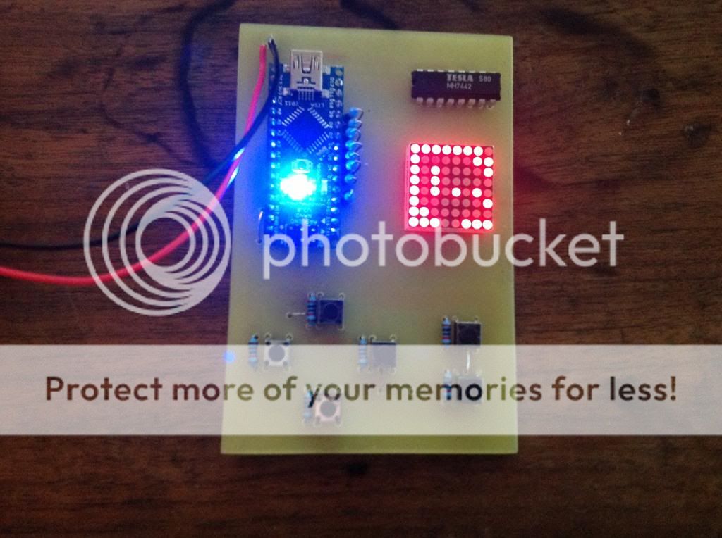

So I have this little 8x8 led matrix game powered by an arduino Nano here:
The little thing was working just fine and dandy for quite some time until a couple of days ago the whole USB computer interface stopped working entirely. I was just in the middle of using it hooked up to my computer when it just stopped powering on. I unplugged it and replugged it in a few times to see if I could get it to work with no luck.
If I power it on by using a 9v battery (like in the next picture) it is able to function. The led on the arduino lights up and the LED matrix lights up.
now, it should do the exact same thing when I plug it into my computer by USB. However, when I do that now nothing happens at all. The led doesn't light up and my computer doesn't even seem to recognize it:

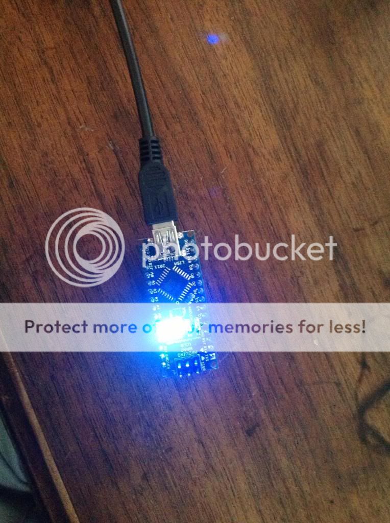

But it definitely isn't the computer or the cable's fault, because I have an identical Nano that when plugged into the same computer with the same cable it powers up fine:
This would lead me to believe that it is probably a hardware issue on the arduino, but I checked out the physical plug and compared to my spare arduino nano. The connector looks to be identical and doesn't look damaged in any way.
So this means that it isn't the being caused by a fault in the actual circuit, it isn't the computer's/cable's fault, it isn't the plug's fault, but what could it be?

Is there 5V present when it's plugged into the USB?
> > > Look on the attached schematic, bottom of the page, in the middle; D1, "5V Auto Selector".  It's VUSB on one end, the other (the 'output') goes to "+5V"

You might have broken something on the Arduino itself, you should try probing the Arduino with a multimeter to see if there's any voltage present on the actual board.

There is a diode between Vusb and 5V.
http://arduino.cc/en/uploads/Main/ArduinoNano30Schematic.pdf
I don't know what that IC does, but if it doesn't limit the current to those LEDs (I'm betting on, it doesn't) then you may have drawn enough current to damage that diode.
While connected to USB, I would measure the voltage across both sides of the diode.

Shouldn't the resistors I have drop the current enough to prevent that kind of damage? I don't know if you can see them but there are 8 of them (one for each row on the screen) right up against the nano.
Oh and the IC is just a shift register.
No, I didn't see the resistors.  my bad.
I'd still check to see if the diode is damaged, that's the gate between the regulator/5V pin and Vusb.

Okay, I will. However, do you know where it might be located? because if it is on the underside I have no way to get to it since my nano is directly soldered in place.
As I recall, it's on the bottom. next to the tantalum caps (yellow parts).

Plug your Nano into the USB
Get out your voltmeter.
If you don't measure 5V with the positive lead on "5V" and the negative lead on one of the Nano's "Gnd" terminals then that aforementioned diode is b-a-d.
