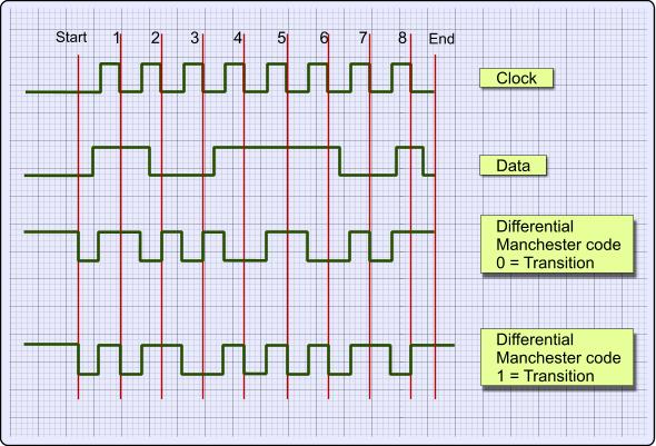

[font=Arial]Here is a rundown of what I have learned about differential Manchester encoding. Much of this information was adapted from this source: http://www.pcbheaven.com/wikipages/manchester_coding/ but I have tweaked and added to the material. Hopefully this will make all of this clear to those interested in reading about it.
In the following figure, we define:
Clock period = elapsed time between two numbered red lines.
End of the Nth clock period is indicated by the number next to the red line.
The end of one clock period and the beginning of the next clock period occurs at the same time.
In the image above, the level of the differential Manchester encoded signal is kept HIGH when no data is being sent (before Start and after End). There are 2 encoding methods: The first is the "Transition on LOW" and the second is the "Transition on HIGH". Both methods use similar logic to determine when a transition should take place:
In the middle of each clock period a transition in the differential Manchester encoded signal always occurs. Data is sent when the clock transitions at the end of each clock period. If the data bit to be encoded is 0, then a polarity transition also occurs at this time, otherwise the line remains unchanged.
For example consider the “0 = Transition” (on LOW) sequence in the figure. The data that is transmitted is the binary '10011101' (starting from left to right). Each data bit is transmitted during negative transition at the end of each clock period - these are indicated with the red lines (additionally shown in red are the start and end of the transmission). You can see that between each bit transmission (halfway between pairs of red lines) the encoded signal changes polarity.
Note that the clock, or a good estimate of it, can be recovered by the receiver from the first two transitions in the differential Manchester encoded signal. This is because the line is held in one state before the transmission begins (the standby state). Which signal level is used for the standby state does not matter. In the example above, the standby signal level = HIGH). Because the signal polarity may change during transmission (which would also change the standby state level), the property that the standby state is unimportant is very useful in practice. Once the clock frequency has been estimated from the first two transitions, subsequent transitions are used by the receiver to receive data bits and/or to update the estimate of the clock. All transitions should occur at multiples of the time between the first two transitions, and a kind of running average can be used to update the clock estimate. This can be useful when the timing of the transitions is not precise.[/font]
[font=Arial]To decode the differential Manchester signal, we can use a micro (such as an Arduino) digital input pin with an interrupt that is called when there is a level transition on the pin.
The code waits in “standby mode” for the interrupt to trigger. In the figure above, this would happen at "Start" with the first HIGH to LOW transition of the differential Manchester encoded signal. The time at which the first transition occurs is stored as the start time of the transmission. The code then waits for the interrupt to be triggered a second time. This will happen at the middle of the clock period, because differential Manchester encoding always has a transition there. The code then calculates the first clock period estimate as twice the time difference between the two initial transitions.
The code then enters the “receive incoming signal” mode and now actively checks for the level of the pin at each half period of the clock. The transition at the half period is used to update the estimate of the clock period and the transition at the end of each clock period is used to receive data, using the following scheme:[/font]
  • [font=Verdana]TRANSITION IF LOW: add a 0 to the received bit stream if there is a transition at the end of the clock period. Add a 1 to the received bit stream if there is no transition at the end of the clock period.[/font]
  • [font=Verdana]TRANSITION IF HIGH: add a 1 to the received bit stream if there is a transition at the end of the clock period. Add a 0 to the received bit stream if there is no transition at the end of the clock period.[/font]
  • [font=Verdana]When there is no longer a transition at the half period of the clock, the transmission has ended and the code returns to the standby mode.[/font]
