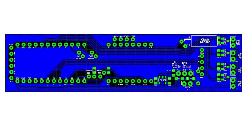

JakeSoft
#366
Jan 09, 2016, 04:54 am Last Edit: Jan 15, 2016, 03:46 am by JakeSoft Reason: Updating X/Y/Z pins per later post from Canobi.
As to the layout I'm reworking now, I've used the Spectrum as the template as it supperts upto 6 LEDs. Here's what the pin list looks like:
2= Clash sensor
3= NFET gate1 (FoC LED)
5= NFET gate2
6= NFET gate3
7= PWR button
8= AUX button
9= NFET gate4
10= Accent LED 1
11= Accent LED 2
12= BUSY
13= SCK
A0= X
A1= Y
A2= Z
OK, I adjusted my I/O pin assignments to comply with this and got it working on my breadboard. I'm including the code for the header file that defines the pins in case anyone else wants to make software compliant with Canobi's PCB.
@Canobi: Check this out and confirm it looks right to you.

Here's a smaller lower res pic of the board:
Dropbox link to high res image (it's quite big though):
https://www.dropbox.com/s/0uoptk965n55yl0/WrenagadeTech%E2%97%8F%C2%B0_%20Saber%20fx%20PCB%20%28ADXL%20varient%29.jpg?dl=0

Looks a OK :)
I still need to finish updating the identifier silk to reflect the new changes, so ignore the labals in the pic(s) for the LED output array as they will change (as will one or two other minor details no doubt).
This looks pretty good. If you are still including the LP2992 LDO as an SMD component? If so, I'd suggest just routing power from that to the VCC on the arduino for the 3.3V version if you can. The drop out voltage on that part is going to be better than anything you'll get from the on-board regulator on the Arduino, especially some of the clones. In fact, I've had some bad experiences with Arduino Pro Mini 3.3V clones using sub-spec onboard regulators that cut out at 5 volts! That won't fly when you're running a 3.7V battery.
I have taken a hard look at the drawing you posted. I have a few comments and suggestions. Do with them what you will. There is really only one error that I noticed, the rest are just ideas for improvement.
1) The mappings for the Busy and VCC (3.3V) pins on the WT588D are each off by one pin. The Busy pin is right next to the VDD pin and the VCC pin is right after that. (VDD, BUSY, VCC, with no skipped pins).
2) You may not need to leave room for the clash sensor. They work best when placed as close to the blade as possible, but people often mount their soundboards close to the pommel. This means that folks will likely run wires from the board up the hilt toward the blade anyway for their clash sensor. It's OK to leave it as is, I'm just pointing out that the space may not be used often. It's an opportunity to make the board smaller, maybe.
3) If you still plan to include the LP2992 LDO, just run power from that to the VCC pin on the arduino (at least for the 3.3V version) and the VCC pin of the WT588D as well. It makes the entire part a 3.3V device with the option to add an LDO or buck to boost power to the VDD on the WT588D for more performance if desired. Otherwise, just bridge the WT588D's VDD to 3.3v as well and call it a day.
4) Why not route pins 2, 3, 5, 6, and 9 toward the inside of the board and take pins 7 (Activation Switch) and 8 (Aux Switch) out to the edge of the board? That way nobody has to solder wires for their switches to the middle of the board. I can see that becoming a big pain, especially if there is a PRO-Mini sitting on the other side and you can't thread the wire through to solder it in through-hole fashion after the MCU is mounted. The signals from the other pins never leave the board, so they don't need that premium edge real estate.
That's all for my notes. Don't take that laundry list to mean I'm not impressed; I really am. I'm excited and look forward to working out a way to combine your board with my software.
