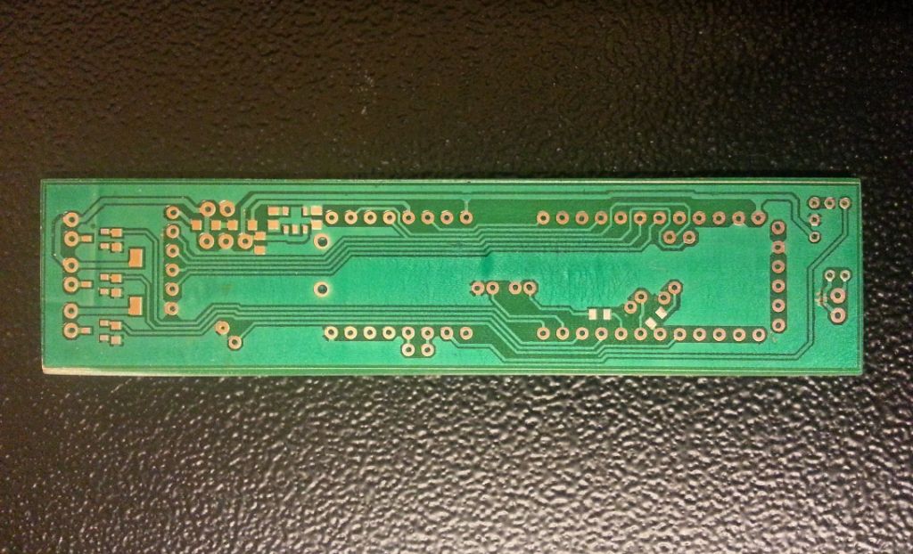

Canobi
Someone say cake?
Shame the routing is off but at least I know they come out ok.
Protonerd
I put the 10k gate resistors on as a precaution but if they're not essential then I'll ditch those as well it'll help to simplify hand soldering.
I would definitely implement that precaution. Arduino PWM capable drivers only have pull-ups, but for low-sides we use n-MOS. If the resistors are not there, as soon as you do not explicitly program L/H (or PWM) levels, the gates start to float. Why it's bad? For one I do not know how the Arduino works when updating the code. Say you program your drivers for low level no keep the MOSFETs calm. Then you start uploading your new code (happens quite often when debugging), and you see the dancing lights on your saber. Same when applying a reset, not to mention that if you want to upload a different code (for whatever reason), your safeguards in the code are not there.
I use 100k, but alas for a LED string saber I have 6 MOSFETs in parallel for practical purposes. Matter of taste, usually in IC's they go not higher than 200k.

Canobi, can you send, or post me a high-con (high contrast black and white image) of your PCB board and its dimensions.  I'd like to make a 3D model of it, and then create a visualization of how it could be applied directly to a battery system. i think i can make a Hi-Con,.  if you could tell me the lxwxh, that would be sufficient.
image attached.  the white paper would be the cake.
stinky1
JakeSoft
Yeah, I'd still go with what I said before. Leave the traces in but it's not a big deal if you don't put the resistors there. My code is tight about ensuring outputs are low when they are supposed to be, but having the resistors there allows you to be more sloppy with your code. I'm a software guy, so I'm always going to look for the software solution. Others my have different inclinations.
I'm pretty sure that at least on the Pro-mini, the outputs all go low during programming. At least, I notice that all of my LEDs I have wired to outputs will turn off during SW upload when working on my breadboard. I never see the "dancing lights" because I put my kill key in when doing in-hilt uploads to my MCU anyway.

Protonerd
Point taken and I agree. If no smd resistors are used, they can take up a lot of space for what they are good for and every inch of space is precious in a saber. Well, I'm no software wizard like you JakeSoft, so I need the precaution. Yeah, I think sloppy might be the right term for the code I write in C, but I keep improving :) but I really enjoy the hardware challenge!
ryang
Not to worry, the board stands at 24.42mm which accommodates many different routing options so there's actually no need to make it any wider.
Just wondering about this...  How high is the board ending up after mounting components?  If it's too high, it won't fit in a 1" ID.  Leaving ~1mm clearance doesn't seem like enough.
What are the dimensions of the Arduino being used?
billpealer
absolutely,  plus every mm or so up, you loose a mm in width, as is the nature of a dome or 1/2 cylindrical enclosure.  i had to abandon a buck boost module due to the chunkyness of its caps and induction coil.. all mounted at the board's edge.  now i use a smaller,..  flatter model.  i have gotten better at soldering since,. i suppose i could relocate those bits.
The dimensions of the Pro Mini PCB are approximately 0.7" x 1.3" and maybe an .125" thick. more with headers.
