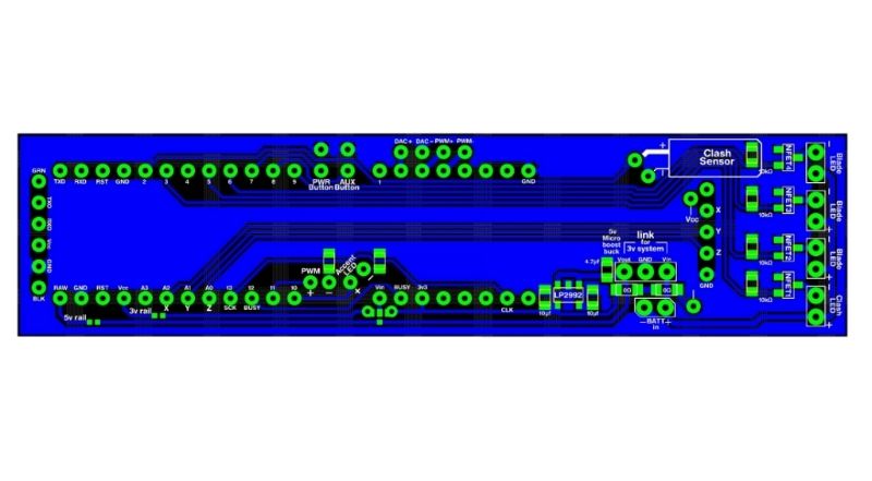

All finished :)
And here's a link to the high res pic as promised:
https://www.dropbox.com/s/e79t2a7bo8ggo4w/Spectrum%20saber%20board%20-%20ADXL%20varient.jpg?dl=0
It keeps getting better and better! I like the placement of the switch vias a lot better now.
Still a few issues.
1) The ADXL335 doesn't appear to have a positive power source linked in directly from any rail. The silkscreen seems to suggest that you intend to bridge it to raw battery power with a jumper maybe? If so, that will blow it up; the GY-61 ADXL335 is a 3.3V device. It needs to be attached to the 3.3V rail somehow and only fed regulated voltage.
2) This will work perfectly for a 3.3V Arduino variant, but will be incompatable with 5V Pro Mini or Nano. That's fine if that's what you intended, but 5V to the RAW pin will not power any standard arduino board. 5V will be under the dropout voltage of the arduino's on-board 5V regulator and it won't work. To compensate for this, you could
A) Bring out the raw pin to a via at the edge of the board and allow for direct battery power to be fed to the Arduino
B) Feed the 5V rail to the VCC pin via jumper as was done with the 3.3v rail.
3) [nit]The silk screen on pin 13 should be "SDA" as it is the one-line serial data, not a serial clock. Same with the "CLK" on the WT588D.
Just as a general comment, I've noticed that the power rail design meant to widen compatibility is adding some complexity that might be avoided if you simply made two distinct versions of the board.
the Nano has a 3.3v rail.  3v3pin..
"The 3.3V regulated output is able to supply 150 mA"
CrossRoads
I believe the 3.3V on a Nano comes from the FTDI chip, and is only capable of 50mA.

JakeSoft
Oh? Good info. I don't think I've ever actually tried to use it on my Nano.
I once tried to power my WT588D purely from the on-board regulator of my 3.3V pro Mini (an official Arduino board too, not a cheap clone) and I don't think it can source enough current to operate it properly either. It did work, but the sound would crackle and cut out once in a while. I got the feeling I was pushing the limits.
I wonder how much current those pro-micro boards that were posted earlier can source.
