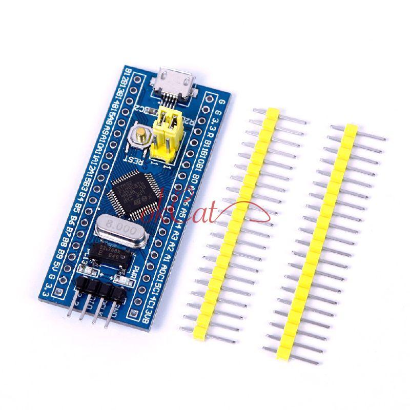

Unfortunately it looks like these boards
http://www.ebay.co.uk/itm/High-Quality-STM32F103C8T6-ARM-STM32-Development-Board-Module-For-Arduino-Tool-/251621420724?pt=UK_BOI_Electrical_Components_Supplies_ET&hash=item3a95ce2eb4
Don't appear to be immediately programmable via USB.
I tried all permutations of the jump links but it doesn't seem to make any difference - the USB just comes up as unrecognised device  and no hardware ID's are shown,
I suspect they are just put there for developers to use to allow configuration to be read, i.e if the board had a boot loader
I will check later to see if Linux e.g. lsusb shows anything.
I'm going to order a couple of leaf mini clones as well as waiting for my jtag programmer to turn up.
I suspect it could be possible to burn the maple bootloader onto this board, but as it only has 2 buttons, But perhaps it could be changed to use the jump links (assuming the source is available)
Or perhaps there is another more Arduino compatible that could be used e.g. something like the Due boot loader
Anyway, I guess I need to wait for my JTag / STLink programmer to arrive before I can do anything with these boards

Taking @WestFm's advice, I've managed to communicate with my STM32 board (that looks a bit like a Maple Mini) i.e
But I can only get serial to work.
I have tried the 2 boot pin links in all positions and I although a USB device appears, regardless of Link settings, it just comes up as unknown device on Windows 7, and I tried using the DfuSe from ST's website and also the one that mrburnette posted, but neither seemed to recognize the USB device.
I have yet to try it on XP or Linux, so I guess there is a chance one of those may behave differently
Anyway. I did manage to connect to the board using a USB to serial connector which I normally use to program Arduino Pro Minis' , using the ST's "Flash Loader Demo"
However all I've done so far is to see if I could download, and unfortunately I have a driver issue with my USB to Serial which causes Windows to crash into blue screen sometimes, which us what happened using the Flash Loader.
So I guess my next step is probably to see if I can upload the Maple Mini bootloader onto my STM32 board.
So I'll post to the forum and update if I manage to do that
Edit.
Just uploaded Maple_mini_boot.bin to the board via serial, and the board is now reporting as Maple 003
Hardware ID's
USB\VID_1EAF&PID_0003&REV_0201
The next step will be installing the Maple driver on W7. I better download and install the Maple IDE and see how things go.
Hopefully W7 will not be as much hassle as W7, but I imagine that there are similar driver signing issues :-(
Edit 2.
I have the same driver signing issues with W7.  aarrggghhh.
Looks like the only way to load the driver is to reboot and temporarily disable driver signing, but its a pain to need to do this each time I reboot.
Also. The board I have, doesn't have the LED on the same pin as the maple board and also doesnt have 2 push buttons, it only has a reset button, but looking at the Maple mini schematic, its easy to wire another led and it looks like i can use the jump links as the push button, as long as I connect PB8 to the Boot0 link.
(Maple has the LED on PB1, it looks like the LED on my board is on PC13)
I'll need to wire up the LED otherwise I can't see it flashing during startup, to work out when to use the jump link to trigger the various USB configs required for the full setup.

I've taken a closer look at the schematic of the maple mini versus the hardware of my STM32 board and it looks like there are some more hardware differences that will prevent it working as a maple mini clone.
The maple mini schematic shows two transistors configured to do something with the D+ line of  the USB.
As far as I can tell the generic STM32 board doesn't have this.
Also the generic board appears to have a RTC device on it, well according to the photo on the vcc gnd website, that's what one 4 pin IC on the board is supposed to be.
If it needs 2 transistors etc in order to work with the maple driver, I will probably not bother adding all other components, and instead just use the boards with some other dev system e.g coocox.
But I will try just adding the led and connecting the other line to boot0.
I have 2 of these generic boards, so I'm also going to try to get hold of the USB bootloader that is supposed to be installed on the STM primer boards, and put that bootloader on my other board, so that I can flash using the ST USB uploader, rather than needing to use Serial.
I'm not sure if coocox works directly with the ST USB bootloader, but I also have a Chinese clone STLINK module in the post, so I will be able to get these board fully working sooner of later
Edit.
I connected a LED to PB1 and it flashes as expected, given the firmware is for the Maple mini. However I was unable to get the board to go into DFU mode.
I soldered a wire between PB8 and my Boot0 jump  link (is the jump link in the center of the board), and followed the instructions,. on the maple wiki, which basically pull boot0 and high while the led is flashing quickly.
But I couldn't get it to work.
The wiring of these generic boards has 100k in series with boot0 and the jump link, and I was unable to directly solder PB8 to Boot0 on the IC without damaging the IC. (I tried a few times but you would need a microscope to do it successfully)
I also tried pulling PB8 to 3.3V via a 1K via a push button, in case the issue was the 100k, but it didn't make any difference.
Also unfortunately i managed to snap the connections to the micro USB whiile trying to press and hold the button and move the jump links etc.
Fortunately, I managed to re-flow the solder back onto the USB pins
But I think i'll need to give up using these generic STM32 boards as a Maple Mini, because its possible that in order for the DFU mode to run, I'd need to wire in the 2 transistors that are connected to D+ and I'd probably damage the board doing that :-(
I'll have to wait for my other Maple Mini clones to arrive in the post in a few weeks
