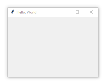

I will now create a simple Python script (2 buttons) that will:
- Launch Cube Explorer
- move the cube, face by face, for color recognition by Cube Explorer
- request and obtain the solution from Cube Explorer
- transfer this solution to Arduino

It's python's time folks     :)
Python is a nice language when it's comes to produce small utilities and middlewares
For the moment, I just implemented the "Arduino side"
this program accepts a string and transmit it to Arduino, through the serial port
in same way as Arduino Serial Monitor in Post #18
This is Rubik kasBot V1.13 (May 2017: change software versioning )

EDIT:     getting started (April 2017)   ---------------------------------------------------
install Python 3.xx
install tkinter (graphical UI)
install pyserial (Serial comm)
now... do your home work  ;)      (this thread is not a Python tutorial)
       ... and run this basic "hello World" test program:
Code: [Select]
## Rubik (Hello, World)             @ kas 2017
from tkinter import *
import serial, time
from serial import SerialException
import atexit
import subprocess
root =Tk()
root.title('Hello, World')
root.geometry('300x300+200+200')          ## window size + position
root.mainloop()
See the window ??  you are all set
