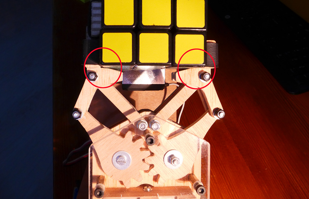

#359
Sep 02, 2017, 12:26 pm Last Edit: May 15, 2018, 10:13 am by kas
benbowman,
Make sure your hardware is 100% tuned before fiddling with color recognition
You will save a lot of frustration  ;)
Your grippers are possibly too far apart
Cube should really sit on the base of the claw
Try inserting four washers between each servo and frame and see for yourself
You may also increase gripper closing by 1mm, by adjusting
  #define  BACK_CLOSE     and  #define  DOWN_CLOSE
What Arduino sketch version are you using ??
Quote
i think this is because the claw scans in the wrong direction?
To change rotation direction, invert values for both servo's
  #define    DOWN_CW                 9   --->  172
  #define    DOWN_CCW           172   --->      9
  #define    BACK_CW                  2    --->  171
  #define    BACK_CCW             171    --->     2
(use your own parameters)
