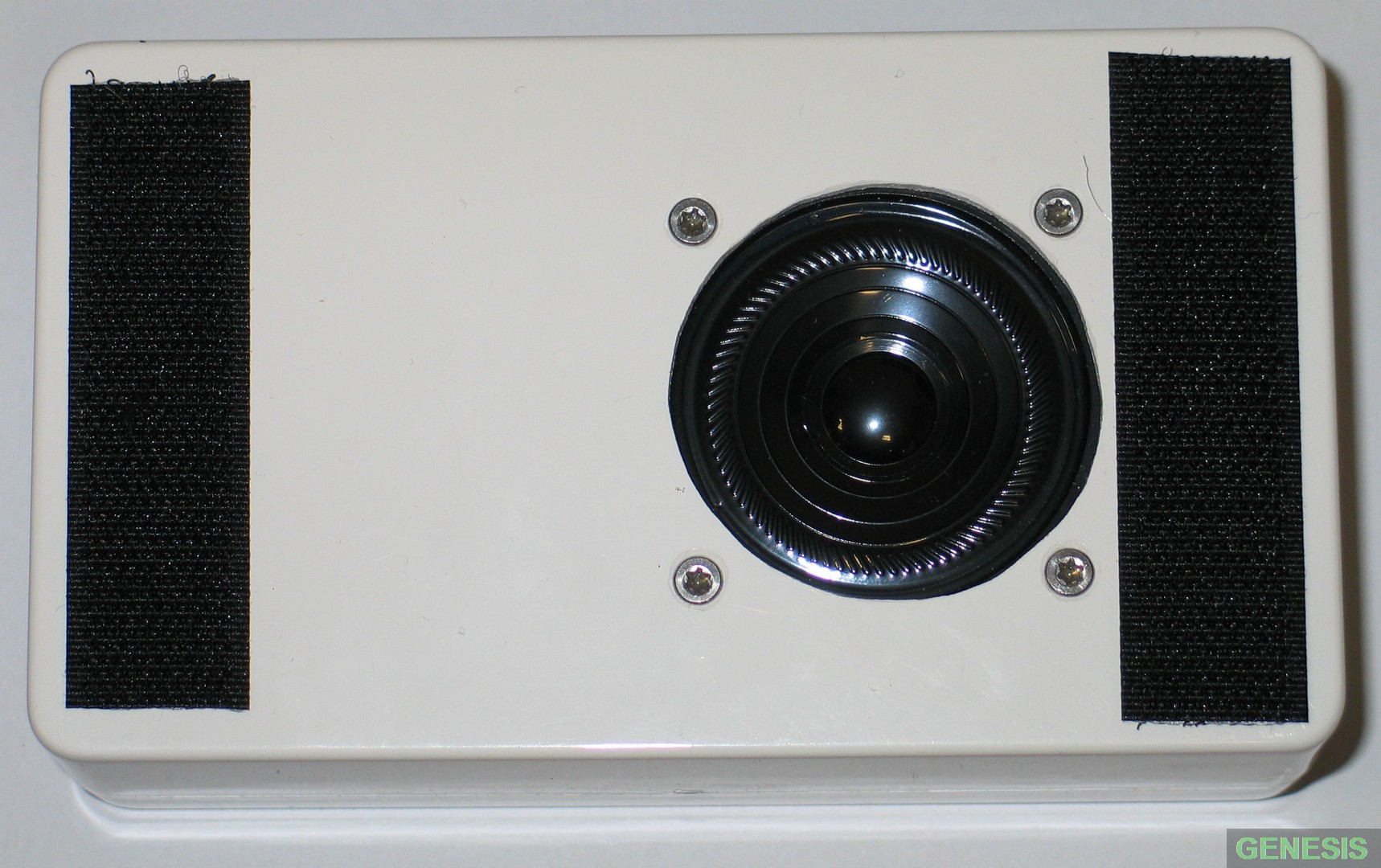

well a little useless but fun project based on a private joke between friends.
As fans of HL1 we made joke about the FX in the game applied in toilets....never bet with me xD

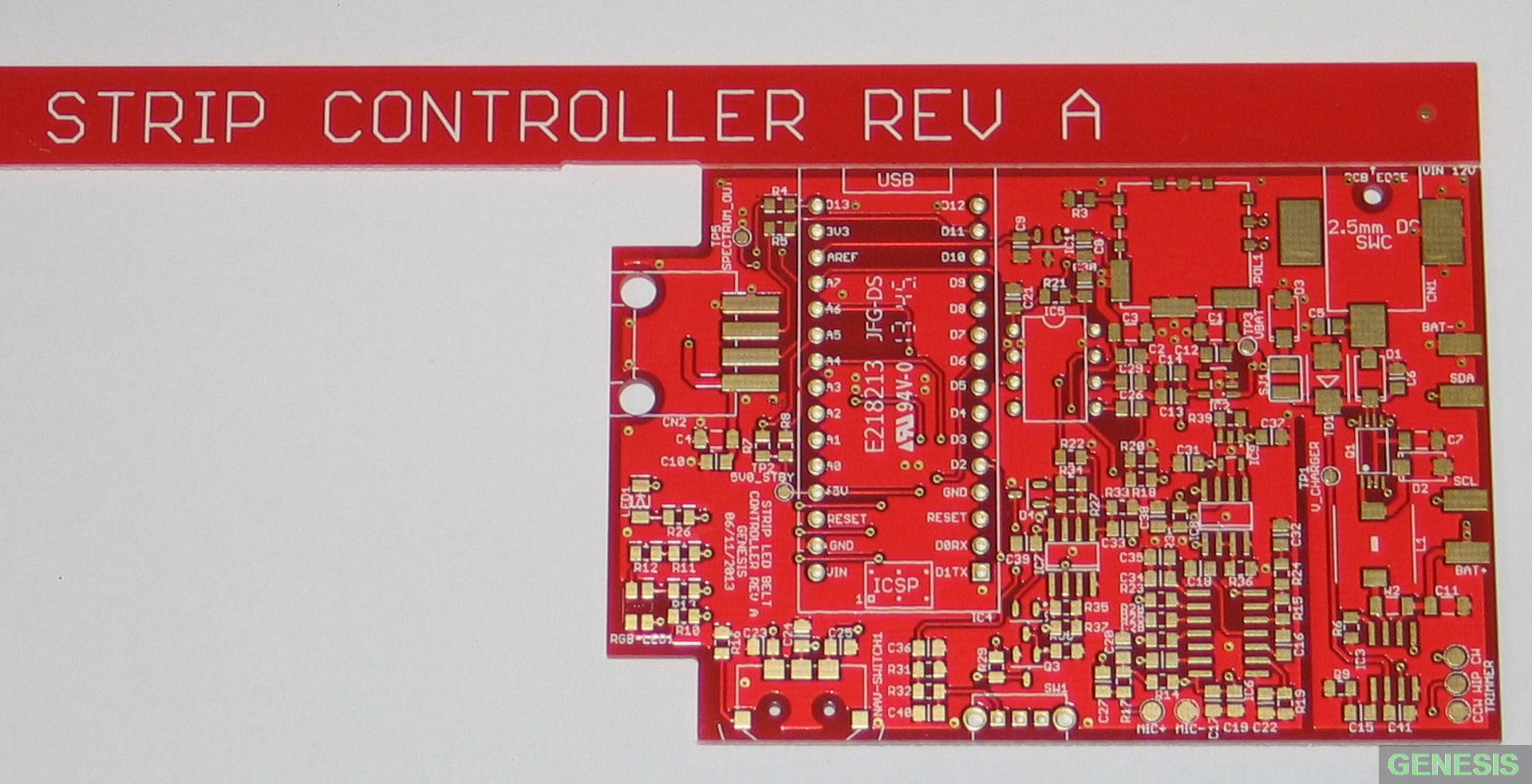

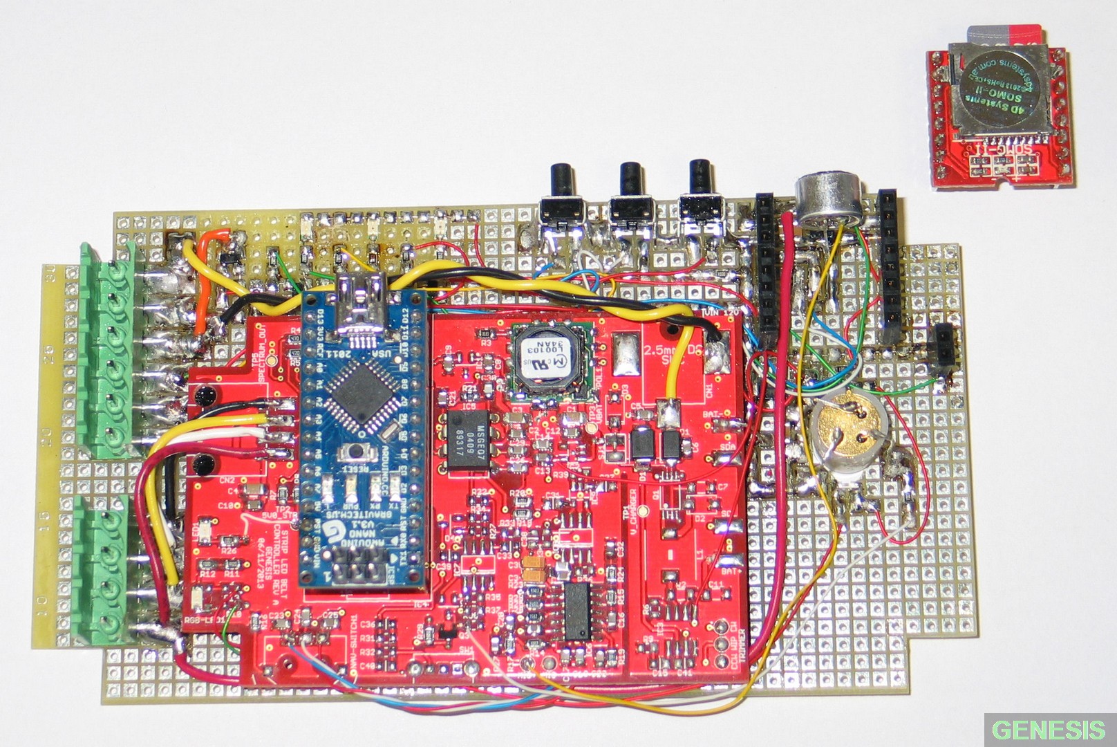

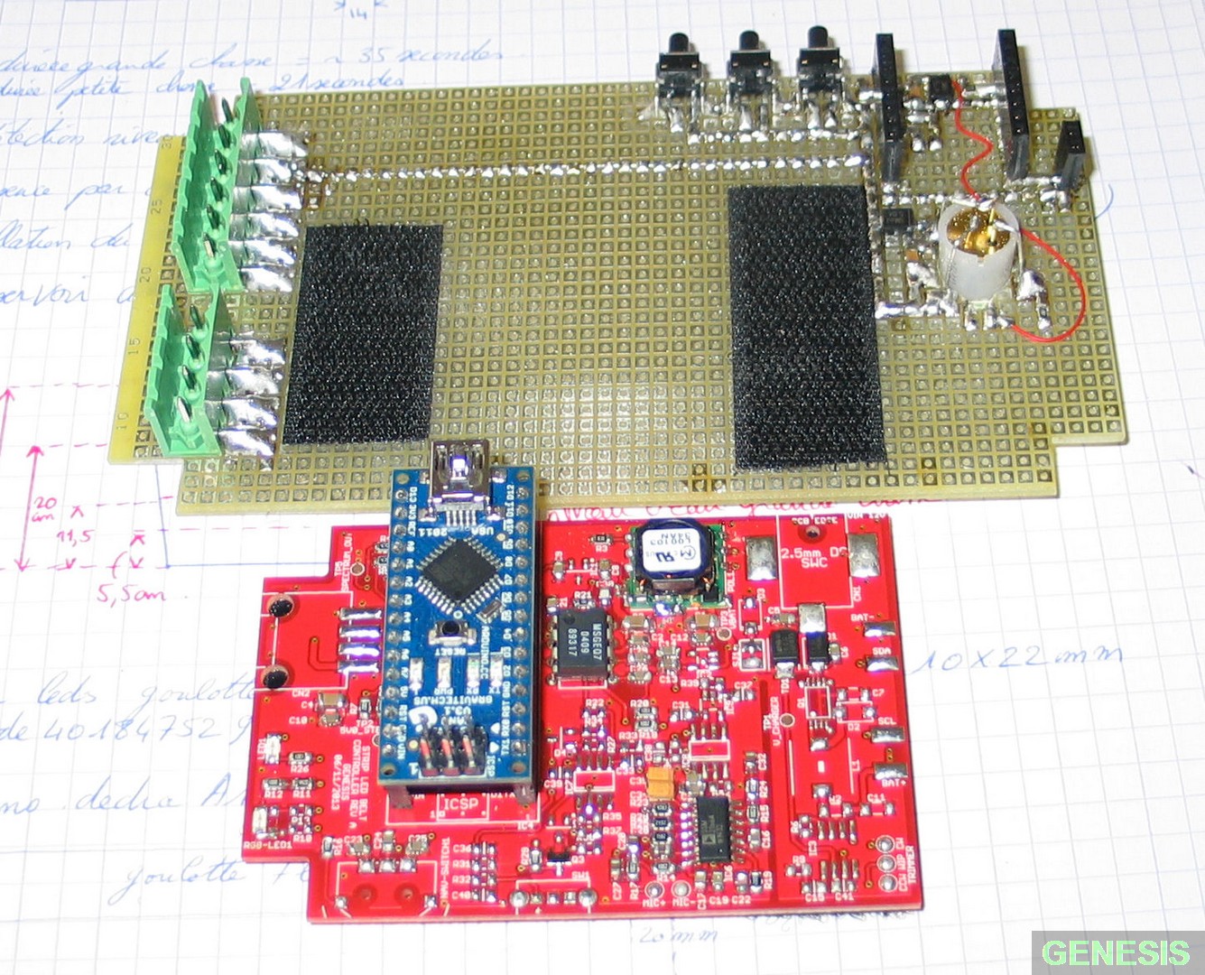

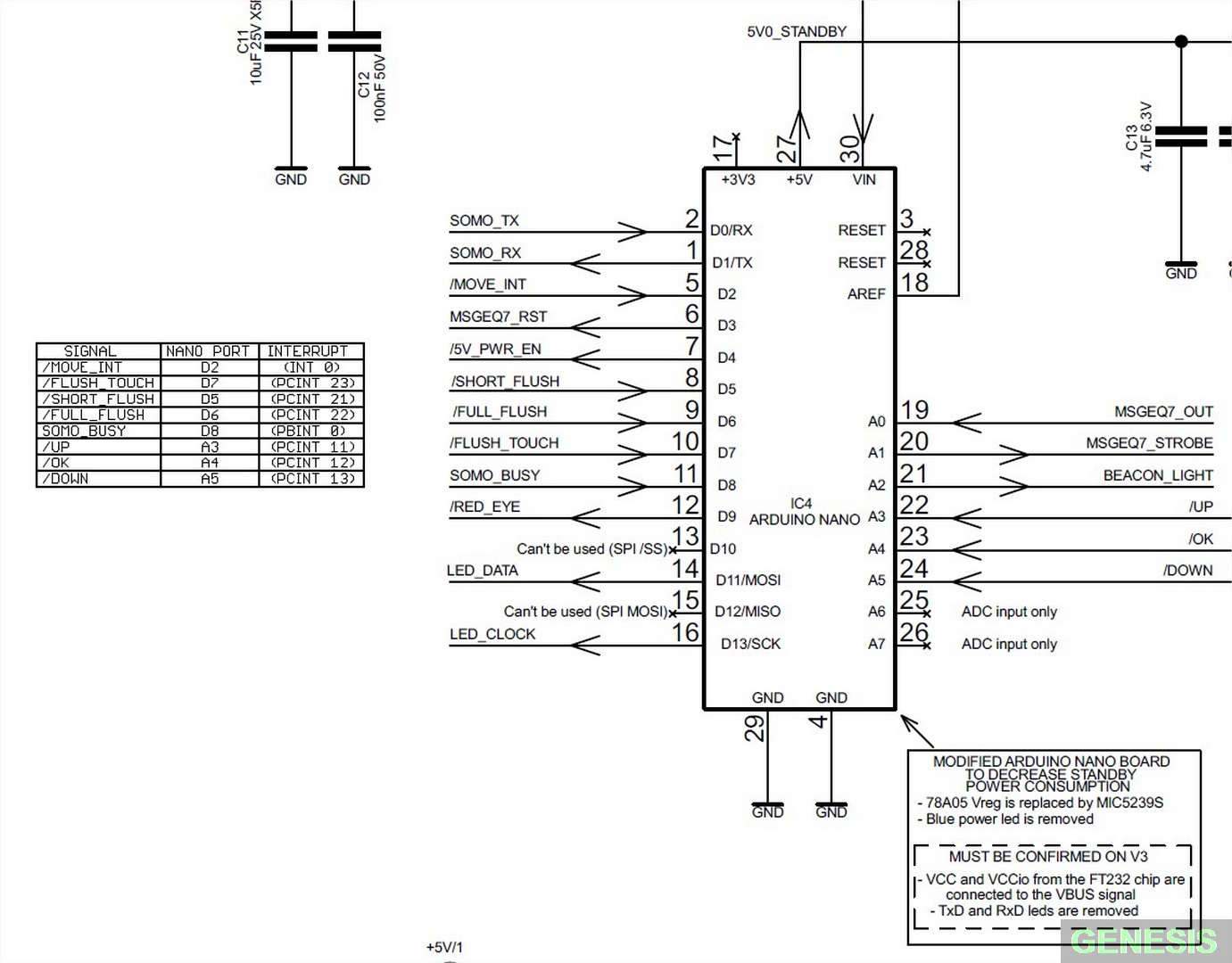

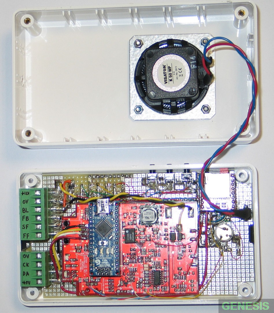

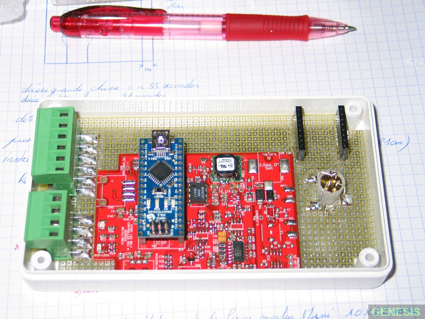

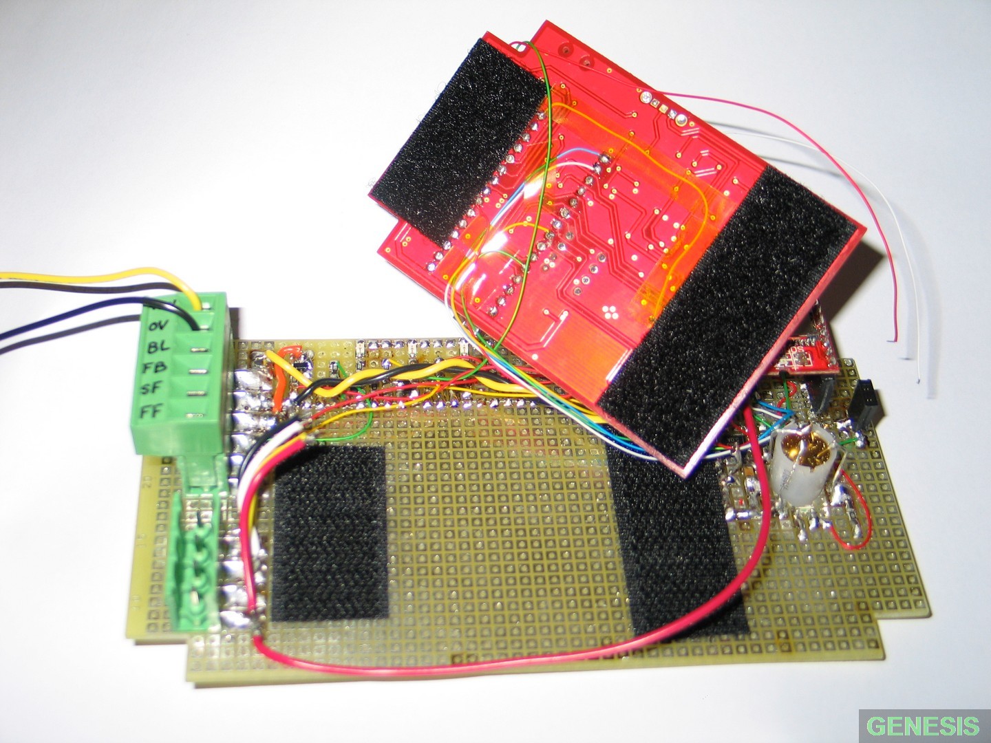

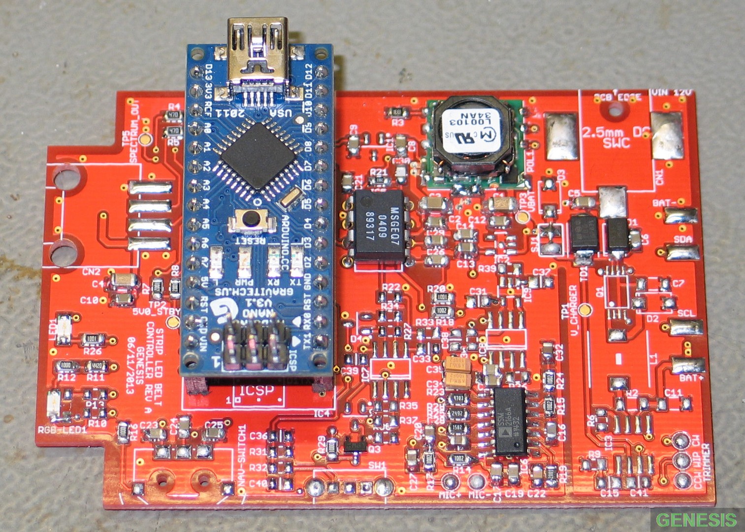

The system is based on my led controller board wich includes an automatic gain amplifier + spectrum analyzer chip MGSEQ7.(perfect to sense ambiance "noises"
the nano board is the heart of the system.
this project has no other function except for fun.
it includes

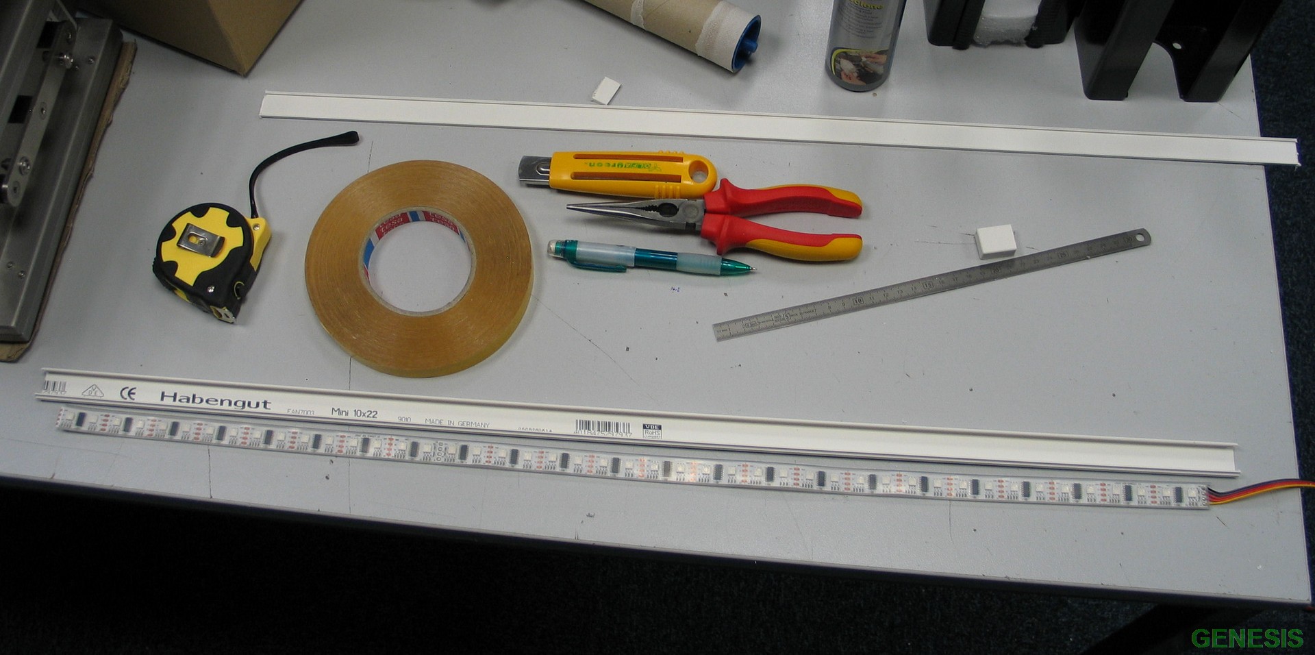

- 46 RGB leds with LPD8806 controller
- 1pc beacon light (with rotary motor, I did not want a standard flashing model)
- 1pc 4D system SOMO II MP3 files player (I've make my own library because I find nothing on the net for it) the audio files comes from the Pak0.pak from HL1 game
- 1pc proximity capacitive sensor to detect when the finger approach the flush

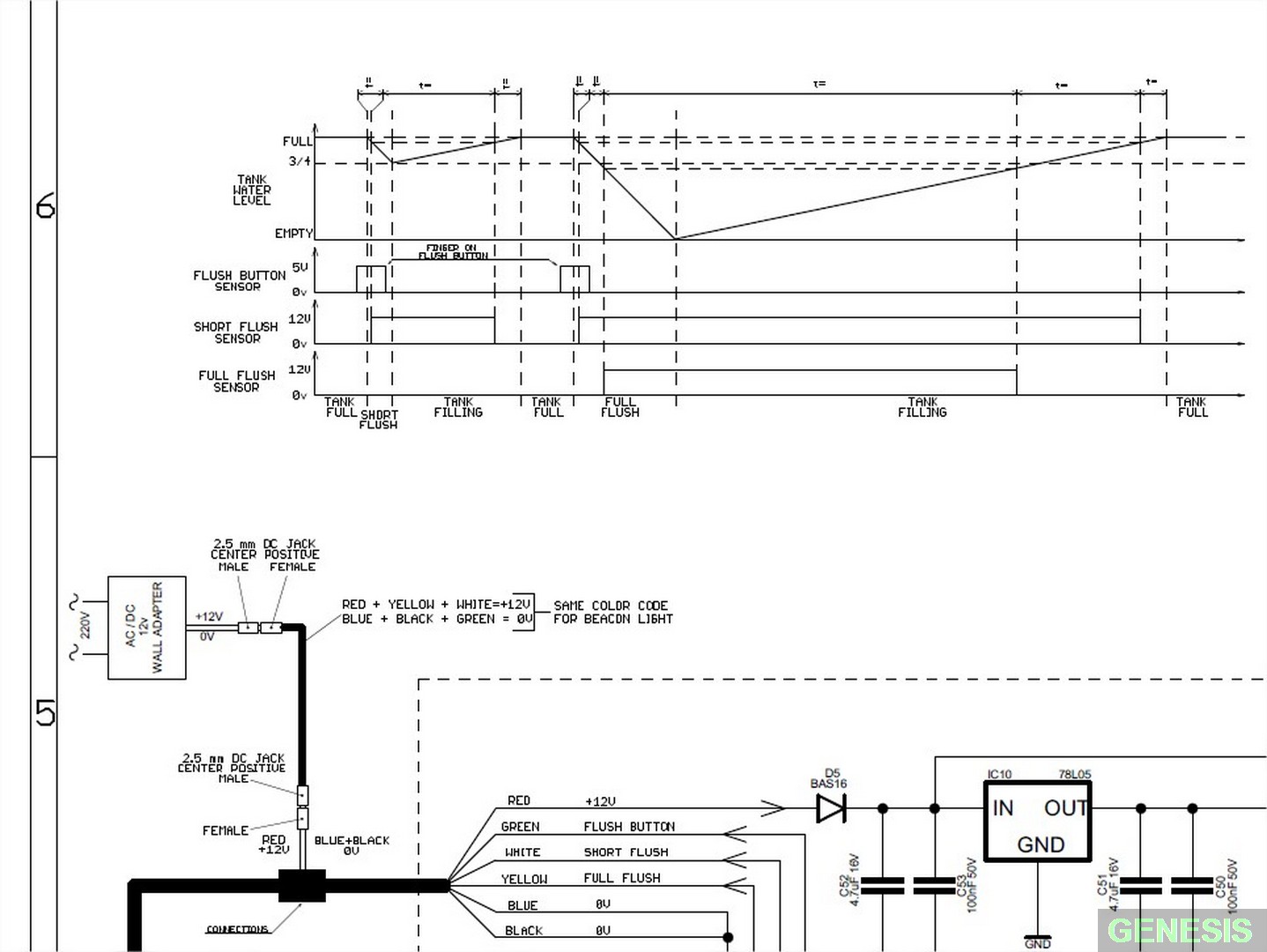

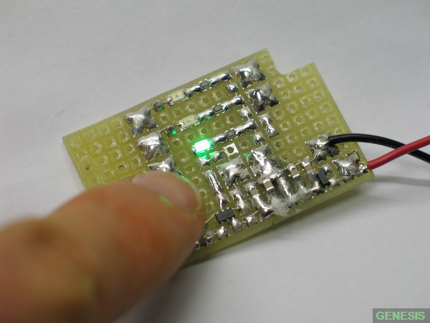

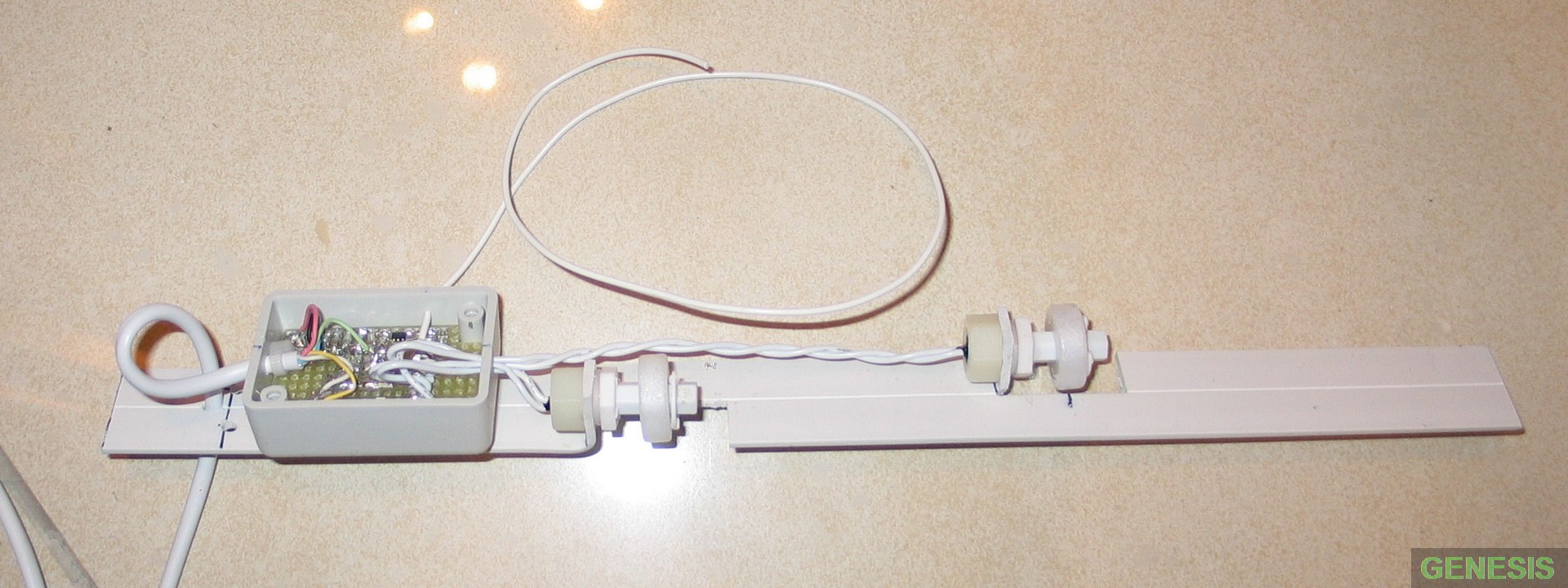

- 2pcs floating level sensor to know if it's a short or complete flush

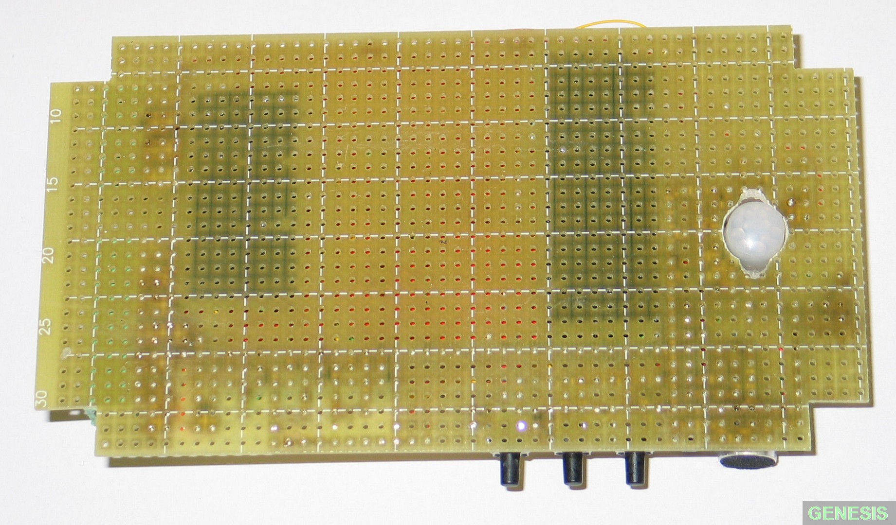

- 1pc PIR sensing detector to know if someone is approaching
I've built the system to have a very low idle power drain (even if the nano is not built for that I've make some modification on it) and the overall current drain is only 400µA
ok I'm not a pro of the software and the code was made in two days for test my hardware but now I can work further on it xD
here some pictures :)

Awesome. How does the system detect you are about to flush?

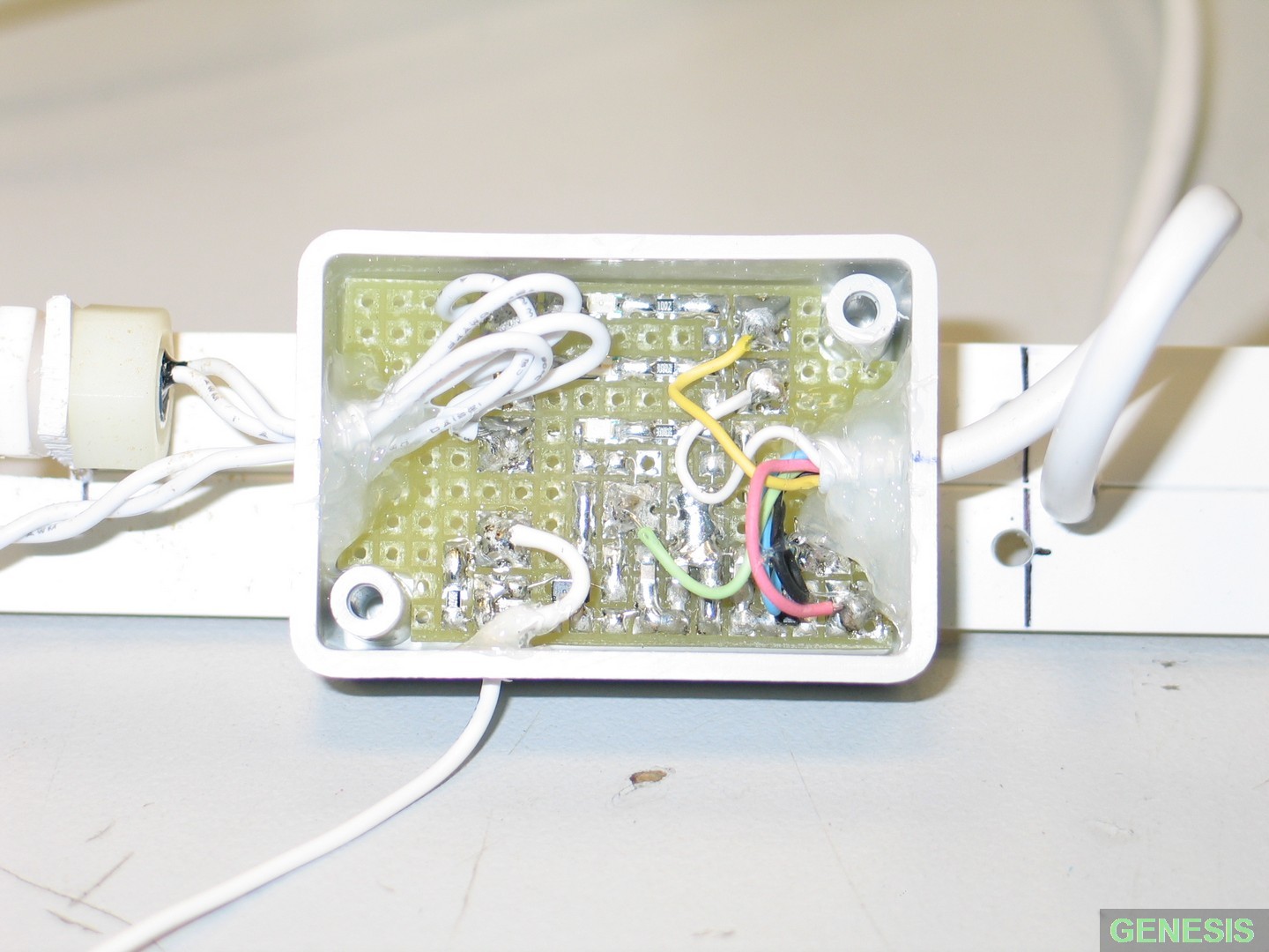

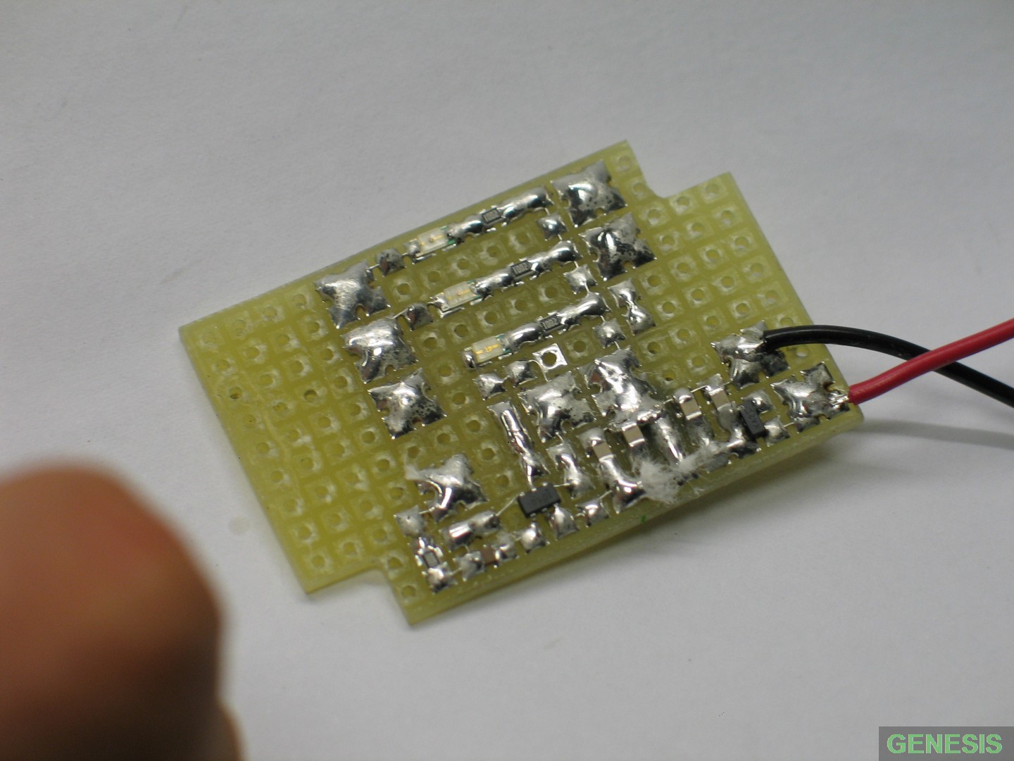

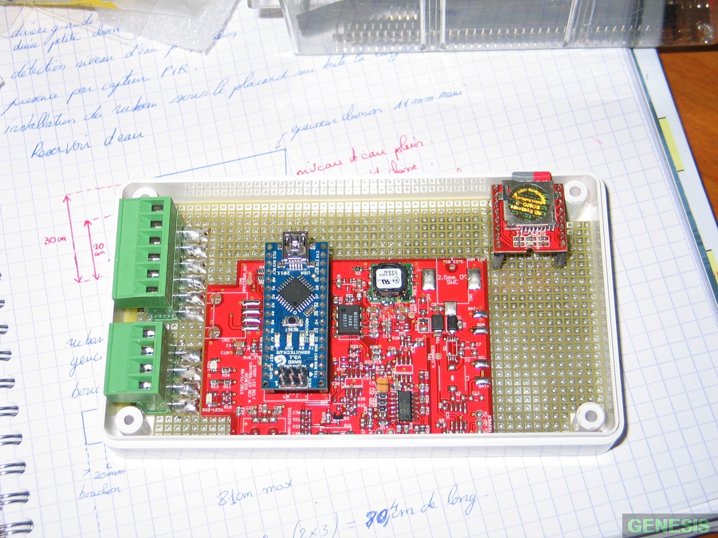

The flush button is connected to a capacitive sensor chip an AT42QT1010.  :smiley-mr-green:
it's the small SOT-23-6 chip on the picture with the green led on. it detects my finger ;)
the sensing electrode is the white wire from the little white box with level sensors.

DevonMiles
Hi, nice project! I' m trying  to use MSGEQ7 in my project and I would like to take the sound from a MIC. Can you post the preamplifying part fot the MSGEQ7, please? I' m using the configuration below.. but I don' t know why 3 of my 4 chips doesn' t work. I don' t understand if theese 3 chips were already burned or  there' s a mistake in my scheme. Thank you!
Genesis92
your schematic seems to be good. are your sure about the pin counting?
the electret microphone is connected with the right polarity?
the ground is connected to the ground of the msgeq7?
I can post my schematic but it use an automatic gain amplifier from analog devices in SO14 package  so it will be expensive and hard to solder for your application I think. But if you really want it I will post it.

raschemmel
tmd3
I ... use an automatic gain amplifier from analog devices in SO14 package ...
I'd like to see it.  Can you show us the schematic, and tell us the part number of the device?
raschemmel
Page 2 of the MSGEQ7 shows the peak Vin = 100 mV ac p-p. I think your are swamping your input and there is nothing wrong with the chips.

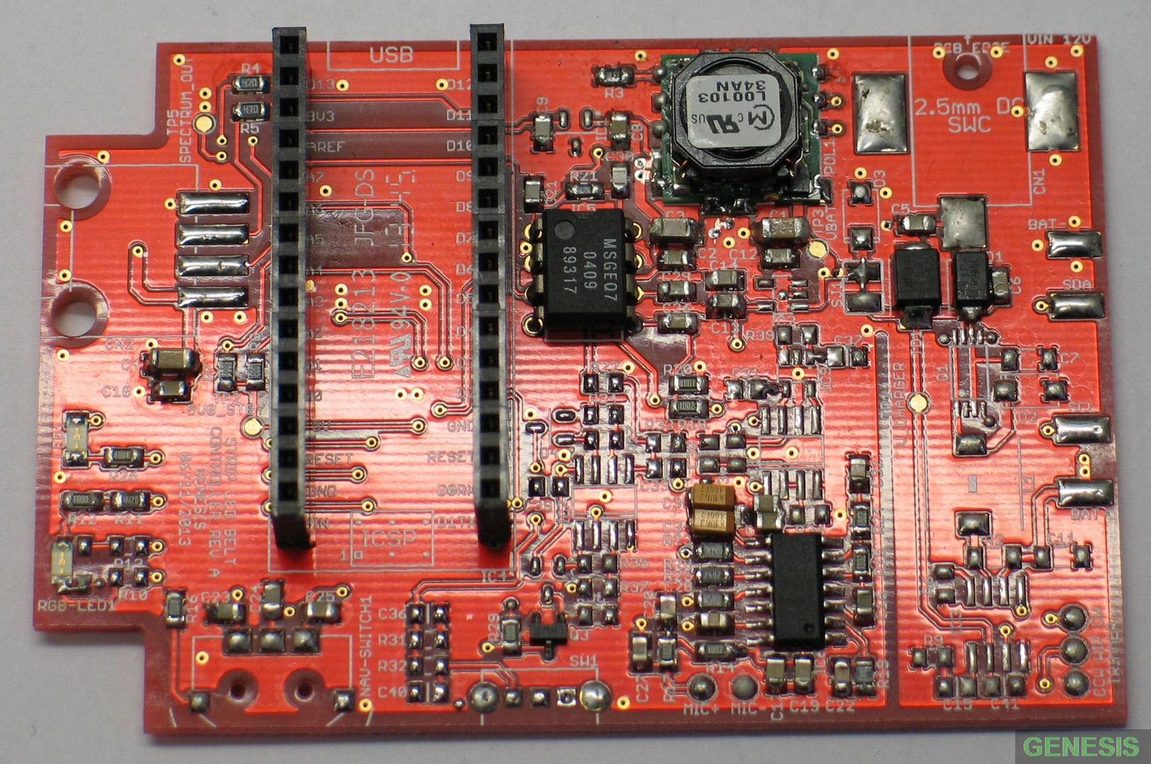

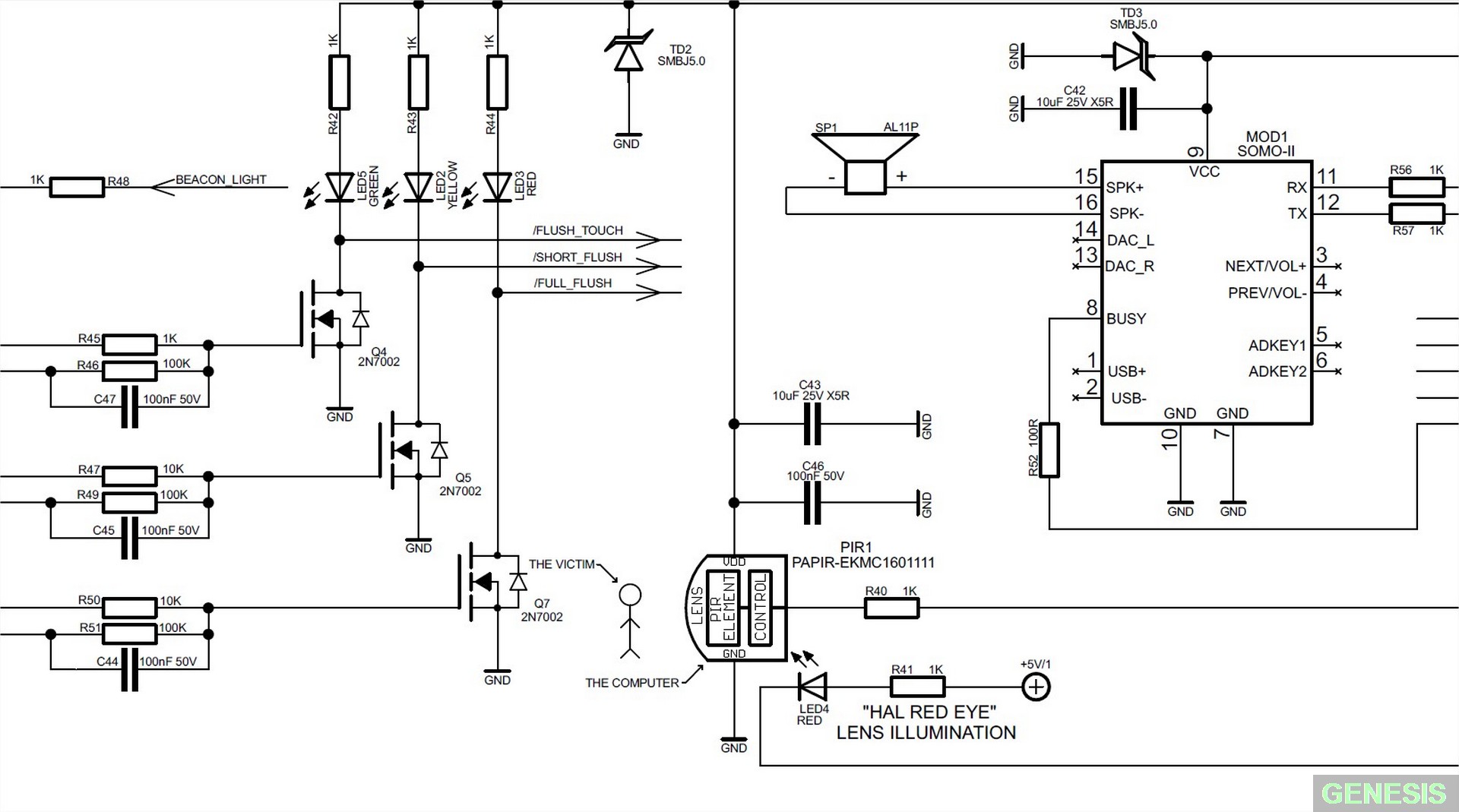

Tmd3 the circuit is an SSM2216 you can see it on the third picture.

DevonMiles, simpply modify the amplifier feedback (R3) resistor to decrease the gain.
1+(R3/R4)=1+( 1M/100k) = gain *11
