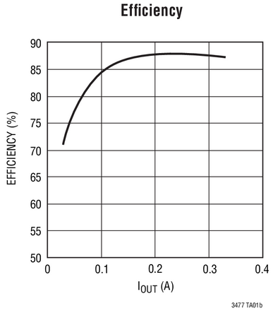

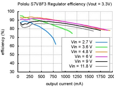

I am looking for an efficient way to power a Microprocessor with a 2S LiPo. So this power converter should be very efficient transforming 7,4V to 3,3V with relatively low currents (~10mA).
When I look at the datasheets of power converters they often don't cover this area (~10mA).
Does that mean then don't work there at all - or are very inefficient?
LT3477
Pololu S7V8F3

I did a little poking around on Linear's site.  They have a lot of switching regulators to look at.  This part looks like it has a better chart and shows currents in the area you are talking about.  http://www.linear.com/product/LTC1474  The LT3477 seems more aimed at higher current applications like something with a lot of LEDs.  Have you done a switching regulator before?  I've only done two so far.  Some people have said they are finicky about layouts.  Both worked for me.  The definitely require more external parts than a linear regulator, though.  Hopefully a real expert will chime in soon.
