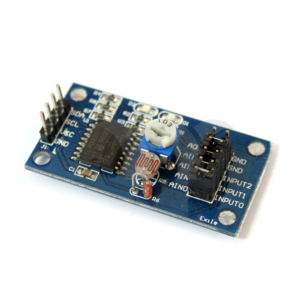

Solved 7/6 - The solution was to remove the pull up resistor on R2.  Now voltage is @ 5.3 max
I purchased a PCF8591 DAC-ADC dev board from ebay: http://www.ebay.com/itm/221783164880?_trksid=p2057872.m2749.l2648&ssPageName=STRK%3AMEBIDX%3AIT
And the wiring diagram for the board:
I wired it up using the below as a guide from Adafruit:
I then used the triangle wave code posted @ http://tronixstuff.com/2013/06/17/tutorial-arduino-and-pcf8591-adc-dac-ic/#comment-199583

It works fine, but the voltage when measured on the VCC, SDA, or SLC pins are all 5.2V, yet when measuring @ VOUT the voltage maxes at 4.33V.  Even if I hadcode
Code: [Select]
Wire.write(255);
 which should be the max, I still get 4.33V.
My thought is that something is not right with the vref pin since it's my understanding that's what sets the max.

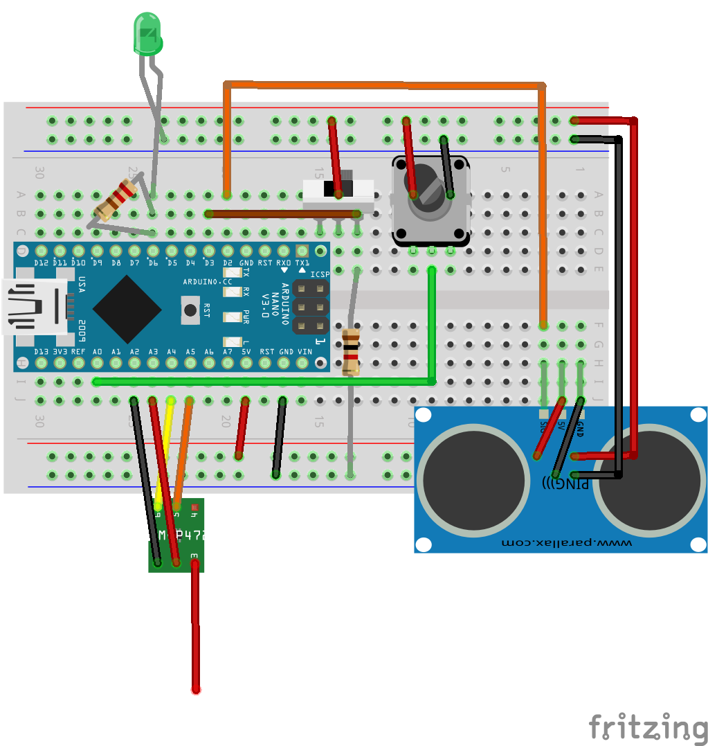

Here's what my setup looks like:
Ignore the PING((( sensor and LED as there for another project.  Which still works as designed, but maxes at 4.33V.  The picture shows a LittleBit bargraph and number module as this is part of the other project I'm working on.  But I did measure with a multimeter as well for the above #s.
Ignore the MCP4725 DAC on the fritzing image as the outputs on the PCF8591 are very similar if not the same.
Any thoughts on whats going on here would be greatly appreciated!

Datasheet (page 14.2) states VOUT  from Vss to Vdd with no resistive load, schematic of module shows VOUT connected to LED and 470R resistor so that is drawing 4 - 5 mA. Can you easily disconnect the LED and see if that lets VOUT get up to VDD ?

I was looking at the schematic of the PCF8591 and the picture above it in your first post, the schematic shows D2 connected to AOUT thru a 470R resistor. The third pic shows the PCF8591 board with both LEDs burning, the fritzing diagram shows MCP4725 but no PCF8951. Which board do you have?
I was referring to this datasheet.
http://www.nxp.com/documents/data_sheet/PCF8591.pdf
shaiss
I have the pcf8591 as a breakout board.  It's the first picture
The second picture is the breakout boards schematic.
The fritzing diagram is my setup.  I used the mcp4725 image as fritzing library doesn't have the pcf8951.
If your looking at the breakout board, I suppose I could cut the resistor, but that doesn't make much sense.

This past haa a similar issue to mine where vout is 85% of vref.
https://brainfyre.wordpress.com/2012/10/25/pcf8591-yl-40-ad-da-module-review/
Quote
My tests show another frustration: A lower than expected analog output voltage. For a 4.88 volt supply the output is only 4.17 volts (85%) at maximum value setting. Since the maximum supply voltage is 8 volts, increasing the supply to 6 volts may get a 5 volt result.
shaiss
According to the schematic @ it appears that there's a 470 ohm resistor on R2 going to the D2 LED connected to AOUT.  My thought is that it's this resistor that's lowering the AOUT from 5 to 4.2.  I'm going to de-solder the pull up resistor when I get home and we'll see if the issues resolved.
shaiss
My suspicion was right and it was the R2 pull up resistor that was causing the drop in voltage.   Project moves on now!!!
