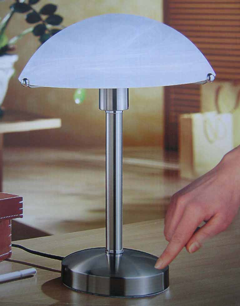

Hi, i have some touch lamps that i don't use anymore, i would like to make a quick hack to make this web controlled. I know that there are examples to make a normal lamp into a touch activated lamp, but i don't know where to start to signal an existing touch lamp to activate, so i would like to know if someone did something similar with this, i tried to just earth the metal chassis of the lamp to the earth of the power strip, but this doesn't seem to activate it, and i didn't want to  try applying any voltage to it before seeing if there was someone who knew how to do this.

It seems i was a bit too hasty, i retried the grounding with a better cable, and it does activate it this way.  :)
Gambituk
Hmm, i thought it was straightforward after figuring out that grounding would do the trick, but thinking about it, how can i use an arduino to ground the lamp. I guess i would have to use a relay or something similar to connect it to ground?

Well, i figured out that the touch lamp can be turned on by grounding the chassis, the exterior of the lamp. But i would like to use this fact to make it controlable by an arduino. I know how to send a 5v signal from an arduino, but how can i send a signal which is either ground, or open circuit?
Is there any ideas or suggestions? i would like to repurpose these lamps to make them controllable thru network/internet.

Well, my question is quite independent of the electronics, in fact, i am trying to avoid going into the electronics too much. I want something that i wont question is electrically safe, so i want to find a solution that doesn't open up the electronics. I'm not asking for an astrological prediction of what the answer might be, i've tried to restate my request quite simply.
Perhaps you've never heard of a touch lamp
It's a lamp that turns on when you touch it with a part of your body (i assume any part will do, but i've only tested with my hands)
Here is a picture.
I realise i've broken some unwritten rule by failing to ignore your sarcastic and condescending remarks, and i'l probably not get any sensible responses now, but that seems to be what is already happening, so i might as well include a picture of an arduino, just incase it helps.

Oh, i though you had it taken apart.
To make the touch circuit work properly, i would try getting a relay-module like this: relay
Connect the relay between the body of the lamp and a ground connection, and see if it works.
