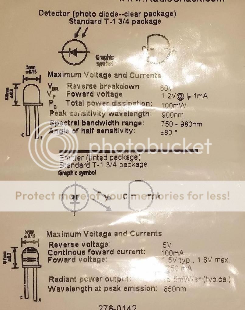

Thank you for all the info. SOrry I haven't been back. I'm way busy with work right now, and this arduino stuff is in support of my rc habit, so it get's second seat when .  Actually, my heli is broke and i'm trying to build the tach so I can give it a proper diagnosis when switching out components.
Anyway, here's the product package for the set i'm using (I left it high res on purpose, sorry for the inconvenience)
I'll report back if I figure it out.
Thanks, again!

Your pic didn't upload. Too big maybe?
Please do not PM me for help. I am not a personal consultant.
And others will benefit as well if you post your question publicly on the forums.
interestingfellow
Yes, it was too big, and then I exceeded my post count or whatever...bleh. Here it is.

It's not a photo-transistor - it's just a photo-diode, with bad labelling on the pins.
nowhere on that package does it say "photo-transistor", (it does say "photodiode"), although for some obscure reason they've seen fit to label the pins "C", "E", instead of "A", "K".
Didn't you notice there was no photo-transistor symbol on the pack, only two diode symbols?
The "Vf=1.2V" also gives it away. :D
And the flat side is the cathode, as with all diodes. (Ignore the "C" "E" pin labels - they're wrong!)
So, before more time is wasted on this, and before you buy any more parts not suited to your purpose, what's the intended final purpose of the IR LED/IR detector? Remote-control, obstacle avoidance, etc ?
Chances are you'd be better off with a demodulating receiver anyway.
I just went back and re-read your initial post. You're making an optical tacho. So you do want a photo-transistor. You still need to buy one, a 'real' photo-transistor. :)
Here's that package label, cropped to show what's important:-
Also see DaveEvans' reply #18.
(I accidentally partly cut it off when editing, but the part number is 276-0142, same as Dave's.)
