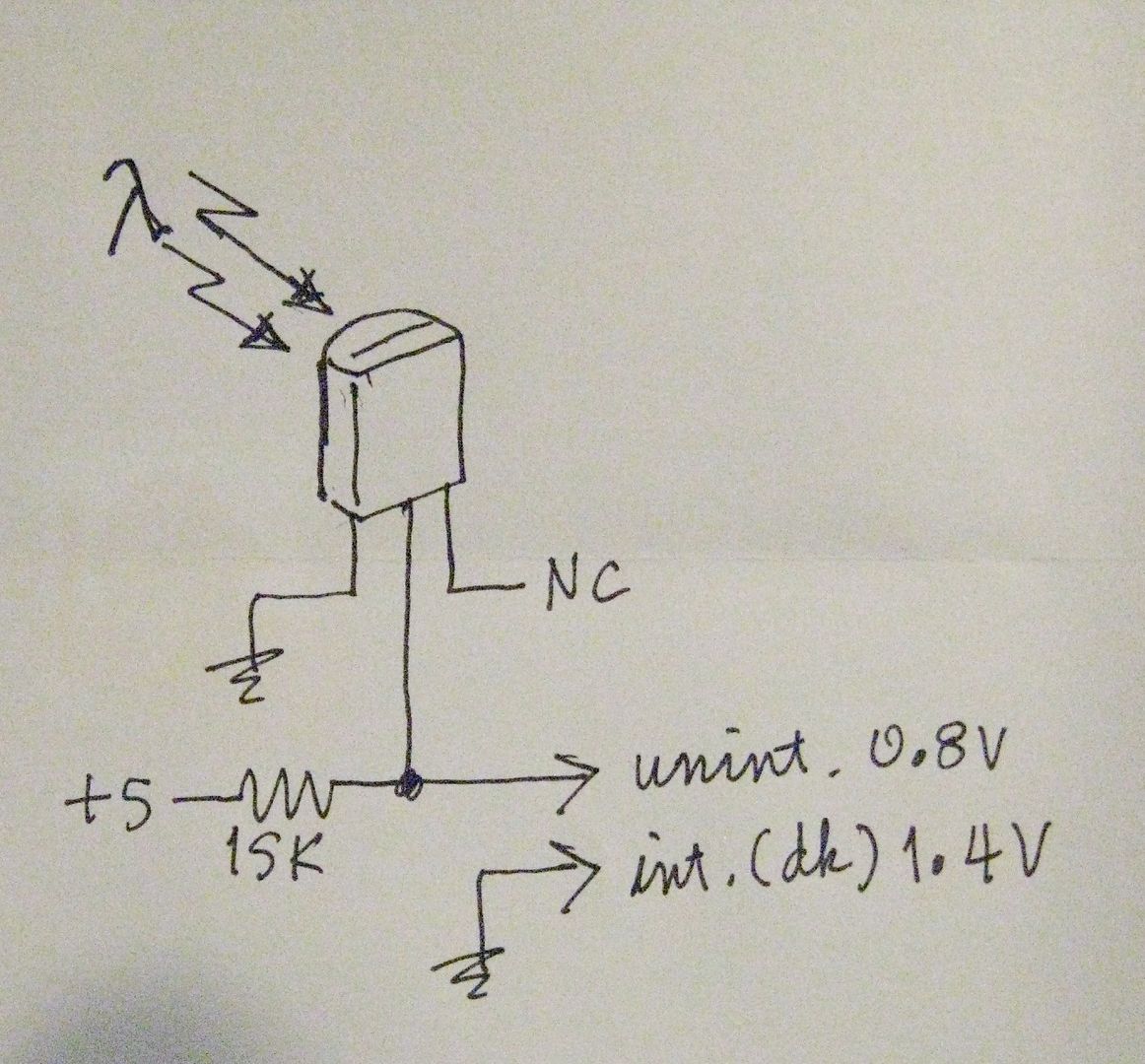

So, here, my "Detector" (as D.U.T.) findings --
I have the IR emitter pretty close to the detector, 0.1 inches or so.
I do have a light on, so that I can see what I'm doing, which influences the results a tad.
Uninterrupted, unobstructed, there is 0.8V at Vout and 1.4V when I interrupt, or obstruct, the optical path between.
If I place translucent material between (esd mylar bag, old pink anti-static bag), Vout varies with the material's transmissibility.

In the dark, I imagine the collector would go much closer to the 5V rail. (When the beam is interrupted.)
I'm surprised that the output doesn't go closer to 0V than 0.8V with them that close together though.
How hard are you driving the emitter? 100mA?

I'm only running about 20mA through the emitter. (The "spec card" states 40mA max for this.)
Changing the Vout pullup to 1kohm: obstructed Vout = 3.9V (also dark, under an old 35mm film holder) and unobstructed = 2.3V

I think that light was shed when it was realised that 'interestingfellow' really had a photo-diode, not a photo-transistor.
There wasn't actually a need for you to show the performance of your photo-transistor and low-power IR LED.
Well, that makes me feel better; I was making a mistake, just not the one I thought.
Thanks, agian, y'all!
(and, no, I didn't notice the lack of transistor symbol, but I won't anymore* ;D )

According to the label, and Dave Evans in post #18, (Edit: concession to 'Runaway Pancake's last post.) it's most likely a photo-diode and not a photo-transistor. I think that's pretty clear, despite what someone else thinks. That's no doubt why it wouldn't work for you, when connected as a phototransistor.
You could make use of it, but you'd get much better performance from a photo-transistor.

I think what I showed in #26 is the way to go (despite "phototransitor" (sic).
Have you tried that, exactly?
[I won't guaranty that "digital-worthy" performance can be had from these components alone.]

Runaway Pancake post #26 is the best start at getting this to work the only problem is hooking the IR whatever the OP has right.
If it's a diode it conducts only when light hits it and backward you still get nothing
I would set it up like that and shine IR light on it and test output nothing then swap it's pins around one way it's going to work.
If it doesn't throw it in the trash and get new one.
Oh and post 26 works for me with radio shacks bagged set.

Yup - looks like my first and second packages. My first one had a phototransistor and the detector in my 2nd one really is a photodiode (I checked recently).
You all do know there are two types of photodiodes Photovoltaics and Photoconductors. And for what most people ask to do the photodiode would be better than a phototransistor. They turn on faster nS where as phototransistors take mS to turn on.
