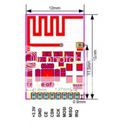

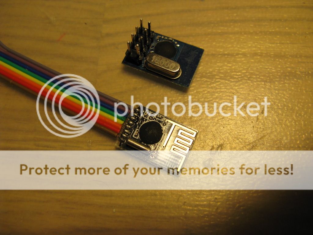

The chip are sold on ebay, aliexpress mm as nrf24l01 or as nrf24l01 similar it looks like this:
The connections on the small ship are the same as the small nrf chip like this:
The connection on the bigger one are also the same as on nrf24l01
