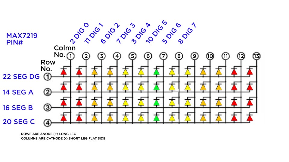

I am finally getting around to building this.
I have breadboarded the LED matrix (ignore colors, had to use what was available):
I am using two MAX7219s to control them as two 8x8 displays, but only the top 4 rows of each (I couldn't figure any other way to do it, is there a better way?).
Yeah.  Use a single MAX7219.
Presently, you (presumably) have seven columns and four rows on the left hand side connected to one MAX, and six columns and four rows on the right hand side connected to the other MAX.  Just connect the second batch of columns to the first, and the second four rows to the other four rows of the one MAX.  You will just have to do a nybble shift and AND to combine the values for the two sets of rows.
I am not sure how to find the voltage and forward current for my LED matrix..?
Ignore it.  Use a 10k and if it is too bright, use the Intensity register to wind it down.  If you only ever want half that intensity, use a 22k instead (which will beneficially reduce your transient current requirement).
It is hard to see, but I have 4x8 on the left and 4x5 on the right (total 4x13).
The rows 1-4 are hooked up to MAX pins 22 (SEG DG), 14 (SEG A), 16 (SEG B), and 20 (SEG C).
The columns 1-8 are hooked up to MAX pins 2 (DIG 0), 11 (DIG 1), 6 (DIG 2), 7 (DIG 3), 3 (DIG 4), 10 (DIG 5), 5 (DIG 6), and 8 (DIG 7). The right MAX only uses the first 5.

Connecting the rows is easy, I can just solder the rows of the 4x5 unit in line with the rows of the 4x8 for one lone 4x13 matrix.
I will end up with this:
What MAX pins will drive columns 9-13?
I have no idea what a nibble shift is, help!

PaulRB
#13
Feb 29, 2016, 08:13 am Last Edit: Feb 29, 2016, 08:50 am by PaulRB
The 4x5 will be driven by the same DIG pins as the 4x8 but SEG pins D to G. For example if, in your diagram, you cut your 4x13 matrix between colums 7 and 8, the left side would be driven by DIG 0 to 6 and SEG DP to C, and the right side by DIG 0 to 5 and SEG D to G.
Its marginally better to make this cut closer to the middle and so not need to use the DIG 7 pin. This DIG pin can then be switched off which will make the matrix 14% brighter. This can be achieved by setting the "scan limit" to 6. In practice the 14% will make only a small difference to the eye.
A nybble is an old word for half a byte, 4 bits. You can shift by a nybble with >>4 or <<4.
