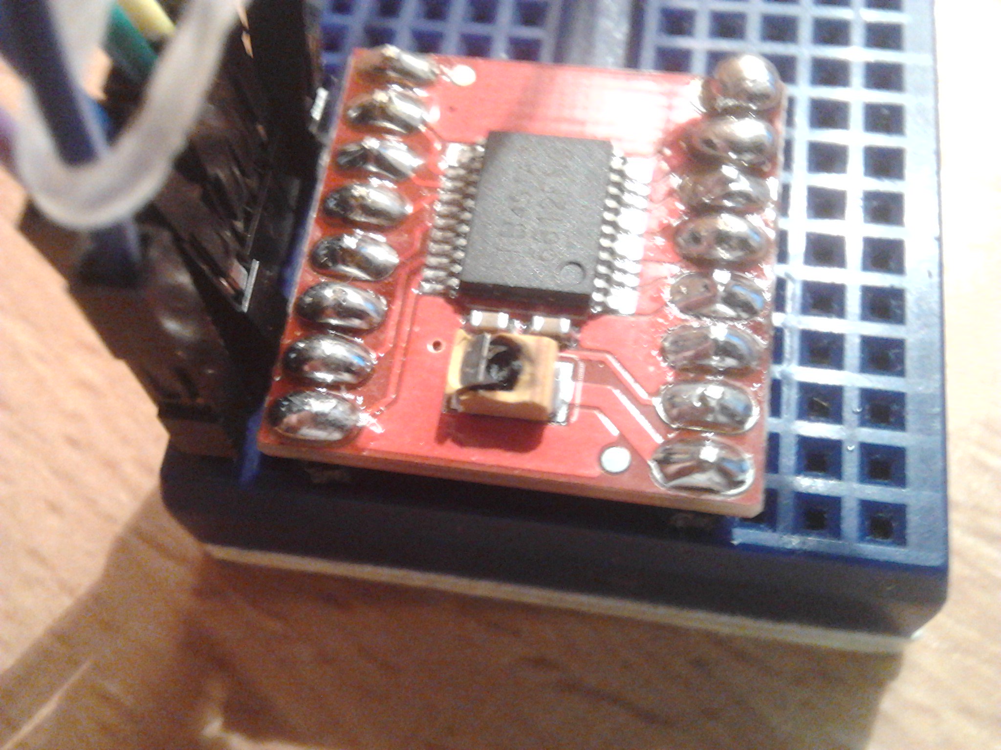

Reason is that I lost a TB6612FNG motor driver by an explosion today, and sadly the connected Arduino Due as well:
Before loosing the next Due [I still have 2 ;-)] I will give the Mega with L293D motor driver a try.

I worked on connecting the IR distance sensors vertically. I had to add a new fastening system to Arduebot:
This is the result:
Next step is to use Arduino playground PID library with 2 IR distance sensor inputs and two motor outputs. This should allow to determine maximal linear speed by Arduebot driving in eg. 20cm distance to long (25/40m) dentless walls in IBM Böblingen lab basement.
In previous posting I described that I had to wait some minutes of Arduebot full speed rotation ending due to out of power after Wifi connection loss. I did a new experiment in Motor Test Station (MTS) this time to determine how long exactly Arduebot can drive based on 3 fully loaded LiPos:
https://www.youtube.com/watch?v=lfOviMcx18k
Arduebot started with 3 fully loaded 25C(40C max) 160mAh LiPos (12.45V). It did move 0:08-3:48min = 3:40min until stopped out of power with <6V. TB6612FNG motor controller was not even warm. Although not driving anymore the power was just enough to see that both distance sensors sender LEDs are still lit a bit:
Use a little hot glue, strong but easy to remove.
Both motors got very, very hot at the end, I would expect to have lost motor(s) if having used hot glue instead of superglue for connecting the motors to peg board.
Hermann.

I measured some strange values with Sharp IR distance sensor and Arduino Due.
A colleague told me to measure with voltmeter, and that is what I did today:
I did two measurements with only getting power supply from Arduino Due's 5V and 3.3V while Due was USB powered. I compared this with the distance/voltage data from Sharp datasheet:
http://cdn-reichelt.de/documents/datenblatt/B400/DS_GP2D120XJ00F_SS.pdf#page=9
These are the resulting curves:
Good that I measured the voltage arriving at sensor as well, was only 4.03V/3.01V when connected to 5V/3.3V from Due.
Sensor VCC will definitely be connected to 5V pin, and hopefully that will provide more voltage when Due Vin is powered by 3 LiPos with >12V. Datasheet shows that there is no risk for Due pin since Sharp sensor returns 3.1V maximally.
My plan was to let Arduebot run full speed along a dentless wall with 15cm distance. Looking at 4.03V measurements 4cm/15cm/30cm gives 1.9V/0.72V/0.42V. The voltage difference wall side 1.18V is much bigger than the other side 0.3V. Perhaps Arduebot needs to run closer to the wall ... it all depends on how smoth the PID controller will make Arduebot run at constant distance to the wall.
I will start learning PID with a simpler setup, just connecting A11 to DAC1:
http://forum.arduino.cc/index.php?topic=178453.msg2646129#msg2646129
Here measured input with be "analogRead(A11)", and output will be "digitalWrite(DAC1, _)". Will be interesting how PID will adapt to the different resolutions (10bit/12bit).
Btw, 10 new black tires have arrived (for 0.25€, 1.15€ in total with shipping):
Hermann.
