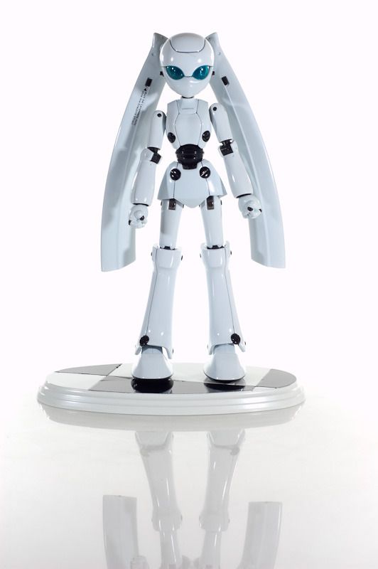

The design I chose is a humanoid robot called Drossel from some small Disney short films.
Reference Photo of a drossel figure.
