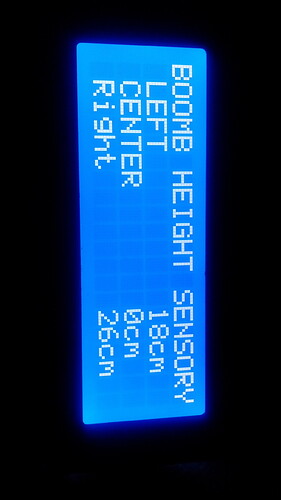

hi working on project for friend, it's for 36 meter wide boom sprayer
i got this basic coding working and running fine
cant work out how to add 2 more sensors, to have 3 total
tying get it display like this on screen and if one go pass +-25cm it add warning to that one line and keep distance there, once just got it working guess need add oms for long wiring loom.
eg... screen
01 Boom leveling
02 Left Side 50CM
03 Center 50CM
04 Right Side 50CM
i hope you guys can help me, i try do alot of googling but find no code works or do what i want
cheers

Hello,
You should try to use the NewPing library, it was made for the HC-SR04 and it is pretty simple to use, also it comes with an example of how to read a lot of sensors at the same time. If you got any new problems just post here. =D

hey thanks for help, took abit i worked out how to get lcd to working in 15 sensors pings
and modify the file for 3 sensors.
all 3 sensors are working in serial mode AS 0,1,2
but on LCD screen i can only get sensor no: 2 showing only
not sure how to define witch sensor to it's own line
cheers

Hello, I modified some stuff in "void OneSensorCycle()" and Im not sure, but it should be something like:
void oneSensorCycle() { // Sensor ping cycle complete, do something with the results.
  // The following code would be replaced with your code that does something with the ping results.
  for (uint8_t i = 0; i < SONAR_NUM; i++) {
    if (i==0) {
      lcd.clear();
    Serial.print(i);
    Serial.print("=");
    Serial.print(cm[i]);
    Serial.print("cm ");
    lcd.setCursor(4,0);
    lcd.print("BOOMB HEIGHT");
    lcd.setCursor(0,1+i);
    lcd.print(i);
    lcd.print("=");
    lcd.print(cm [i]);
    lcd.print("cm");
  Serial.println();
On your code you were only seeing the readings of sensor 2 because it was the last sensor, so you were overwriting all previous readings. You should use "i" to change the lines otherwise you are writing a value in all lines... Also, I put an if there, so you know that when "i" is equal to 0, it is time to update the lcd, and only then you have to clear the lcd...
Any questions, just ask =D
cheers for help, modified code work good, now i know how it works i made some changes to it.
