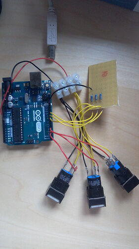

I am actually working on a video switcher project, in which LED pushswitches are needed. I am desperately trying to control them via an Arduino UNO, but none of my trials seem to work properly. After doing some research on the Internet, I wired up this simple circuit, with some code.
What I am trying to do is just to get a reading from each button's state, and have it light up when it is pushed. What it actually does : lights up everything and stays like this no matter what I do.
Can somebody please help me ?
I join pictures of my circuit, and a small schematic (disclaimer : I am just a hobbyist !)

Please attach the schematic. The picture is difficult to follow.
Also:
 if (digitalRead(SW1 == HIGH)) {
should be:
 if (digitalRead(SW1) == HIGH) {
And:
  else if (digitalRead(SW1 == LOW)) {
can simply be:
  else {
because if the input pin is not HIGH, it must be LOW, there is no need to check.
But you could simply write:
digitalWrite(LED1, digitalRead(SW1));
