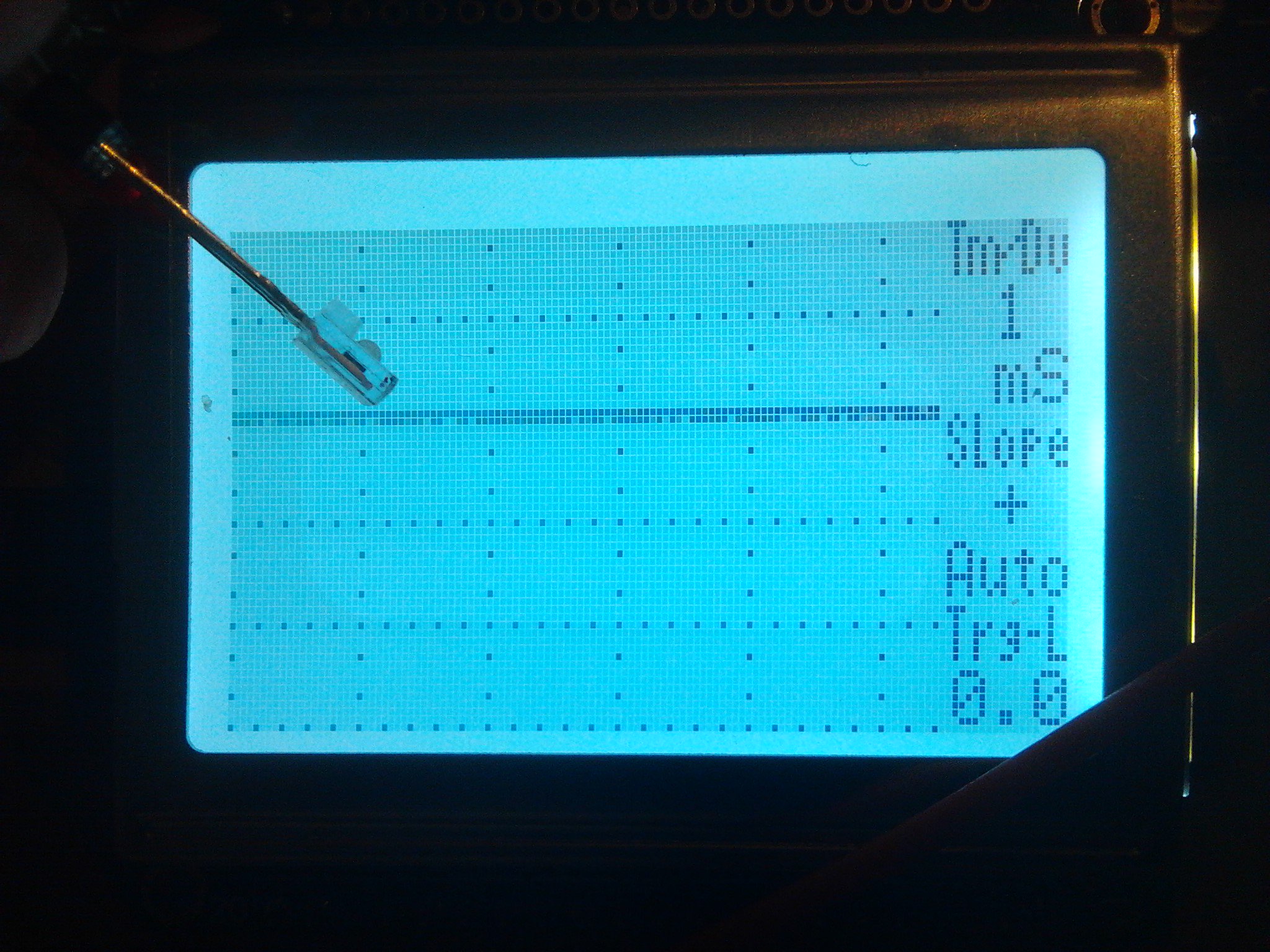

There is a "delayMicroseconds()" function that works.
This little sketch delays pin flipping by 500000μs=0.5s several times:
Code: [Select]
  pinMode(7,OUTPUT);
  digitalWrite(7,HIGH);
  delayMicroseconds(500000);
  digitalWrite(7,LOW);
void loop() {}
Oscilloscope confirms that "delayMicroSceonds()" does the right thing:
