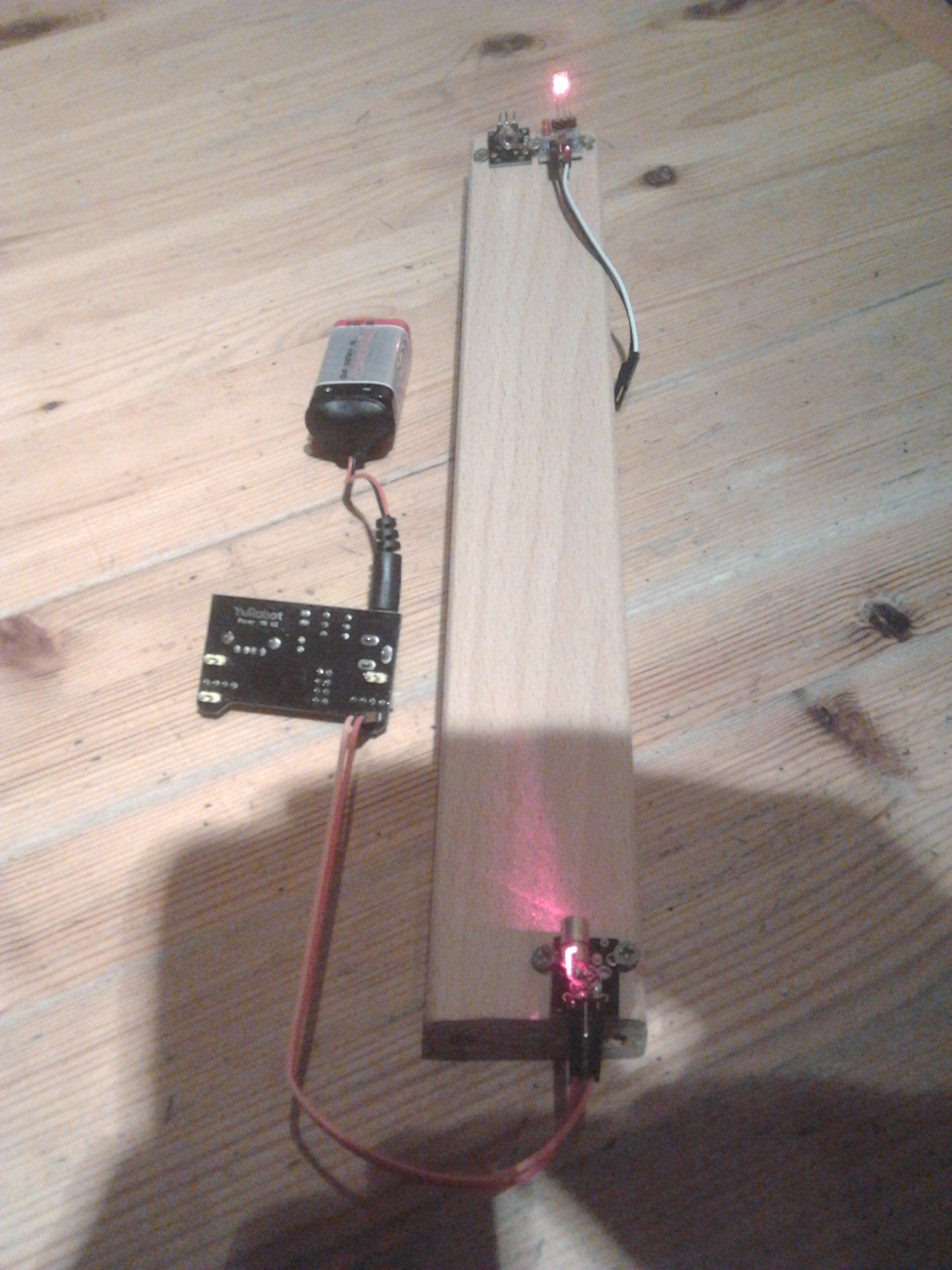

I have created a small laser transmitter and sensor testbed to measure the effect of real laser instead of setting a pin to HIGH on the Due:
Last let me say that I have not investigated DMA SPI with 42MHz yet, the 2 clock cycle resolution of measurements for a single bit sound promising.
What I found is a very simple method to record all 32 bits of port b every 3 clock cycles, but only 6 times in total. While 6 timestamps that can be taken does not sound much, the timeframe of (6-1)*3*11.9ns=178.5ns should be more than enough for measuring speed of light at home, because light travels 54m(!) in that time.

HermannSW
Thanks for that sketch, I was able to see 1003 sometimes, but when I commented out the noInterrupts()/interrupts() it increased to 1007 and did not go down to 1000. But reducing "4+1" to "3+1" wait states is really dangerous. Most time your sketch did output nothing but did hang, pressing Reset button did not get it to work. So I "buy" the noInterrupts(), but not the wait state reduction.
I played with the laser testbed shown above. I was able to capture the falling edge (I turned laser on and immediately off) after 34μs plus some clock cycles several times. That really surprised me because I did not expect such a precise reproducability because of the "delayMicroseconds(34)" statements.
Now I worked on capturing the rising edge, that happens 62(87) clock cycles @192(84) MHz CPU clock after laser pin gets set high and low in next statement [btw, I had to add a L9110S motor controller to the game, it allows the 3.3V Due to drive 5V laser transmitter I have. I already ordered new module less 3.3V laser transmitters]. With sketch attached and shown at bottom of this posting I was able to reliably capture the rising edge. And I did so with 192MHz overclocking, and I can capture 8 port B values with 3 clock cycles delta times. So the time from one of the 8 port values per line to the next is only (1000/192)*3 = 15..6ns, just a little bit more than a "normal" (84MHz) Arduino Due clock cycle.  Light only travels 4.73m in that time -- that is good for my 2*9=18m measuring distance in kitchen+living room. "FD..." has pin 2 (B.27) low, "FF..." has that pin high:
Code: [Select]
FDFFFFFF FDFFFFFF FFFFFFFF FFFFFFFF FFFFFFFF FFFFFFFF FFFFFFFF FFFFFFFF 87 30
FDFFFFFF FDFFFFFF FDFFFFFF FFFFFFFF FFFFFFFF FFFFFFFF FFFFFFFF FFFFFFFF 87 30
The whole measurement is repeated in loop(), with 192MHz for measurements and 84MHz for serial output. The different number of NOPs needed to adjust to the rising edge of laser sensor is prove that the clocking really changes. Lines 7 and 13 show that sometimes the rising edge is detected one measurement later. But overall a very precise and reproducible measurement.
One fact I find interesting is that although the laser is turned on and immediatly off few clock cycles later, the laser pulse gets emitted for 34μs as the falling edge mentioned above shows. Seems to be the laser transmitter itself, or the L9110S.
While I did the first experiments in a darkened, but still lit room, I worked today in complete darkness (only laptop screen and keybord lit, both not in direction of laser sensor). This seems to be the reason for the reproducability of the experiment although laser pulse lasts only 34μs (light travels 10.3km in that time).
Here is the current sketch with 15.6ns timing resolution port captures:

HermannSW
Not completely done, did make some progress and walked some dead ends (Intel).
I built a new compact Measure Speed of Light setup from the parts of the original Ikea Ivar experiment at top of this thread:
I placed a mirror just in front and made the sensor from last experiment mentioned above lit. What really surprised me is that although new setup/new laser sensor​s/new laser transmitter/another Due the unchanged sketch hits rising edge!
This was first time capturing of both laser sensors rising edge with similar distance mirror​s (F9…➫FD… FD…➫FF…). There are 4-5 FDs, but should be 0 or 1:

HermannSW
The timing of the measurements is really precise, I did show that before.
This is the repeated pattern from today's measurement:
Code: [Select]
FDFFFFFF FDFFFFFF FDFFFFFF FDFFFFFF FFFFFFFF FFFFFFFF FFFFFFFF FFFFFFFF 84 30
The border floated a bit, and I knew that it is dependent on light (therefore I do the measurements in near darkness normally). Today I changed the cabling in order to connect my 100MSps logic analyzer and that affected the timings as well:
This is how the logic analyzer sees the experiment, channel 0 is the signal sent to laser diode, channel 1 the signal received from the laser sensor:
I did use the Saleae Logic software export function the first time, I captured 6 seconds and since the sketch repeated the experiment every second the data reflects that:

Only the 1st and 6th show a difference of 1040ns (or 1.04μs), the others show 1050ns difference (100MSps resolution is 10ns).
t2=SysTick->VAL is 84+30=114 clock ticks after turning the laser diode signal off, so the rising edge of channel 1 in logic analyzer is somewhere between 84+4*3=96 and 114-4*3=102 clock ticks.
Hmmm, 1050*84/1000=88.2 and 1040*84/1000=87.36, which indicates 88 clock ticks between falling edge of channel 0 and rising edge of channel 1 ...
