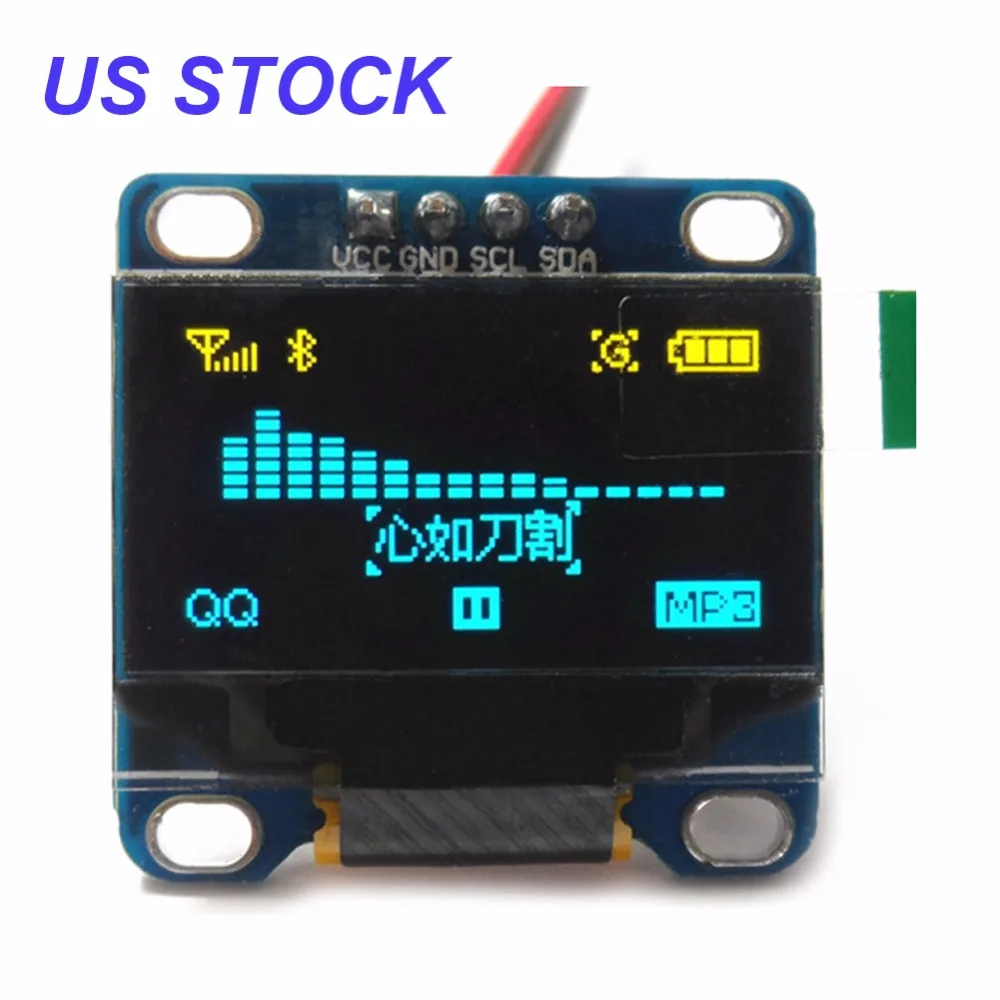

I've attached my Fritzing code.
Schematic is here.
I couldn't find an LCD in Fritzing that matched the one I use.
Here is the LCD that I use in my setup.
The succinct explanation of how my setup works is as follows:
Panel provides unregulated power to buck converter (Deswadj3)
Buck converter outputs 8v regulated power with 3amps of usable current.
Arduino receives 8v DC in.
Same 8v supply is provided to servos.
Servos move according to light input on LDR.
The pan servo is the only one currently hooked up in my circuit.(Only one that does any work via signal volt)
Tilt servo comes later after I find out how to get the pan servo working...
The problem:
The moment I've put my solar tracker into the sun, my arduino powers on and because of the LDRs it realizes an imbalance in its orientation and attempts to re-orient itself. All good so far, until the servo receives it's 2.5 or 5.0 signal voltage. The moment the servo gets that, it draws power to make an attempted left or right pan swing movement. At that moment, I run into my arduino locking up. The screen doesn't dim nor does the system power down at all. The LCD output essentially just freezes and nothing on it responds anymore. If I unplug the signal voltage after a freeze has occurred, the problem does not resolve on its own. The only way to resolve is to disconnect all power and reconnect.
I've read around about load power might be causing the issue or voltage drop when load is applied. I'm a hobbyist who is self-teaching electronics and engineering through trial and error. I've encountered my first issue that I can't logically find my way around at this time. I've got myself a multimeter as my only piece of testing equipment so I often use it to half split my way through a circuit to locate problems, but am unable to find my problem thus far.
Here are 4 photos of my project built thus far. If any more photos of specific areas of my circuit are useful or necessary, please tell me and I will get clearer photos of those areas.
Thank you for anyone who has read this far.
