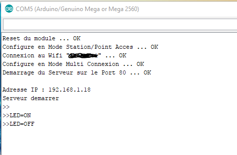

    dbgSerial.begin(9600); // starts serial link to monitor
    espSerial.begin(9600); // starts serial link to ESP
    dbgSerial.print("Reset du module ... ");
    dbgSerial.println(sendData("AT+RST\r\n",5000));
    dbgSerial.print("Configure en Mode Station/Point Acces ... ");
    dbgSerial.println(sendData("AT+CWMODE=1\r\n",2000));
    dbgSerial.print("Connexion au Wifi \""+SSIDWifi+"\" ... ");
    dbgSerial.println(sendData("AT+CWJAP=\""+SSIDWifi+"\",\""+PasswordWifi+"\"\r\n",10000));
    dbgSerial.print("Configure en Mode Multi Connexion ... ");
    dbgSerial.println(sendData("AT+CIPMUX=1\r\n",2000));
    dbgSerial.print("Demarrage du Serveur sur le Port "+String(PortServer)+" ... ");
    dbgSerial.println(sendData("AT+CIPSERVER=1,"+String(PortServer)+"\r\n",2000));
    sendData("AT+CIFSR\r\n",2000); // recupere l'Adresse IP
    dbgSerial.println();
    dbgSerial.println("Adresse IP : "+AdresseIP);
    dbgSerial.println("Serveur demarrer");

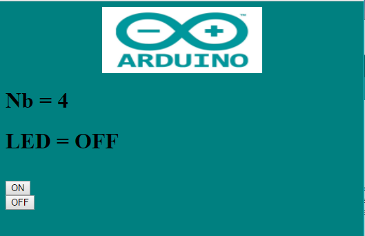

* FUNCTION : void homepage(int id)
* PURPOSE : send a web page and close connection
    String Content; // this is my HTML form
    Content =  "<HTML>";
    Content += "<HEAD><TITLE>Arduino + ESP8266 Webserver</TITLE>";
//    Content += "<meta http-equiv=\"refresh\" content=\"30\">";
    Content += "</HEAD>";
    Content += "<BODY bgcolor=\"#008080\">";
    Content += "<p align=\"center\">";
    Content += "<img border=\"0\" src=\"http://tpsecret.free.fr/Arduino/Logo.jpg\" width=\"232\" height=\"96\" align=\"middle\">";
    Content += "</p>";
    Content += "<H1>Nb = ";
    Content += String(nb);
    Content += "</H1>";
    Content += "<H1>LED = ";
    if(ledValue == 0) Content += "OFF";
    else Content += "ON";
    Content += "</H1><BR><FORM name=\"LED Form\" action=\"/\" method=get>";
    Content += "<input type=\"submit\" name=\"LED\" value=\"ON\"><BR>";
    Content += "<input type=\"submit\" name=\"LED\" value=\"OFF\">";
    Content += "</FORM></BODY></HTML>";

Ca c'est le "Debug", on voit ce qui ce passe  :o
La page Web du serveur, simple mais efficace.
"Nb" c'est le nombre de fois ou la page a été afficher.
