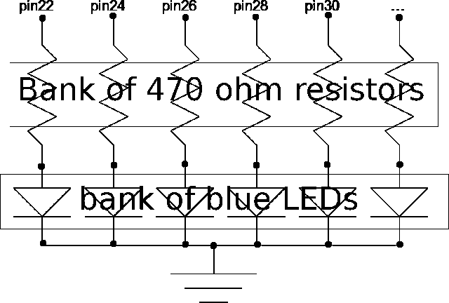

I've tweaked the emf meter sketch found here:
adapting the blogger's circuit diagram:
using the below sketch on the Arduino UNO:
  Hertz based electric field meter for Arduino.
  Free and Open Source Apache License release.
  Apache license is free and open source and simply requires notification
  to the author before derrivitive work.  adamoutler at hotmail dotcom.
  Based on a sketch found here:
  http://www.hyundaiaftermarket.org/forum/index.php?/blog/3/entry-26-arduino-emf-meter/
  and circuit diagram here:
  http://i236.photobucket.com/albums/ff111/DrivingTibNaked/leds.gif

Everything works as expected. Woohoo!
I noticed an odd thing when I first tried this int LEDPin[]={ 11, 10, 9, 8, 7, 6, 5, 4, 3, 2 } ;for my pins. Pin 10 would light up at the same time as pin 2. I cannot say why, so that was the main reason why pin 10 became my choice for the antenna. Also, I chose pin 10 for the antenna because Pins, 13 and 0 didn't seen to work well for this. I didn't try pin 1. Pins 12 and 11 Use blue LED's. Pins 9 and 8 are green. 7 and 6 are yellow. 5 and 4 are orange. 3 and 2 are red.
Dumb Noob Questions:
  1. Why would pin 10 light up at the same time as pin 2 when used as shown in the one-line code LEDPin[] array as above, and why in general do some of the digital pins not work as expected? For instance, I couldn't get pin 13 to act as an antenna, but it's fine as an LED.
  2. I tried two different size antennae (3" and 6") but could distinguish little difference in sensitivity. What is a good antenna length for sensing something at about 60Hz? Why aren't we using an analog-in for the antenna?
  3. I notice that I had to isolate the UNO from the AC power supply when connecting the UNO via USB to the computer in order to get a valid reading. But when I put my hands near the antenna (within six inches), I get a high reading. It doesn't make sense that the human body should be cycling at 60 Hz. What's really happening?
  4. It looks like the fluctuation matches my heart beat, but I'm guessing this is really the oscillation the original blogger noted about in the sketch. Correct?
  5. I've used 220 Ohm resistors instead of the 440. Might this affect sensitivity? I'm guessing not. But if so, how?
Cheers.
Pin13 as the built-in led instaled and a current limiting resistor in that led, so that makes pin13 a little bit different from the others, also digital pins0 and 1 also have resistors connected and its also connected to the FTDI chip, so it afects the pin, because they have a much more bigger load on then that sort of makes all those pin more immune to EMF
