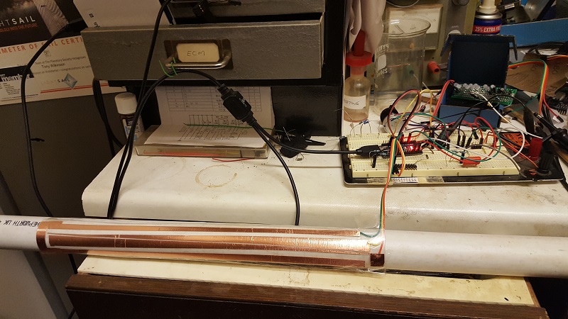

The real news is on a bit of an improvement - this is what I built:
The sensing strip is cut from copper foil tape, the central diagonal cut strips are about 10mm down to 1mm wide and about 300mm long, spaced by about 1mm. Around the outside is another strip roughly 5mm wide and spaced 3mm from the ones in the middle. Here's a closer view of each end:
(if the images don't appear inline, they are attached)
The foil was laid on some thin plastic sheet (maybe mylar, about 0.2mm thick), wires soldered on and then covered with a layer of clear packing tape. I've taped it to a length of PVC pipe (about 30mm dia.)
The idea is to drive the outer strip so there is something to couple to the inner strips.

Surprisingly it seems to work !  However, you have to grip the tube for it to register well.
I may play with this some more and see if I can get anything out of a longer 'sensor'. It may help to have the 'driving strip' all the way around the tube so there's more area to couple into your hand.
Even this quick'n'nasty test piece lays nice and flat, so putting it around the outside of the tube and painting it may work.

TonyWilk
Well...  :o
I apologise for pouring scorn on the idea of using a capacitive sensor earlier.
Went for gold this time, made an 800mm long version. This time using full width 'Slug Tape' (23mm) cut diagonally and applied directly to my bit of PVC pipe, then added the 'driving' strips around the rest of the tube. Works surprisingly well.
There is a bit of a knack to getting repeatable readings tho', the best being when your fingers wrap around the tube to equally cover the sensing strips. The worst is when you only cover one of the sense strips - I was wondering why it'd suddenly 'gone all funny' when I realised I had my extended thumb and palm over only one strip.
I didn't modify the code I posted earlier... (but there is a bug: the Calibrate bit only works the first time, thereafter it's using already-calibrated values.)
see attached pic.
