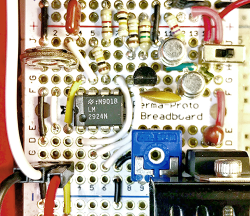

I am building an oscillating circuit that is coupled to an amplifying transistor through a capacitor. The circuit averages about 1 MHz, so I want to use a "fast" capacitor. So far my knowledge of capacitor parameters has been limited to their capacitance, and the voltage they can withstand. I have read of capacitor "speed", but know little about it. I understand that a cap's speed is determined by it's capacitance and construction.
The portion of my circuit surrounding the capacitor looks like like the drawing below. The oscillator is on the left, and the transistor on the right is an amplifier. The capacitor in question is in the middle of the drawing, and is identified by C:
The four capacitors I have on hand that meet the capacitance and voltage specifications are these:
Can anyone tell me what kind of capacitors these are, and what is the relative "speed" of those types?
Thank you!
Chris

Without seeing specs it is difficult to say which ones are which with confidence:
Left most is probably polystyrene
Next is probably ceramic
Third is probably a film capacitor but can't be sure.
Fourth probably ceramic, maybe stacked.
All real caps have errors and this error is usually referred to as tan, or how strictly the capacitor under test holds to 90 degrees phase shift. The errors in tan are caused by internal resistances or ESR and inductances.
Basically, the polystyrene and film caps will be better, but they are much bigger than ceramics and electrolytic types.

For this problem you need to consider what that capacitor is doing. Basically it is a coupling capacitor that is it is transferring a signal.
Each type of capacitor has a different inductance and loss. The inductance determines what it stops being a capacitor and acts more like an inductor. The loss, as the name implies, determines the amount of signal it absorbs.
This will explain the differences https://en.wikipedia.org/wiki/Capacitor_types

Any of those (that davetcc is probably correct in identifying) will work just fine, you will not be able to tell the difference between them.
However, at higher frequencies (say, 100MHz) the type and construction of a capacitor becomes a lot more important. Any capacitor is not a pure capacitance, it also has inductance which gives rise to a changing impedance with frequency.
You could say "a capacitor with a relatively high inductance would not work well at higher speeds"
but an engineer would not say that, instead they'd say "such a capacitor would not work well at higher frequencies".
For larger values of capacitor (commonly >10uf), the non-ideal nature is often measured as  ESR (equivalent series resistance) which is very, very roughly the 'speed' at which the capacitor can charge and discharge (to smooth a power supply for example).
So, as well as nominal capacitance and voltage rating, a capacitor may have ESR and/or impedance specified - not just single values, but graphed against frequency.
You might need an "RF capacitor" or a "Low-ESR capacitor", but not a "high speed" one.

1MHz is a relatively low frequency, pretty much any type of capacitor will work as a coupling or decoupling capacitor I suspect.
The key spec is the self-resonant frequency of the capacitor, some datasheets show this (though note that
layout can affect this frequency significantly).

Differentially measure the drop across the coupling capacitor.
If significant, try a different value and/or type.

The left most device is a hermetic something or the other, probably a tantalum. That would be the most long term stable cap you have due to its packaging.
Just like resistors, capacitors have a temperature coefficient, the TCC. Some parts have the tempco as part of their marking, the ceramic disc shows Z5U which means it has a usable temperature range of +10 to +85 C with a tempco of +22,-56% change over that range. Not exactly precision devices but good enough for HF interstage coupling and bypassing.

Davetcc, thanks for such a direct answer. I will be using capacitor b.
Grumpy_Mike, I read the wiki article, but it didn't give specific information on the appearance of the various capacitors. However on re-reading after your post, I confirmed that b is indeed a ceramic capacitor - it looks like ceramic! (especially with that chip in the disc... :P )
TonyWilk, I know I saw this capacitor referred to as "fast" somewhere, but I  cannot find it now. I stand corrected, and will no longer refer to the "speed" of the capacitor. The term capacitive reactance (per dougp) seems to describe the property I am thinking of, however as stated by MarkT, my paltry 1MHz does not challenge any modern capacitor.

Here is the completed circuit (an instance of Aaron Logue's tunneling noise white noise oscillator.) as you can see, I used the disc-shaped, ceramic cap:
