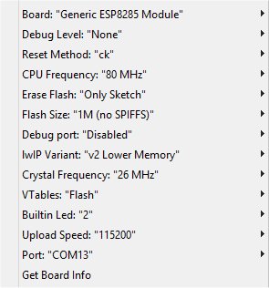

I am trying to upload a SIMPLE Blink sketch and I can NOT make the LED Blink.
On the board there are TWO LEDs - One is ON and the other marked "L" - this one I want to be able to Blink - And I can't. :(
I have tried to upload a simple Blink sketch defining the GPIO for the led as well - with no luck. Added:
Code: [Select]
#define LED_BUILTIN 2
I am getting Errors all the time when I use the following Settings for this board on the Arduino IDE:
I am NOT able to work with the Board - I need to press the FLASH Button in order to make it work - But even after doing that I am NOT able to make the Little "L" Led Blink as I want to.

wailer
Hey,
Set the reset method from "ck" to "nodemcu" and your programmer to "USBasp" then everything should work fine.
Pin 2 is indeed the correct one for the build in LED.

MegaFan
@Aryeduino: the ESP8285 DM ESP-M2 board has the green LED labeled with 'L' connected to GPIO16 active-low.
