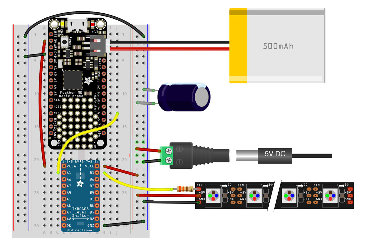

currently I am using a schema similar to this:
I have an
- ESP8266 on a wemos d1 mini lite
- logic level converter
- 220ohm resistance on the GPIO
- 1000uf 16V capacitor on the 5V line.
I noticed a strange thing though...
If I connect the power to the strip, and than connect the ESP to the PC, monitor blink black and then return the image.
Is this a signal of some malfunctioning? I don't want to burn the pc.

this is the final image of my exact circuit.
there is no short on the circuit but probably I'm sharing 5V via usb from the esp and the pc.
how can I "save my PC"?

it's incredible...
I have a power strip. on this power strip is connected the monitor, the PC and the 5V power supply I use to power my leds.
now I have the PC, the monitor, the 5V power supply connected to the power strip.
5v power supply is disconnected from the arduino project I posted in the picture in the previous post.
ESP is not connected to the PC usb.
now if I connect the 5V power supply to the 2 pin connector of my arduino project,
MONITORS BLINK :O :O :O :O
how can it be possible? it blink even if the usb is disconnected as soon as I connect the 5v power supply to the 2 pin connector :O
than if I connect the PC USB to the esp the PC monitor blinks again.
than the strip works correctly.
what can it be?

Is is safe to power LEDs from an external power supply and power the esp via pc usb to use serial communication with the microcontroller?
Is this normal or we need some protection like usb isolation?
CrossRoads
Yes, that is safe. Be sure to connect the GNDs together.
