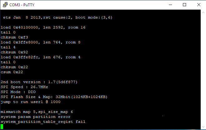

Note that I chose there --flash_size 4MB-c1 because the board is 32Mbit, and the Firmware version (v1.7.1) only includes 1024+1024, so I had to use -C1.
It seems that I did everything well,
yet when I change the switch from Program to Communication mode,
and Connect to the device, then in the Bootloader's baudrate (74880) this is what I get:
Maybe the command parameters that I used are not good like I thought?
It looks like the last 3 lines hint the problem:
"mismatch map5,spi_size_map 6"
What do I need to change in my parameters to fix it?

They recommend there changing from QIO to DIO.
I tried it:
Doesn't seem to solve the problem..

this is why I recommend the FDT.
I too was not successful with the esptool and the prebuild binaries of 1.7. there are several reports that the build is strange. the FDT corrects it somehow.

sorry, I call the AT firmware binaries from the Espressif site 'prebuild'. Originally the AT firmware is in examples of the SDK as source code for module manufacturers like for example AI Thinker. (the example is only a layer over closed source AT command library). Later Espressif started to provide binaries. The build of the firmware must know the size of the flash memory of the target to use a correct partitioning, but Flash Download Tool (FDT) can correct it.

I think the 1.7 'prebuild' binaries are for 16 Mbit flash and the esptool would flash it right with addresses for 16 Mbit flash.

and right now I got it flashed with esptool as 2MB-c1
for 4MB-c1 it prints
mismatch map 5,spi_size_map 6
system param partition error
system_partition_table_regist fail
I guess the 5 is one of the partition options. it is in the bin name. It was always so but everybody used the 512 kB version which fits in any partitioning
the FDT corrects the partitioning because it changes the bin files before flashing according to settings
Yes exactly what I got.. It's in the screenshot..

with FDT it works for 4MB-c1, because the tool modifies the bin file from map 5 to 6
