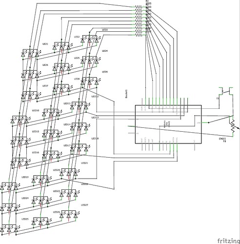

there is a build suspicion of me that are related to the build cause the resistors connected to the catodes right now im checking on that but code related my only suspicion is im an idiot :sunglasses:
sorry for the long introduction n stuff but explaining that issue kind of brings my english to it limits ^^ hope you can understand what i mean. some parts of the code are german if needed i could make a translated version if it helps you to help me :slight_smile:
thanks upfront for your time investment
well the suspicion with the resistors is half true it can cause yellow to get much darker if there is a led with red also connected means i for sure will have to rebuild the cube anyway... yeah ;D but still there has to be a code issue too... cause even if all 3 on the same catode are same color they suddenly all get mixed to orange...
Thanks for using code tags in your first post. +1 Karma.
Can we have a schematic please? Hand drawn is ok. If you want to use Fritzing, please ensure you use the schematic view not the breadboard view.
i worked with fritzing for the first time so hope this works i used rgb led here in reality its only 2 colored leds that i couldnt find in fritzing so i just didnt connect one of the colors hope the sketch is any readable
Your schematic drawing skills need improving, its quite a mess. Take some time to study the schematics you see on-line to see how they are drawn. I would suggest:
  • Keep connection lines horizontal or vertical wherever possible
  • Don't draw connection lines over the top of components
  • Use the "Vcc" and "GND" symbols as many times as you like to reduce the number of connection lines
well yeah i agree as sayed was my first time and the 3 dimensional cube made it a bit of a challange :frowning: sry but i will work on it...

only bug the color/player wount switch properly everytime after confirm selection... its a 1 out of 10 thing but i already have some idea why this could happen...
another question do you think i should share my sketch and schematic after cleaning up and translating it?
hm anyway thx already for your time taken
Yes, absolutely you should share it. It may be useful to other beginners in future and we can suggest ways to improve your circuit and code. Perhaps we can fix your button problem.

  int columnX = select1 % 3;
  int rowX = (select1 % 9) / 3;
  int layerX = select1 / 9;
  if (gamegrid[columnX][rowX][layerX] == pos_Selected)
    //it changes it value to the actual player
    if (player == true)
      gamegrid[columnX][rowX][layerX] = pos_P1;
      gamegrid[columnX][rowX][layerX] = pos_P2;
    //saves change to next player in playerState
    playerState = player; select++;
void setPotsValue()
  selectionPoti = map(analogRead(A0), 0, 1023, 0, 26);
  if (select != selectionPoti)
    select = selectionPoti;
    for (select2 = select; select2 <= 26; select2++)
      int columnX = select2 % 3;
      int rowX = (select2 % 9) / 3;
      int layerX = select2 / 9;
      if (gamegrid[columnX][rowX][layerX] == pos_X)
        select1 = select2; return;
void potsValSelect()
  //loop through all possible positions
  for (layer = 0; layer <= 2; layer++)
    for (column = 0; column <= 2; column++)
      for (row = 0; row <= 2; row++)
      { //overwrites the previous selected positions to empty again
        if (gamegrid[column][row][layer] == pos_Selected)
          gamegrid[column][row][layer] = pos_X;
  if ((winner == pos_P1) || (winner == pos_P2)) {
    return;
  gamegrid[columnX][rowX][layerX] = pos_Selected;
  // and yet another check if player state changed
//check if win conditions are met
void win()
//loop through both player colors
{ for (color = 0; color <= 1; color++)
    //and all posible positions
          //check conditions
          if
            ((gamegrid[0][row][layer] == color) && (gamegrid[1][row][layer] == color) && (gamegrid[2][row][layer] == color))
            ((gamegrid[column][0][layer] == color) && (gamegrid[column][1][layer] == color) && (gamegrid[column][2][layer] == color))
            ((gamegrid[column][row][0] == color) && (gamegrid[column][row][1] == color) && (gamegrid[column][row][2] == color))
            ((gamegrid[column][0][0] == color) && (gamegrid[column][1][1] == color) && (gamegrid[column][2][2] == color))
            ((gamegrid[column][2][0] == color) && (gamegrid[column][1][1] == color) && (gamegrid[column][0][2] == color))
            ((gamegrid[0][0][layer] == color) && (gamegrid[1][1][layer] == color) && (gamegrid[2][2][layer] == color))
            ((gamegrid[2][0][layer] == color) && (gamegrid[1][1][layer] == color) && (gamegrid[0][2][layer] == color))
            ((gamegrid[0][row][0] == color) && (gamegrid[1][row][1] == color) && (gamegrid[2][row][2] == color))
            ((gamegrid[2][row][0] == color) && (gamegrid[1][row][1] == color) && (gamegrid[0][row][2] == color))
            ((gamegrid[0][0][0] == color) && (gamegrid[1][1][1] == color) && (gamegrid[2][2][2] == color))
            ((gamegrid[2][0][0] == color) && (gamegrid[1][1][1] == color) && (gamegrid[0][2][2] == color))
            ((gamegrid[2][2][0] == color) && (gamegrid[1][1][1] == color) && (gamegrid[0][0][2] == color))
            ((gamegrid[0][2][0] == color) && (gamegrid[1][1][1] == color) && (gamegrid[2][0][2] == color))
            //if check which player met the conditions and set him to winner
            if (color == pos_P1) {
              winner = pos_P1;
            if (color == pos_P2)  {
              winner = pos_P2;
  // make all leds switch to winners color
          gamegrid[column][row][layer] = winner;
void reset() {
  //loop all positions
        //set them to empty
  //set all needed start values to default again
  firstTurn = true;
  player = true;
  playerState = 1;
  winner = 3;
  // well and thats the acutal game. ENJOY!
  firstTurnRng();
  setPotsValue();
  showGame();
  win();
  if (digitalRead(resetPin) == LOW) {
  reset();
above you see my final translated and cutted version to fit here.
there is not a single bug left i call it a finished project.
hopefuly it can be of use to someone. if there are questions im glad to help.
