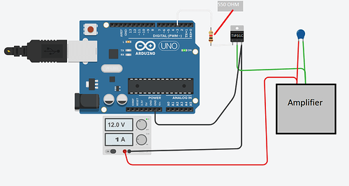

Hi i was a question about why piezo buzzers make weird sounds when used without a resistor.
My piezo buzzer doesn't have a problem. Crackling and popping like sounds.
Its not a speaker you know a normal buzzer.
Also most weird part is my buzzer weirdly louder than my laptop speaker.
I can hear buzzer sound from other rooms.

I found beacuse of poor connection .
Cable of buzzer not very conductive or cable is connected poorly or long
Of course a flakey (intermittent) connection can cause problems. But a piezo should work fine with very long wires.
