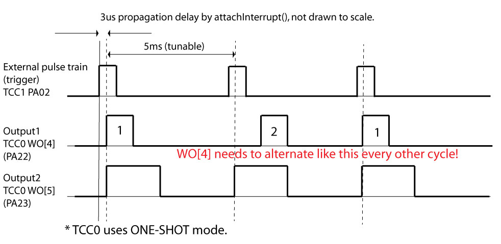

WonS
Hello Martin,
I must thank you first for your tremendous contribution to the popularization of arduino programming by helping many including me for the register-level coding which could be daunting many times.  I learned a large part of how to code bare-metal from reading your posts.
As I need some advice on TCC PWM pulse outputs, I thought this thread is relevant. After trying many different attempts without success, I finally post a question!
I read most of the relevant topics in the forum and I tried to apply them to my application using TCC ISR which worked until I needed some more features.
As in the attached image, there is an external pulse-inputs (from TCC1) that triggers synchronized output pulses with configurable widths.  There are 4 output pulses generated per external spike in ONE-SHOT mode, only 2 pulses of interest shown in the image.
The goal is to generate alternating pulses that differ in timing (or phase) in one of the two outputs (WO[4] in this case). In other words, the two diferent pulses profiles should repeat every other cycle.   My code can runs fine if there is no alternative requirement.    As turned out, this was not straight forward.
I attempted to change the count direction in TCC0_Handler with 2-stage state machine, at each state change the count direction so that single slope PWM but for unknown reason the count direction did not change as desired at every cycle.   Here is one of my attempts:

MartinL
Hi Eric,
It very much depends on the exact timing of your PWM pulses, including duty-cycle (phase), period (frequency) and resolution.
One possible technique is to decrease the timer's period into smaller time slices and reconstruct the pulses with a predetermined sequence of duty-cycles. This can be achieved using the SAMD21's DMAC, or if the PWM frequency is low, using the timer's interrupt service routine.
Another option, if the lag on output 1 isn't too large, is to use dead-time insertion, but this can only insert a small number of GCLK cycles to delay the pulse.
If you need to generate 4 pulses then it's probably easier to use the timer in continous PWM mode and switch the duty-cycle to 0% at the end of the sequence, rather than using oneshot mode.

MartinL
Hi Eric,
I've managed to produce the waveform you require.
The following code sets up port pin PA19 as an input that routes pulses through to the event system, (a 12-channel peripheral-to-peripheral highway), via the External Interrupt Controller (EIC). After a 2us progagation delay, these pulses (or events) are received by timers TCC0 and TCC1. The fact they these timers are triggered by the same event effectively synchronizes them.
Upon receiving an event both timers retrigger, TCC0 generating a 2500us pulse on channel 1 and an alternating 1250us and 2500us pulse on channel 0. The alternating pulse widths is achieved by enabling circular CC0/CCB0 buffering in the TCC0's WAVE register.
Timer TCC1 meanwhile calls its interrupt service routine. Once at the beginning of a cycle, to alternately switch on and off pattern generation and once at the end of the pulse, to turn pattern generation off.
When the pulse on channel 0 is 1250us, pattern generation is switched off for the entire cycle and the pulse is output as normal. However, when the pulse on channel 0 is 2500us, pattern generation is switched on for the first 1250us, forcing the output low. After 1250us, pattern generation is switched off allowing the pulse to return high again for its remaining 1250us.
A 5us pulse interval is generated from timer TCC2 on port pin PA16. Connecting PA16 to PA19 feeds the pulses through to timers TCC0 and TCC1.
Here's the resulting output, 5us interval pulses (yellow), alternate phase shifted pulse on TCC0 channel 0 (light blue) and standard pulse on TCC0 channel 1 (purple):
Please find the code attached:

Hi Eric
1)In the PATT register, setting the pattern generator's bit PGE4 (Pattern Generator Enable Channel 4) simply overrides the channels output, setting the output high or low depending on the value defined by the bit PGV4 (Pattern Generator Output Value Channel 4).
The TCC0 alternates cycles on channel 0, both aligned to the rising edges of the input signal. On one cycle TCC0 generates standard a 1250us pulse, on the other it generates a 2500us pulse, but the TCC1 timer actives the TCC0's pattern generator to set the first 1250us of the pulse low. This gives the output of a 1250us pulse with a phase delay.
2) I'm not seeing this behaviour on my board. If I disconnect the PA19 input both PA22 and PA23 outputs go low.
There is an issue that if the input pulses are stopped, the TCC1's ISR and the TCC0's circular buffer can get out of sync with one another.
3) Unfortunately, in this instance the DAMC won't work, as it doesn't have the same flexibility as an interrupt service routine.
The problem is that the PGE4 bit in the PATT register needs to be set every other cycle by the TCC1 overflow (OVF) and cleared by the match compare 0 (MC0). This requires two DMAC channels, one to trigger on TCC1 overflow and the other on match compare 0, however the two channels cannot simultaneously share the single destination PATT register.
