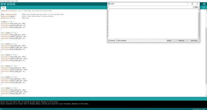

Thank you both for your feedback on this post. I really appreciate it. I am fairly new to Arduino so this is a tad challenging for me to follow. I did however come up with a new sketch using character values.
This is working for me and the RGB is changing colour although it does not work for the first 32 characters (I just read that these are non-printing characters). I was planning on just using else if for all for char values for 0 to 100. For now I just added 8 values to my sketch.
(attached two photos)

Any ideas on how I could read values 0 to 32 with my script?
Thanks again!
austinwb:
this will read any byte. 0 to 32 included - you have nothing special to do.
data = Serial.read();      //Read the incoming data and store it into variable datathey are just non printable symbols attached to those bytes in ASCII, but you could still compare themif (data == 7) {...}

Yes, when I receive any of the non printable characters (0 to 32 decimal) from my phone I cannot see them in the serial monitor. Which makes sense. But my question is how can I take those incoming non printable values and use them to change the colour of my LED. I can easily do this with the printable values as you can see in my script in my previous post. I hope I am making sense. I apologize for my lack of experience.
You can extract the numerical value, save it in a variable and use it.
