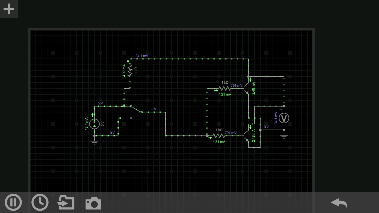

This "inverter" will not properly invert, how do you think it works?

If we simplify your inverter, you do not have either of the BJTs biased properly.

I don't se anything pulling up the TC4427 inputs.
(no pullup resistors ) so where is the voltage comin from ?
Did you measure it on the inputs ?

This is a bit weird... okay, I just ran a few simulations and am wondering how I missed this, anyways, the more you learn. The reason i 'used to think' this is an inverter circuit is because i temporarily ran my mosfet with this configuration, and the mosfet would turn on when the input was low, Being lazy, i didnt think of checking that twice, look where that got me.
I have this alternative plan of using a simple 2 npn nor gate as not gate. like this
I tested this on simulation, and works fine with both inputs tied up.
Am i missing anything? i think i might use higher value resistance, how much does resistance affect the switching speed of the transistors? should i be concerned about this?
P.S, i am using 1nF timing capacitor, which in turn gives me about 35-40 Khz of switching frequency. The transistors i have, d882, can handle up to 1Mhz. So, what effect does resistance have on switching speed?

By the way, this would explain the voltage rise, the pulse width of the ic changed but the output was inverted, for now im surprised that the faulty circuit provided any output at all!

EDIT: Its been a long day and i just realized that this is the thing i tried to avoid at first, with the pullup, anyways, ill try the simple way, with 1 transistor and see if its good or not.

I haven't seen you acknowledge thatthere's nothing pullingup the inverter outputs
kaseftamjid
I acknowledged the whole thing was wrong, including the wrong that the so called inverter i have been trying to use has no pull up
