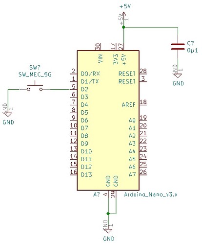

The schematic shows a single button connected to an input on an Arduino Nano. On many Arduinos digital inputs 0 and 1 are used for the serial monitor. Digital input 2 is the first free input and is used in this example.

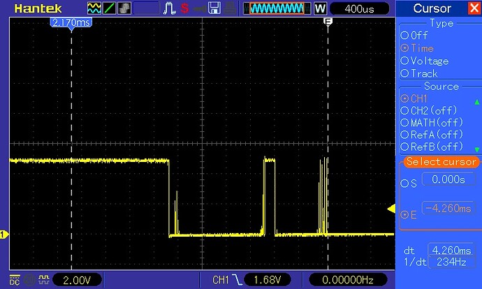

The oscilloscope trace below was taken from a single button wired as in part 1. The trace shows high and low transitions - some lasting over 4ms - before the signal settles at low. This is caused by mechanical bouncing of the button's contacts. We can use software to remove these unwanted transitions. The millis() based timer code in part 1 makes sure the bouncing has stopped before registering the button press as valid.
