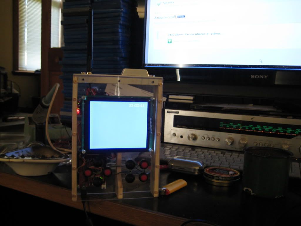

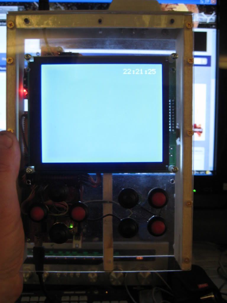

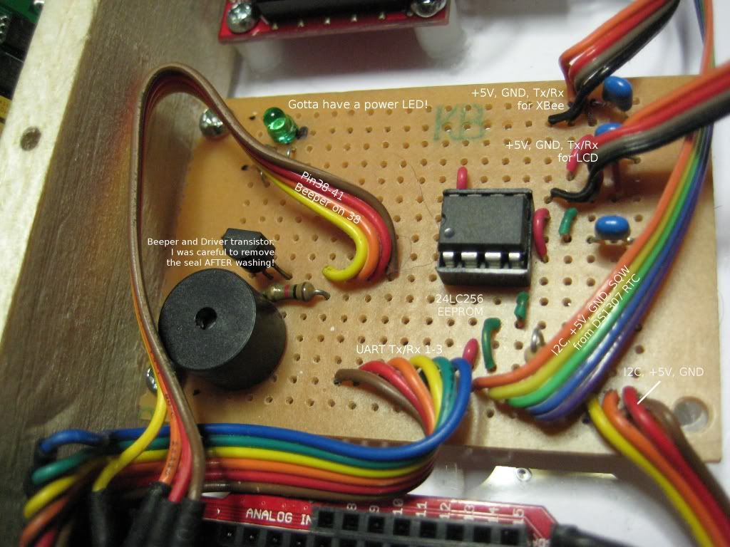

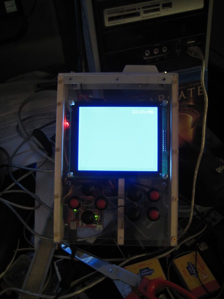

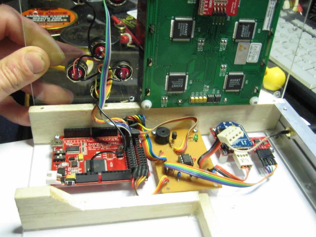

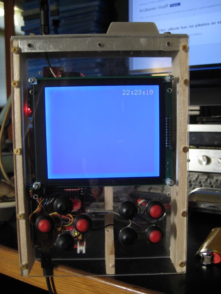

I have finally finished my Data Terminal prototype!
Still have to mount a couple of things, Digital Compass, Barometer, GPS and maybe an SD card reader and one of thos AM/FM/SW receivers.
I'm using a SeeedStudio Mega, There is a DS1307 RTC breakout, a regulated XBee Explorer with a series 1, 60mW, U.FL connector XBee module.
On the prototyping board there is a 24LC256 I2C EEPROM.

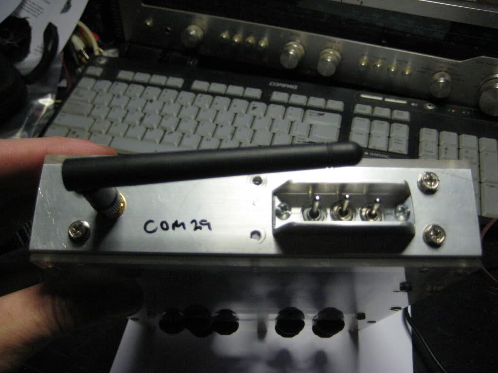

On top I have the XBee Antenna jack, with a 3dBi Omni.
The switches will be
- Master Power
- LCD Power
- GPS power, if I can find a spot to mount my EM-406 where it can see the sky.
The LCD is a SparkFun HUGE LCD with serial back pack.
It's a great display, but forget buying a civilised case! It's just too big!

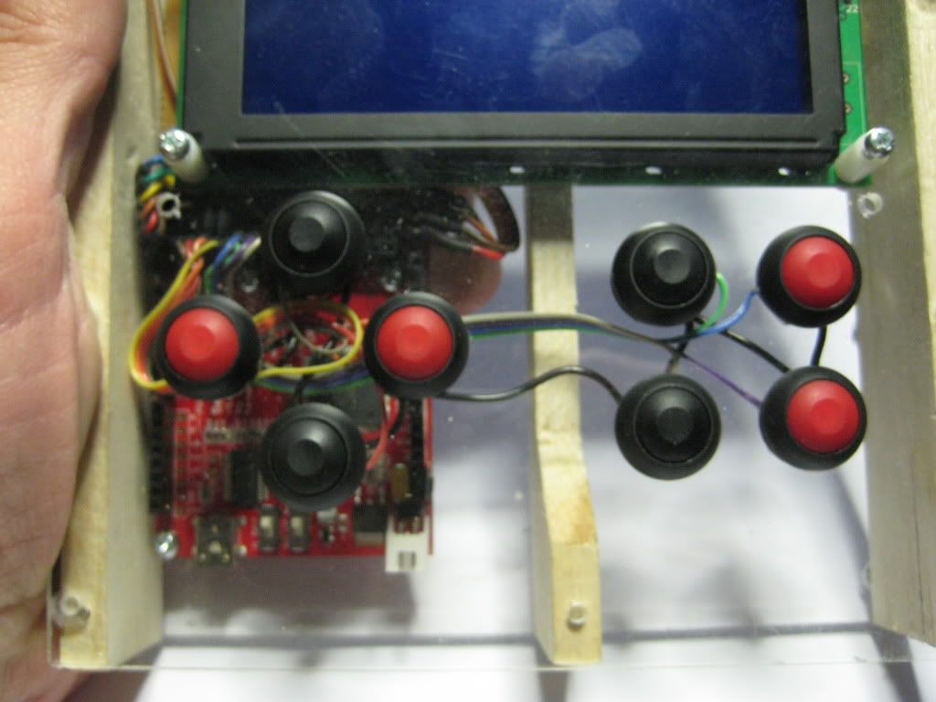

At the moment all it does is show the time and the "Up"/"Down" buttons change the LCD brightness.
The buttons are rated IP67, so they will be splash and dust proof, also tougher than the rest of the unit.

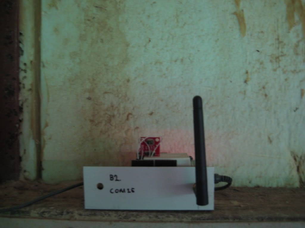

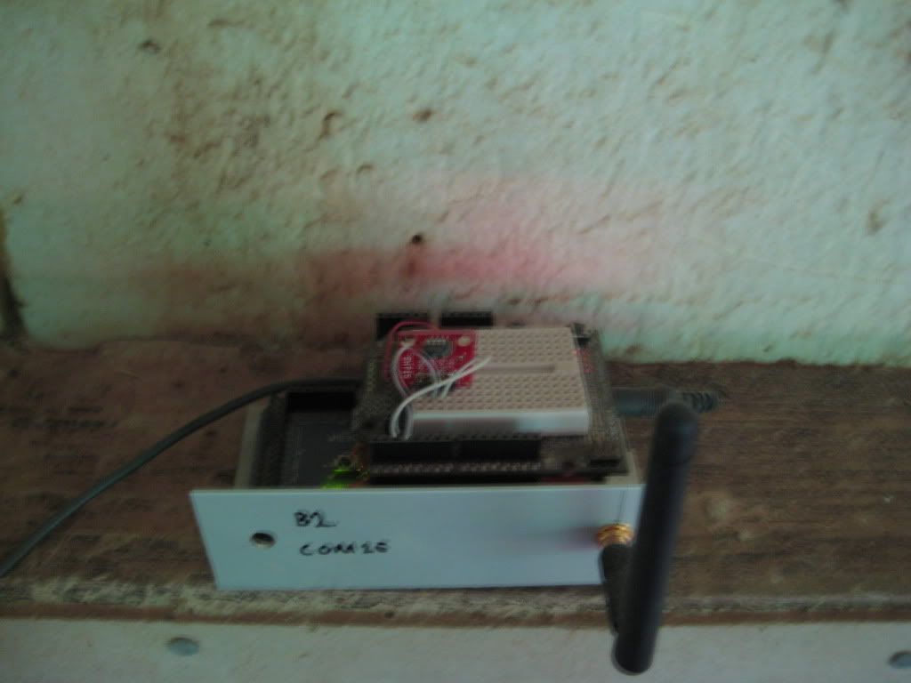

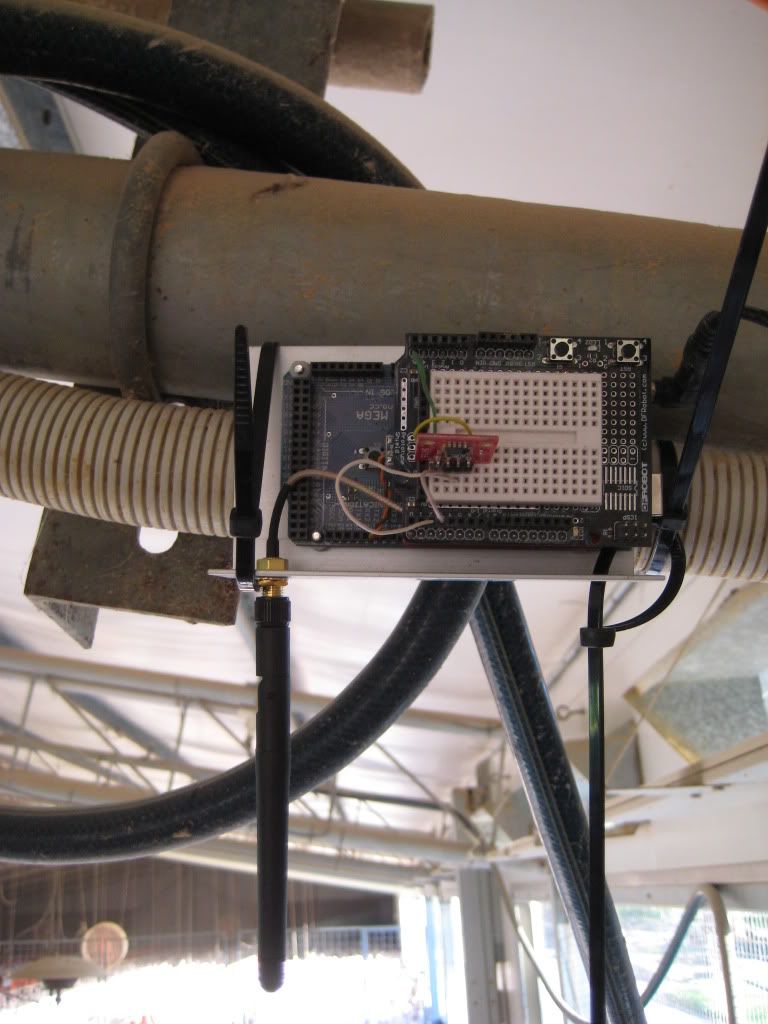

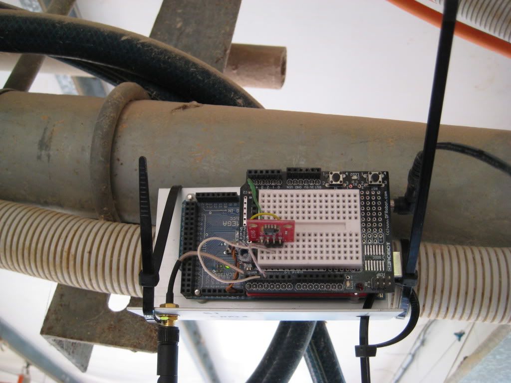

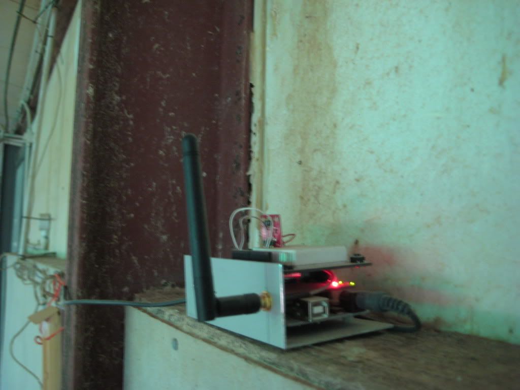

I've put together 2 of these Mega/XBee prototyping rigs.
After ripping the U.FL connector off a U.FL to RPSMA lead, I decided to put together something a tad more robust.
The 2 nodes are identical.
- Genuine Mega
- SparkFun XBee shield, I use one of the hardware ports, so I cut the link, switch to "DLINE" and run 2 leads to Serial3 in this case.
- DF Robot protoyping shield, with an SHT15 temperature and humidity sensor
The codes on the nodes look like this
Quote
#include <Sensirion.h>
const uint8_t dataPin  =  2;
const uint8_t clockPin =  3;
float temperature;
float humidity;
float dewpoint;
Sensirion tempSensor = Sensirion(dataPin, clockPin);
  //XBee UART
  Serial3.begin(9600);
  tempSensor.measure(&temperature, &humidity, &dewpoint);
  Serial3.print("Barn 1: ");  // This is the only difference, the other
                              // node prints Barn 2:
  Serial3.print("Temperature: ");
  Serial3.print(temperature);
  Serial3.print(" C, Humidity: ");
  Serial3.print(humidity);
  Serial3.print(" %, Dewpoint: ");
  Serial3.print(dewpoint);
  Serial3.println(" C");
  delay(2000);

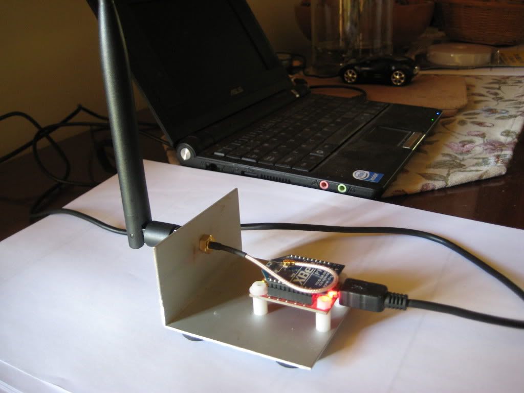

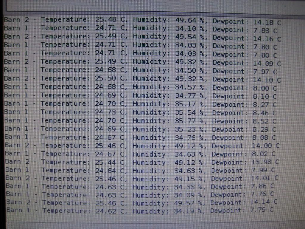

Back here in the house, I have my XBee "Base Station"
I have it hooked up to one of my ASUS eee's, a 701, running Ubuntu Netbook Remix, a variant of Hardy Heron.
(no, I didn't buy that Porche mouse! My girlfriend did! Makes a great night light!)
As you can see from the code it is just the Sensirion example printing to the XBee.
The arbitration or anti collision is being handled by the XBee's.
The couple of times Barn 2 has not shown up here is due to farm traffic, both nodes are in great big Faraday cages, 100 odd metres away.
I'll write better code, but, as an exercise in saving me extra exercise walking down to the barn's every half hour, it's great!
A friend of mine just said "Why bother?"
He is a grep, awk, sed freak and has written a bash script to log the data.
Hmmm, why didn't I think of that?
Anyway I'm thinking of "packaging" up the data like a GPS sentence.
$BARN1;Txx.xx;Hyy.yy;Dzz.zz;$END;
$BARN2;Txx.xx;Hyy.yy;Dzz.zz;$END;
I'm not sure if I need a checksum, what do you guys think?

I thought the display looked really big in the initial picturses, until your thumb showed up!
What will the  buttons do?
The message data repeats often? I wouldn't bother with checksum unless the receiver is going to ask the sender to resend if it saw a bad message come in.

The aluminium extrusion I used is the stuff they make window and door surrounds out of. I picked up a heap of different cross sections from a shop fitters off cut bin.
I went for the XBee 60mW with external antenna because I thought I would need all the signal strength I could get.
Those U.FL connectors are really fragile and messing around trying to hold up a rubber duck antenna with tape or whatever is tedious at best.
It turns out I can receive data pretty much anywhere in the valley from Barn 1, but in only a few distinct places around the farm from Barn 2.
I'm thinking it's the proximity to the corrugated iron control room wall.
The 20mm squared mesh on the barn sides seem to be pretty transparent to 2.4GHz.

@CrossRoads - The buttons on the right will be navigation for menus, list selection, stuff like that.
The other 4 will be modal, depending on which screen or menu you are in.
This was the original keypad I was going to use.
One of the data "screens"
The early days!
My first Mega, with GPS shield on top of a DF Robot Mega Prototyping shield.
The 2 shed nodes are just "free running", not synced in any way.
The data gets sent every 2 seconds.
