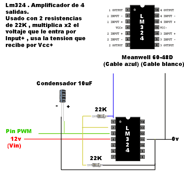

burgos
hi
Im not understand what you really want, but if you dont have an Electronic knowloge I recomend you to use power supply whit PWM included.
The image are in spanish but you can deduced
You can increase the PWM voltage range whit this IC
I can you you more option but I need to undertan better your proyect if you draw you led configuration maybe ease to help you.
you can use the IC ULN2003 to drive a led dependig how many milli amp consume.

@burgos
There is no resistor on that LED on pin 13. Pin 13 does not have an internal resistor, you are endangering your arduino.
