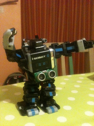

> Mammuth hardware
Instead of the arduino pro mini plugged directly on the battery block (3,3V), i only have a duemilanove and some Uno's. So let's put an arduino uno on the back and a 9V battery on the little toy (16 cm, 300g). Let's tests the balance and moves with the remote.
Result mammuth backpack -> succeed.

Mammuth coding (no intelligence) -> Succeed !
So isobot now walks forward with random funny animations, and when his ultrasound sensor feel an obstacle, he launch random moves, random fight, then goes back clockwise, and so on.  So, happy arduino atmega 328 users, you can now hack any isobot the mammuth way :-) And remember to check out the original codes and library posted in the arduino forum by the people who made the intelligent work :-)
