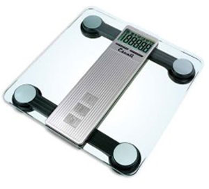

Hi guys!
I am trying to figure out how I can interact with 4 load sensors (like this http://manyyear.en.alibaba.com/product/359992876-210312211/MLC902_Micro_sensor.html. I think this might be similar to this one: http://www.sparkfun.com/products/10245
I am actually trying to hack a body weight scale which looks pretty similar to this one (see attached pic or link http://www.dietsinreview.com/diet_column/wp-content/uploads/2009/09/escali-track-and-target-scale.jpg)
I just want to use it with arduino so either just replacing the original board or trying to get the output from the original pcb to use as input to arduino will work for me. Specifically I want to output to serial from Arduino to the computer.

robtillaart
Generally there are two ways to hack such a device
1) find some meaningfull signal on the PCB, with a bit of luck such a signal can be found, might need some decode
2) reverse engineer the signals on the display, you probably need many lines to monitor, doable (with 4 shift registers you have enough lines)
Finally you need to find the signal lines that indicate [wakeup] [ready for measure] [measure done] These status lines indicates when the measurement-data makes sense.

AboMan
#6
May 04, 2013, 02:36 am Last Edit: May 04, 2013, 02:55 am by AboMan Reason: 1
Hey, I work on scales professionally and I can tell you that  when a scale has more than one load cell, we use a summing card (junction box) to connect them all. There are typically 2 types of cards like this Signal trim, and Excitation trim; the trimming is just potentiometers used to balance the voltage from either the Sig or Exc bridge so that all of the load cells dead load output is within 0.1 or 0.2 mV of each other (rule of thumb, just get it as close as you can) you can then use a single interconnect cable from your summing card to your indicator to represent the weight no matter where it is on the scale.
--Also, a scale for weighing your self like that is typically done with just one load cell anyway, usually a 'single ended beam' cell or 's' type if it has a pedestal, that is attached to a firmament and the weighing surface (with shims at the physical contact points [<-important])
--Lastly, if its possible to check most load cells come with a rating like "3mV/V" etc.. the technical specification that comes with the SPECIFIC load cell usually is a bit more accurate it will say something like "3.23mV/V" or "2.98mV/V" (2.9-3.3,a consistency and closeness to 3mV in this rating cell to cell (if you have a bunch to compare) is a good quality indication of the manufacturers process) --Anyway-- so long as that value for all four are within that 0.1-0.2mV range you don't need anything more than a terminal strip to sum the cell outputs accurately--though it may be tricky getting a decent calibration if these values are too far apart, If they aren't close enough you'll have repeatability issues with your weighments and depending on the extent, a tough time getting a stable count for calibration.
RandomDudeAround
I'm sorry to revive such old topic. Currently I'm working on similar project.
After connecting the load cells to the junction box, does it act like a single load cell? and can I connect the output of junction box to HX711 and connect it to Arduino just like a regular load cell?
Thank you
